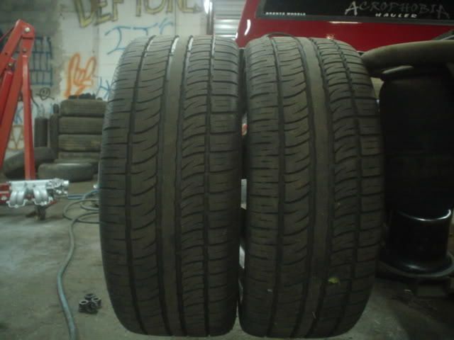

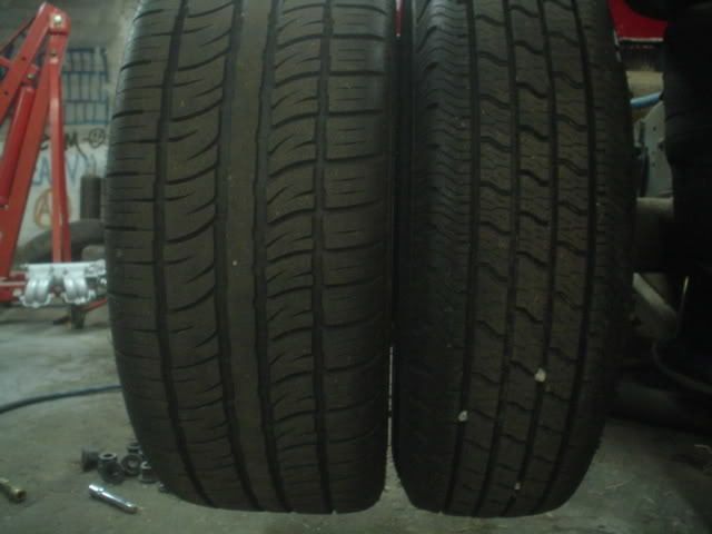

Aight here are the wheels that Im running on mine.
Right now Im running the factory 16" on the inside
But later I am gonna add the inside 22"s

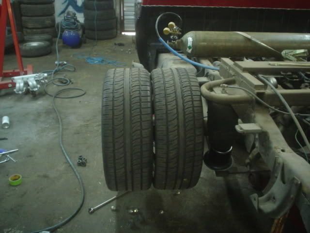

Here is the overall width compared to the truck

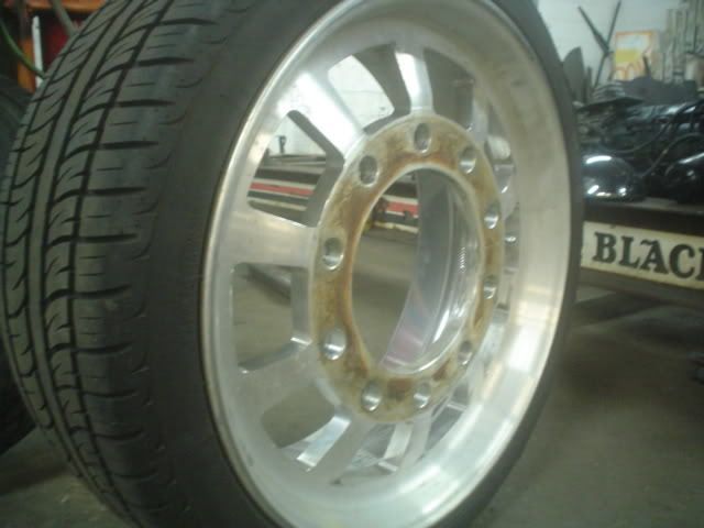

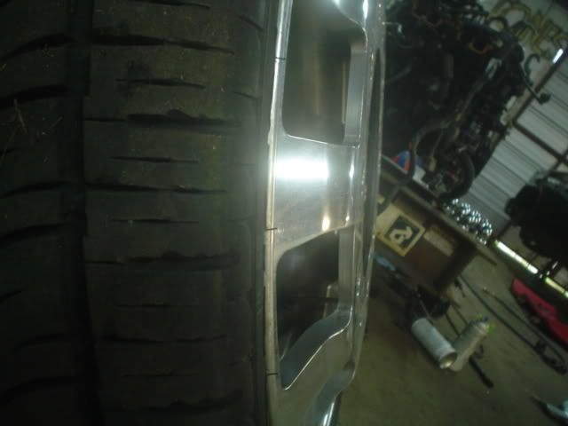

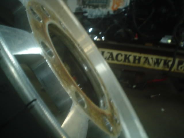

ANd here are the wheels with their mods

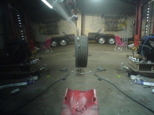

holy sweetness bat man and i like the pic of the installser dont install boltons hahah custom = cut some

u got the special offset ones on the front also are just the bac?
dragnasty's avatar
dragnasty
just the back....the fronts just have 1/2" milled off the face to help tuck the lugnutz....

i like the design u cut in the wheels ................

so if I ran two of the dragnasty offset wheels on the back I wouldn't have to nerrow my rear end? is that what I'm under standing?
lester622
so ya if u ran these wheels on a newer dually u wouldnt have to narrow the rearend are u still would?
dragnasty's avatar
dragnasty
You shouldnt have to narrow the rearend but Im not sure. These wheels are ran on the outside only. Thats a standard wheel on the inside. Im gonna have to so some small milling on the face of the inside wheel to get another 1/4" out of it. You may have a small clearence issue but it will only be like a 1/4" or so. Alot better than 2 1/2"
