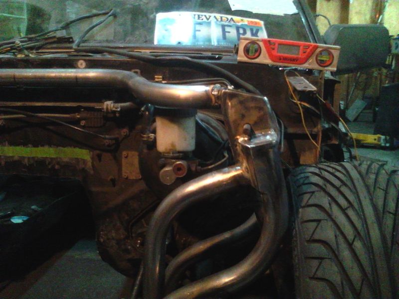

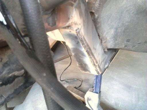

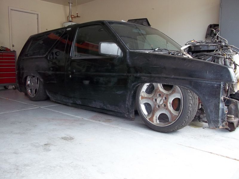

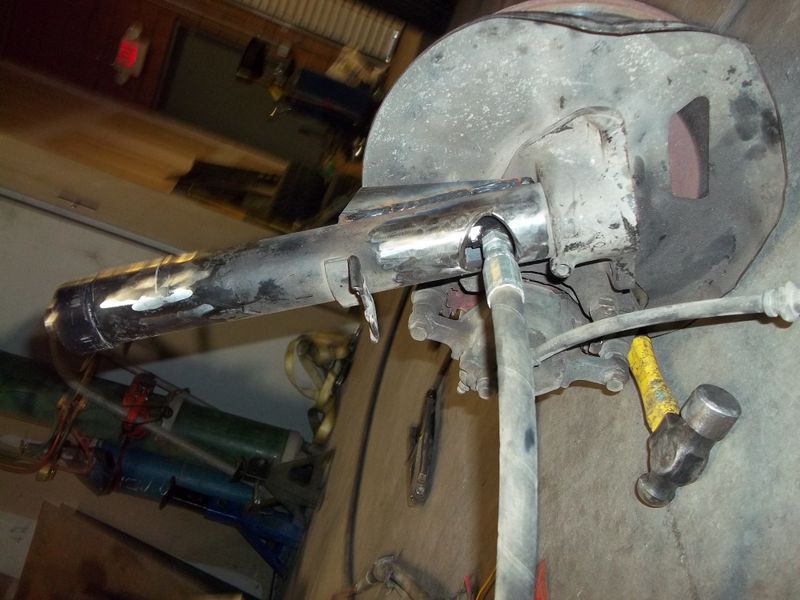

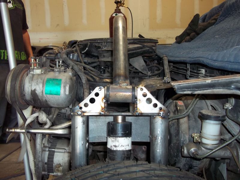

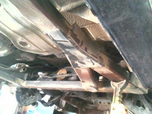

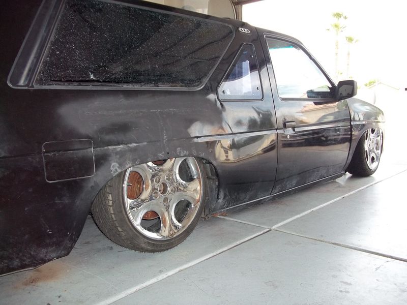

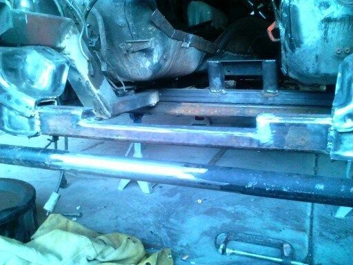

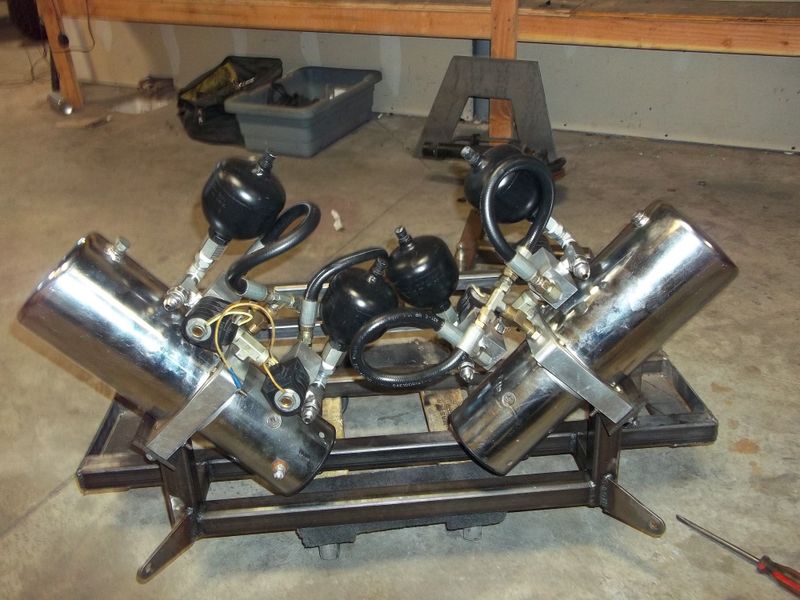

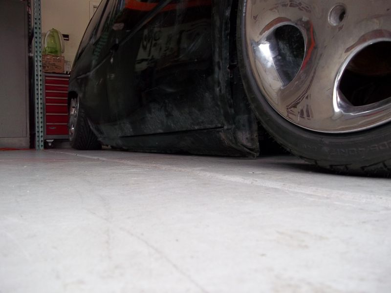

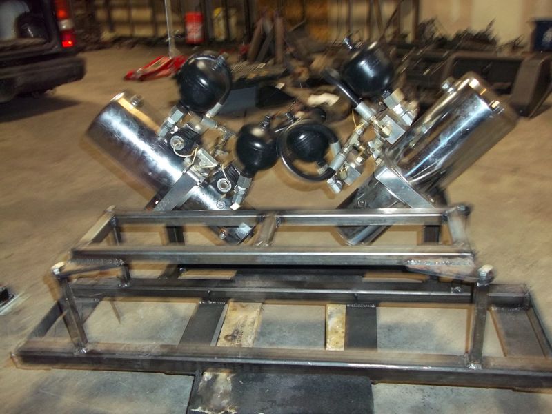

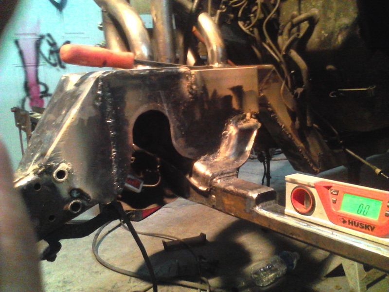

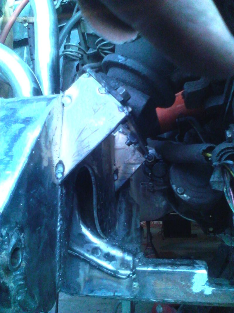

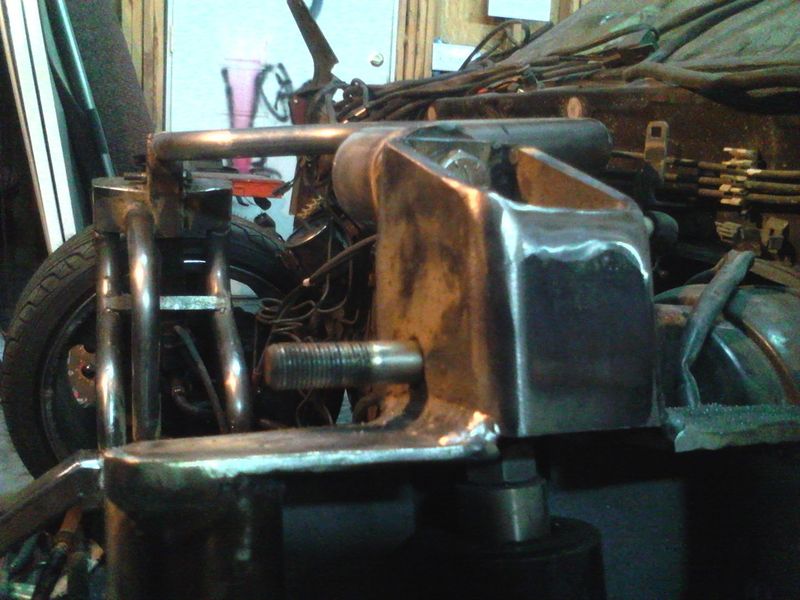

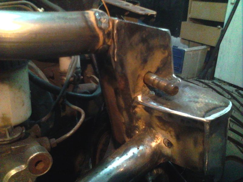

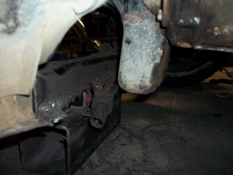

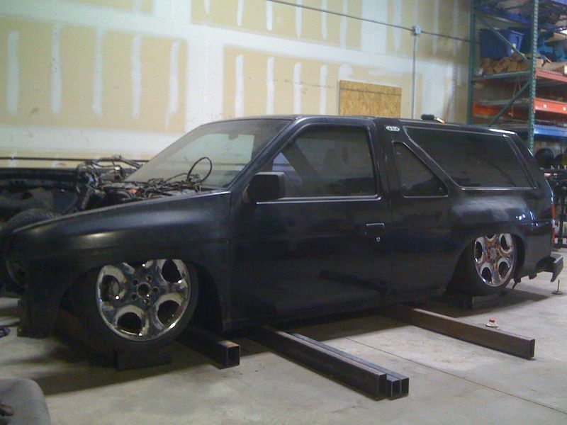

heres my project my friend brian at down and dirty fab in lv is helping me build it is a 89 2 door pathfinder getting full frame built and all 300 z suspension factory width nothing is narrowed im running 17s donated by a friend i hope to replace asap my back seat still sits in the factory position and all the seat belts work as well i need the back seat for my son (2yrs old) im running juice 2 pump 4 dump parker accumulators and 10" black magic triple seal strokes rear tubs and floor is a hard body bed floor and factory wheel tub the gas tank can fit in the stock location and be safe it clears the ground bt 3" the factory skid plate sits 2" off

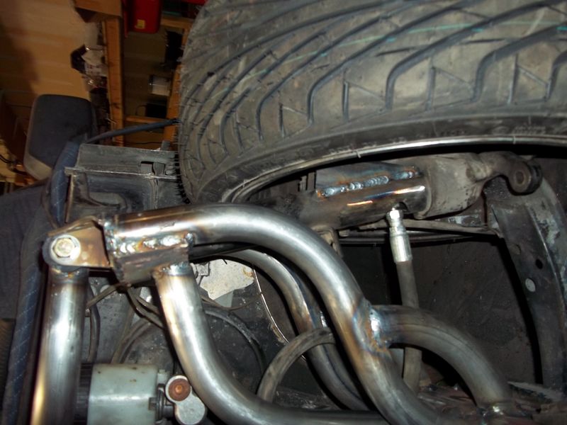

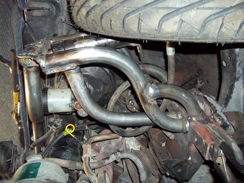

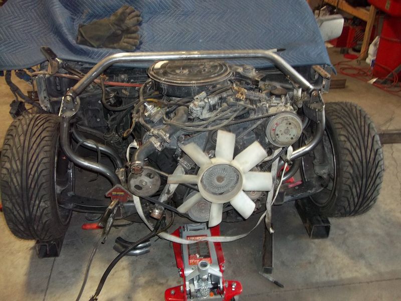

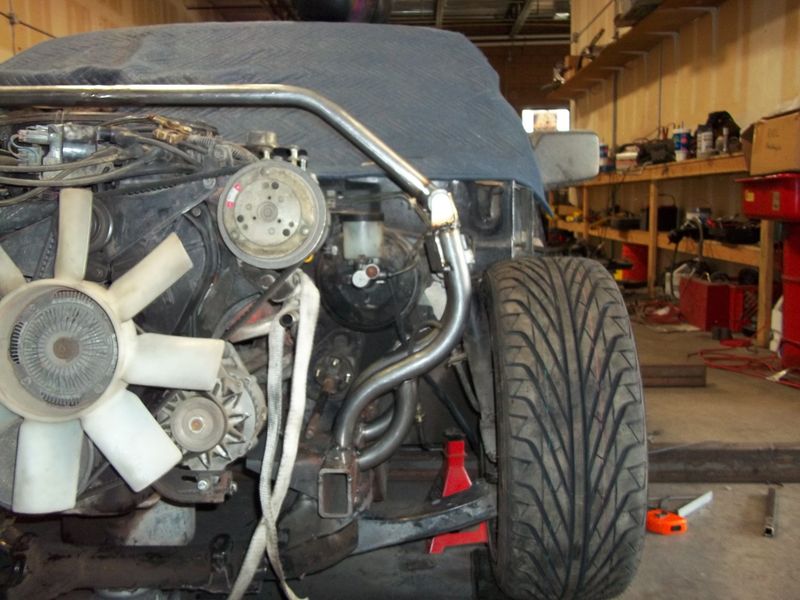

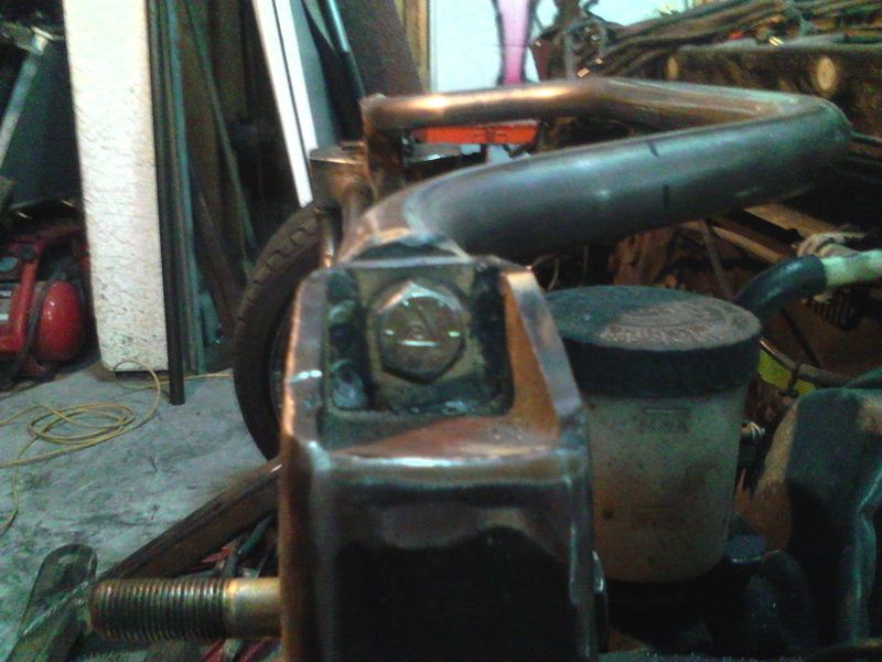

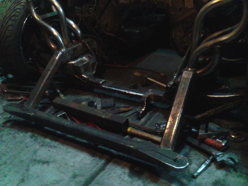

i still have to build the upper mounts for the front strut stroke mount, motor and trans crossmember mounts, body mounts then the body can go back on so i can figure out how im going to make the steering work

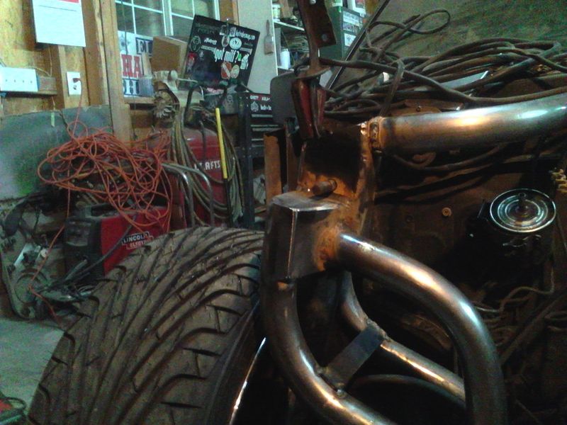

the front stroke clears by 5/16 and the rear flares are slightly flared beyond stock so the tires clear by 3/8 when at ride hight

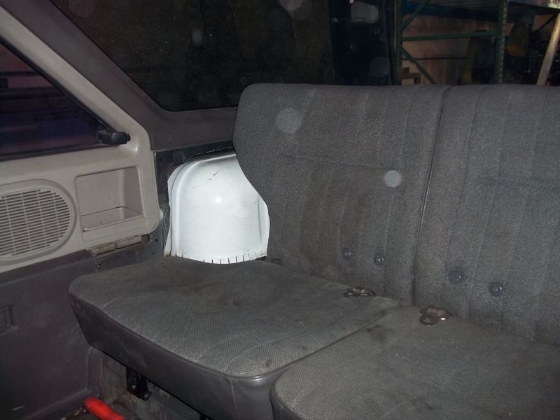

stock back seat laying pinch on 17s

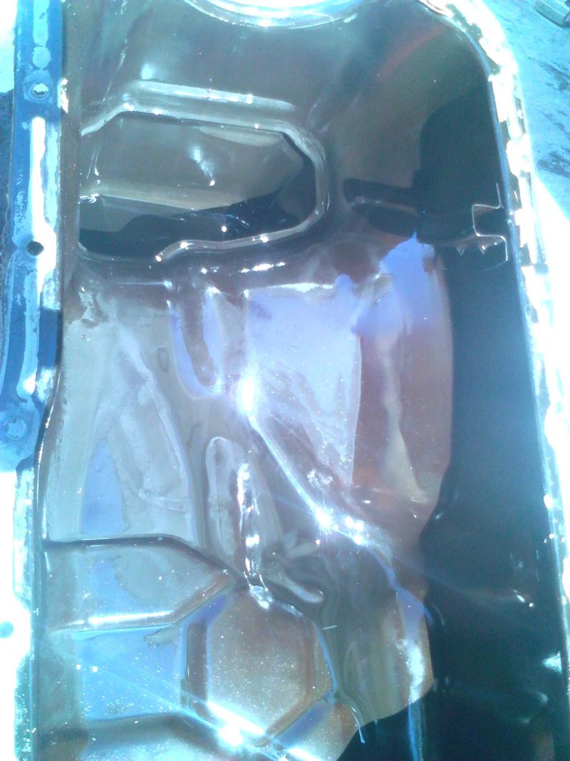

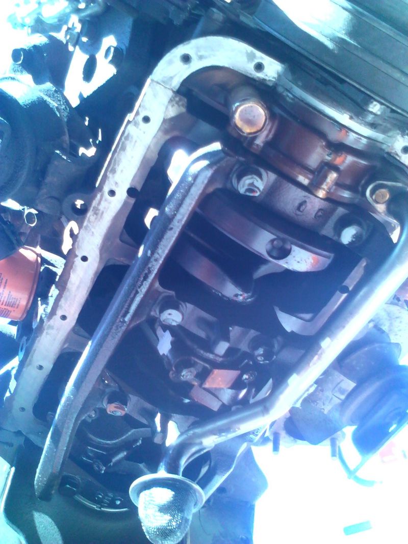

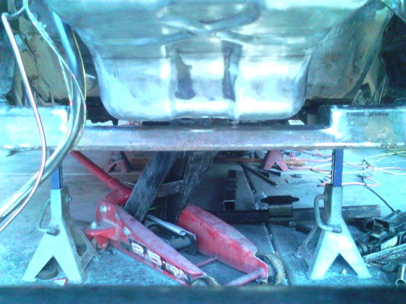

does anyone know if this oil pan can be modified to drop the motor some or does the pick up tube go to the bottom of a v6 oil pan in a nissan ?????
