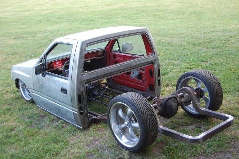

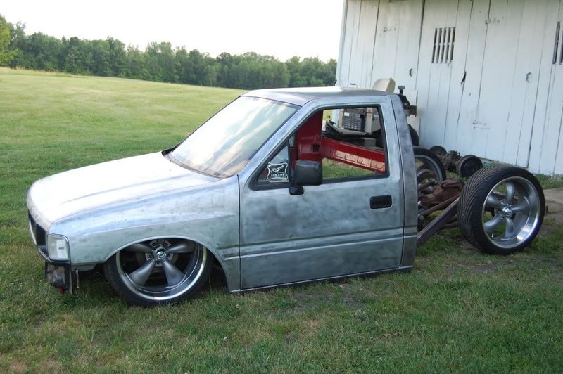

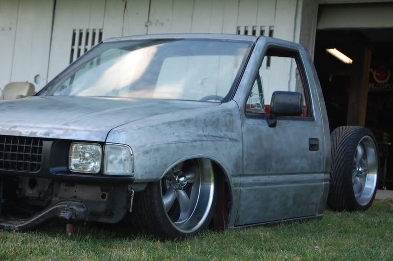

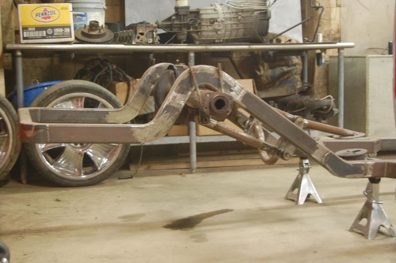

Figured it was time for me to stop creepin on ss and actually post my build thread. Ill let some shitty cell pics do the talkin for now.

I need to take some good pictures of this thing. Its such a badass truck. I cant wait to see you work on it some more!
Whats all the plans for it?

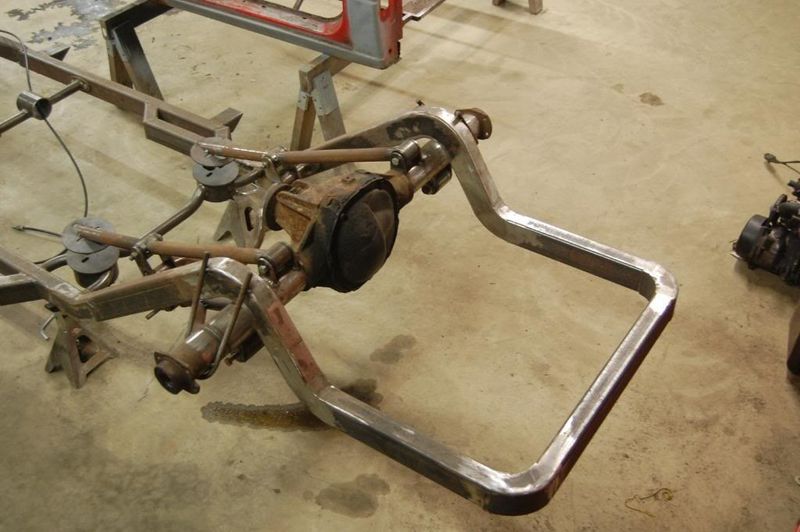

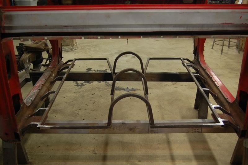

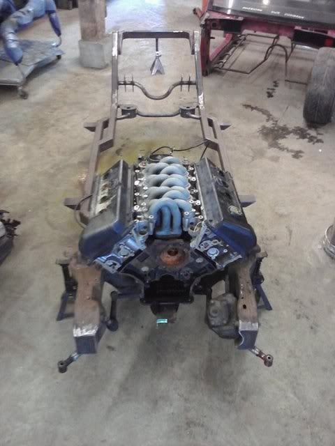

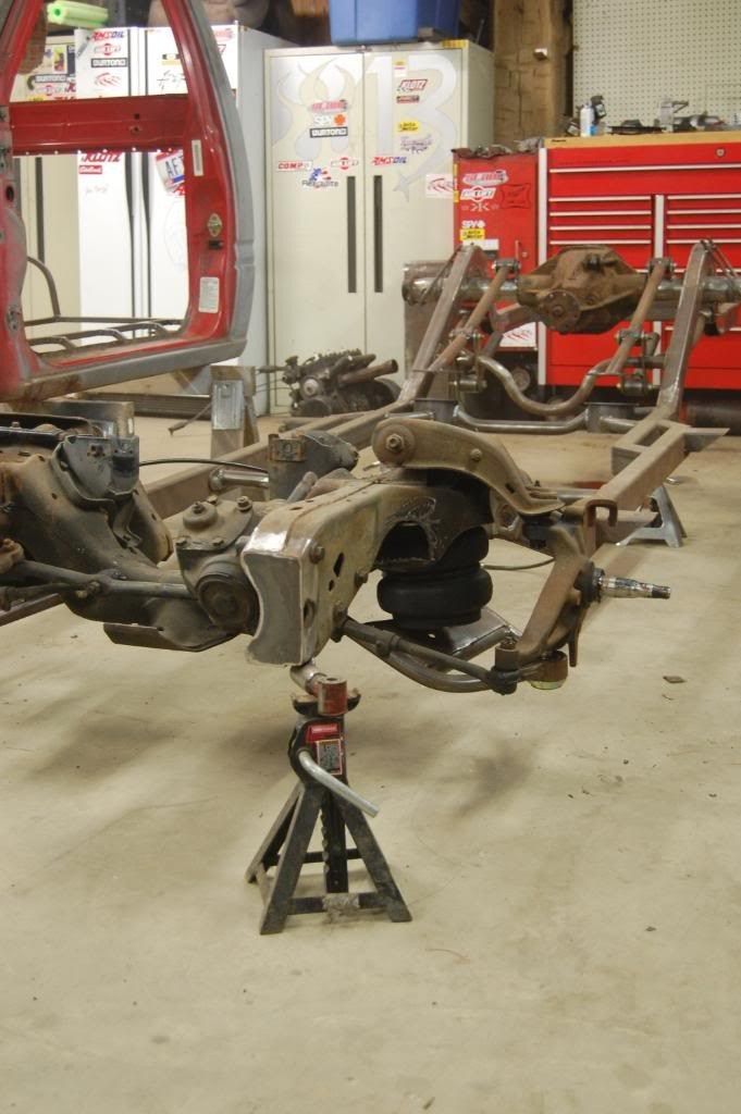

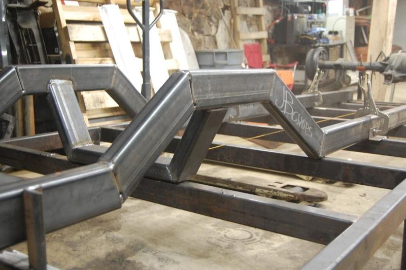

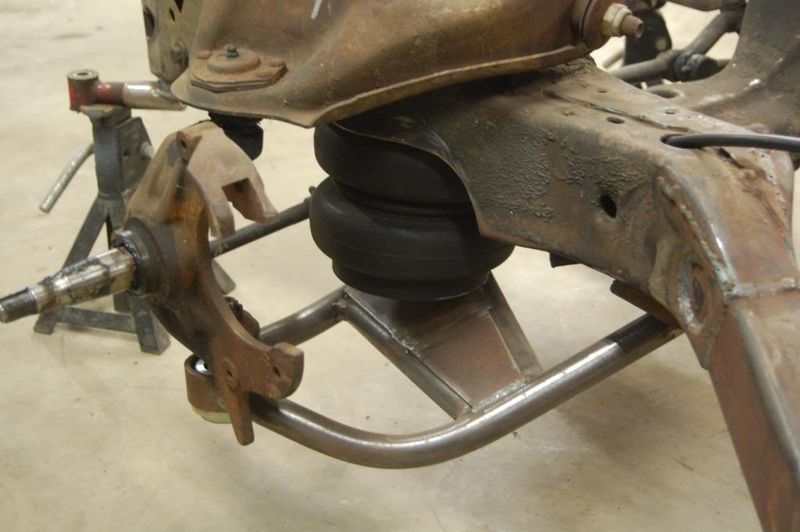

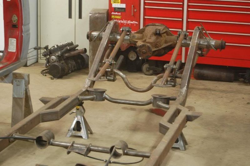

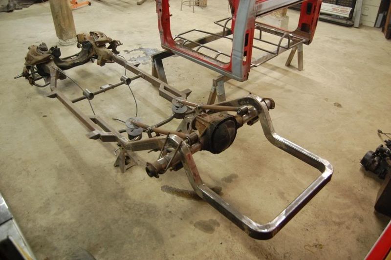

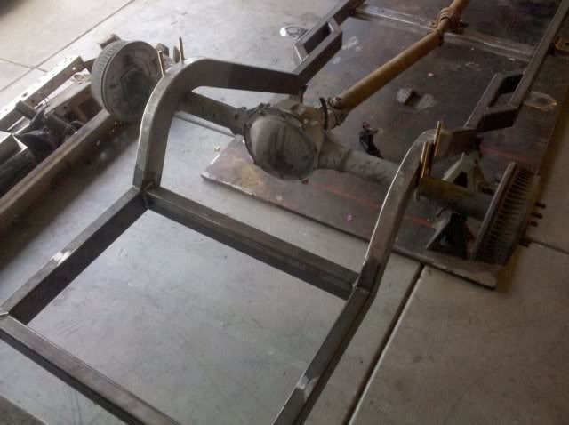

Thanks for the input on people to check out for renderings. Freeman shot some better pictures for me that I should have up tomorrow so you get a better idea of where im at so far. as of now the frame is almost done, its an s-10 front clip with JBchops lowers, 2x3 from the firewall back with hand cut radiused bends. simple cantilever triangle 4 link, fuel cell made to match the radiused corners. knocked 2.5 inches off the rockers, started the new floor. Plans are finsh the odds an ins on the frame and get it all smoothed over, JBchops uppers, powder coated, hard lined. Body is getting a ton of attention which Im not ready to share yet but the only thing that will still have a factory form is the hood. lol

love the cantilever... so simple and clean!
