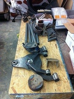

So this is my current project its a 2008 chevy silverado...Someone keyed the truck down the passengar side so that is what started this project. Everything has been a nightmare for this truck ever since that has happened. So with that being said Im using Michigan Metal Works flat plate upper and lowers with a uca raised bracket. The rear im using a parrallel 4 link w/ cantilever and a watts link. MMW also narrowed the rear axle a total of 8 inches. I gave moser a call and they machined some axles to still make the rear abs and such work.. The wheels are raceline deceptives on a nitto 420s 305/30/26. Im using ssbc brakes front and rear also. I will be using accuair and ss bag for the air management. So let the fun begin...

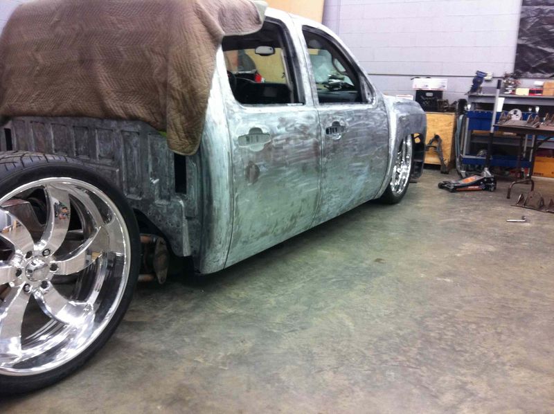

1lochevy
Edited: 4/6/2011 10:09:37 AM by 1lochevy
BEFORE PICS OF THE TRUCK

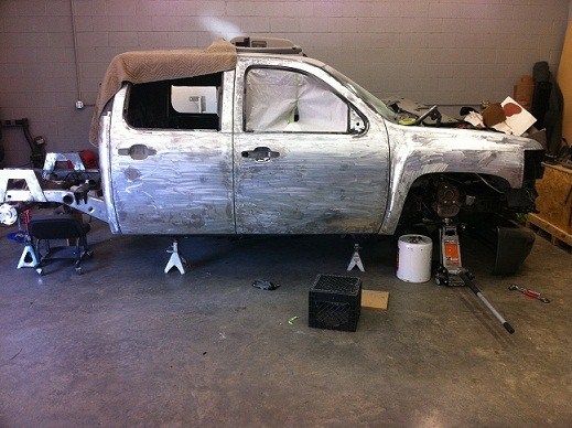

1lochevy
Edited: 4/6/2011 10:29:29 AM by 1lochevy

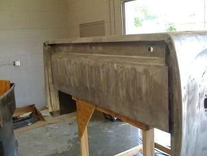

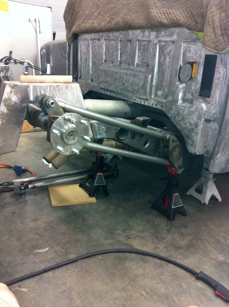

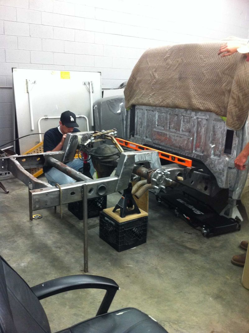

BED OFF

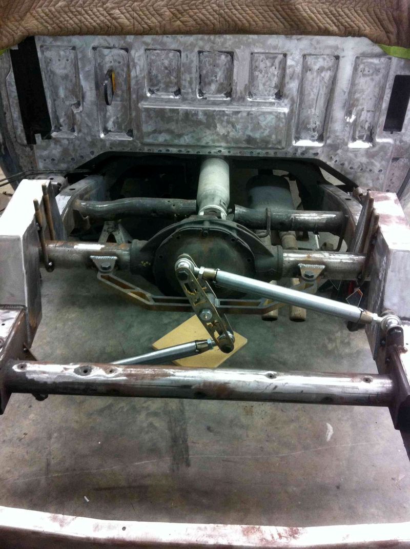

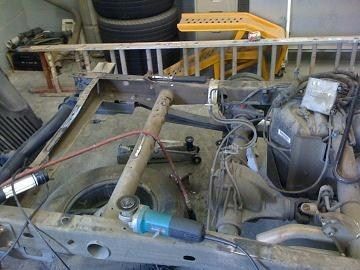

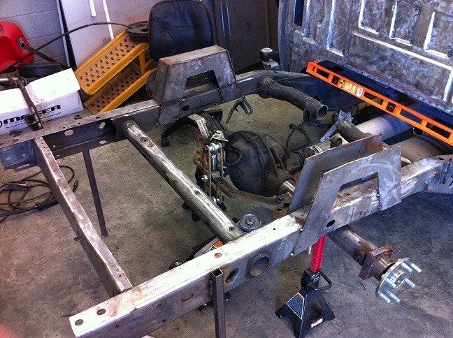

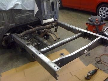

Cleaning all the bs off the rear

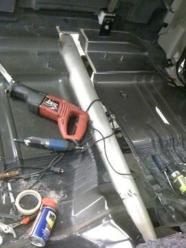

Mocking up the notch
cuttin to make room for driveshaft

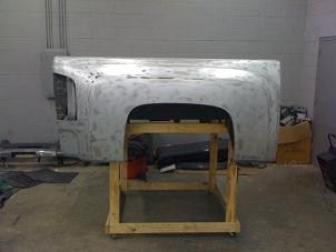

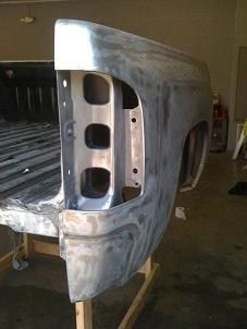

Stripped the bed to bare metal

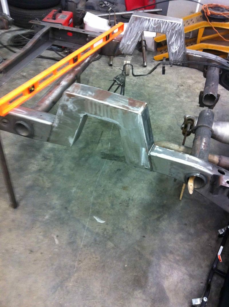

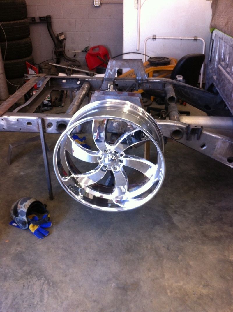

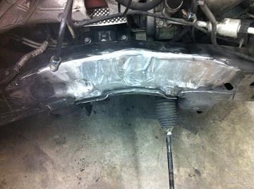

Grindin all the front factory mounts off

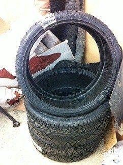

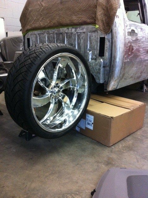

Nitto 420s 305/30/26

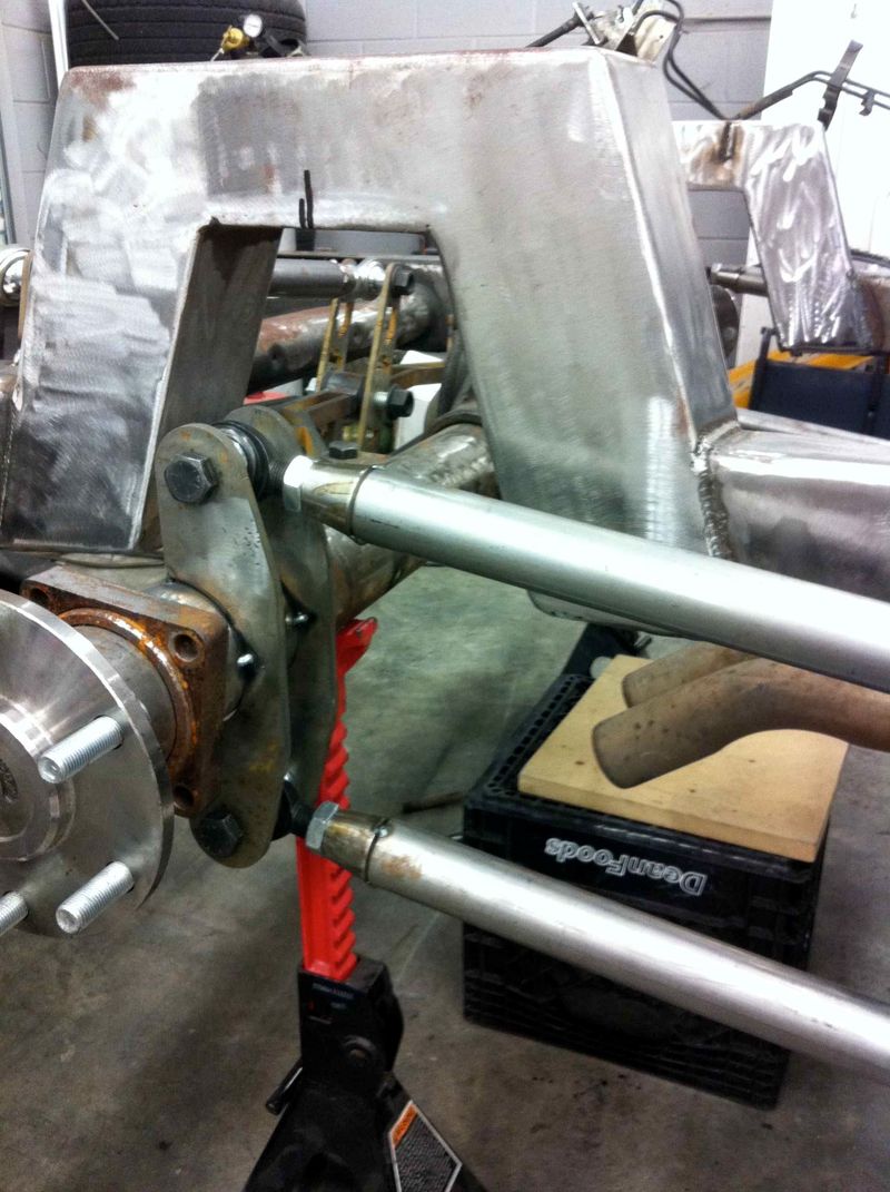

Edited: 4/6/2011 12:23:28 PM by 1lochevy

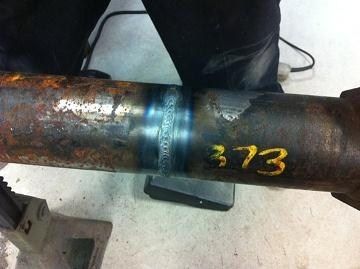

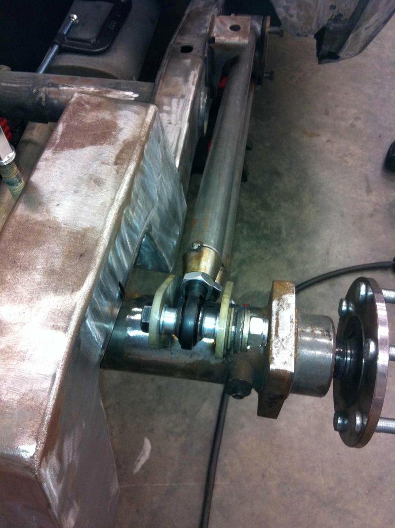

Taylor at MMW parts he built and the rear end he narrowed
