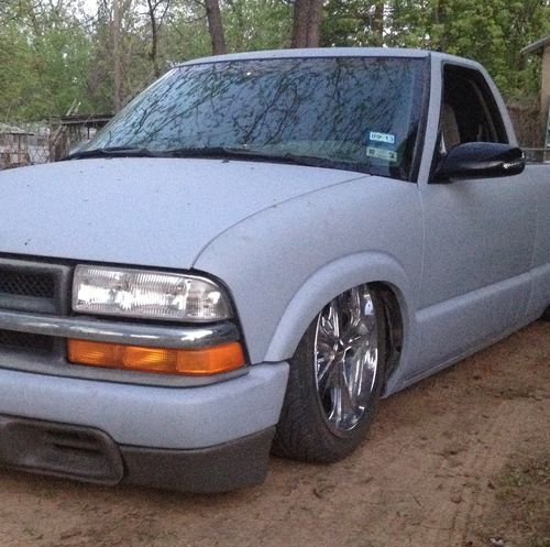

lowasschevy's avatar
lowasschevy
as u can see my truck is already bagged,but i dont like my ride quality o
