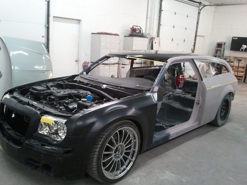

We're taking an 06 Magnum that will be getting a 2 door conversion, and Nomad inspired rear glass section with tilted B-pillar. Add in a 300 front end, a modified TZD 300 body kit including a extra long deep dish grill, and TZD Firepower hood. Throw in our very own Halo shaved door handle kit, and fuel filler relocation kit, molded tail lights and a split hatch round out the rear end. Air Lift suspension on USW staggered 22" Extravagents round things out. Cover it all in Lamborghini Matte Ballon White with Super Jet Black roof and highlights. The car was originally a 2.7 and we'll be swapping it out with a 3.5 and possibly adding some power to that.As it rolled into the shop

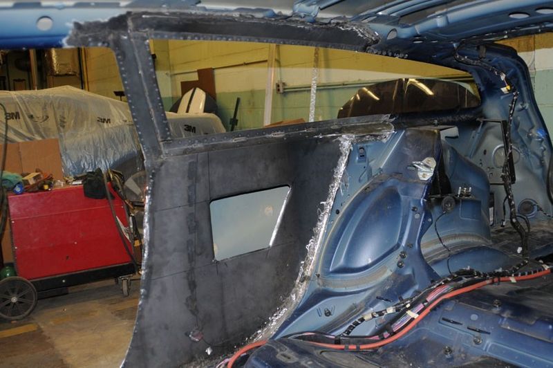

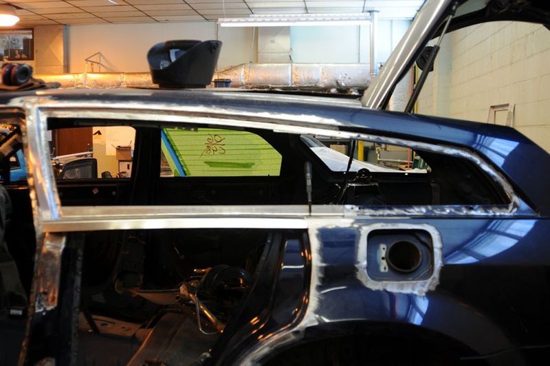

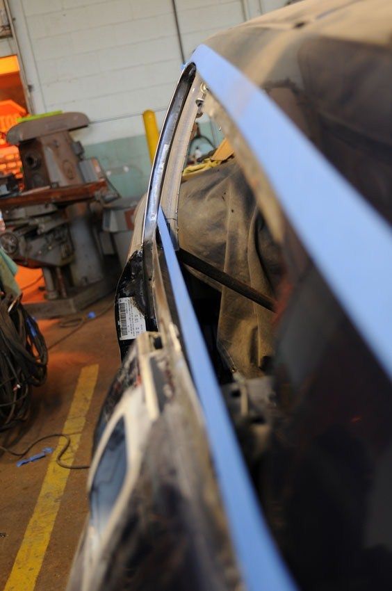

Laying out the plan for the rear window

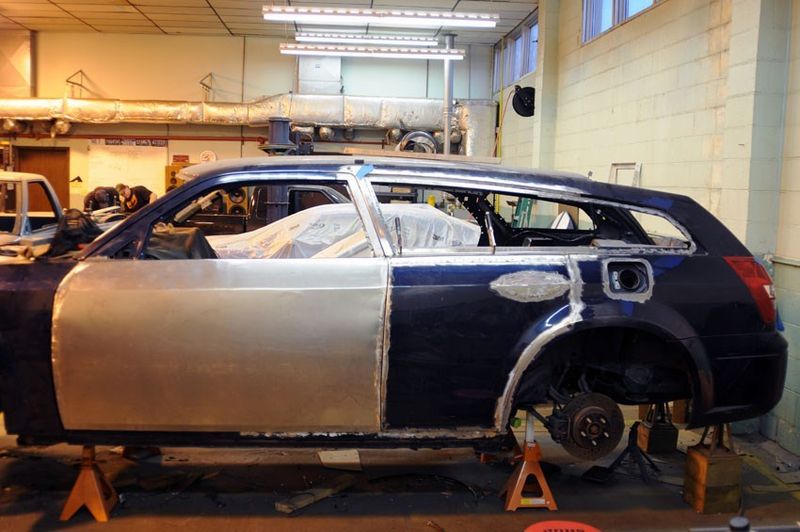

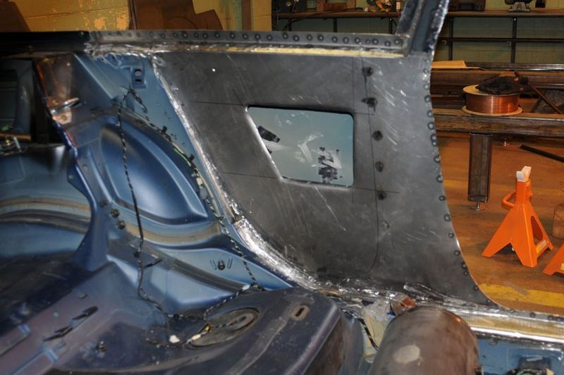

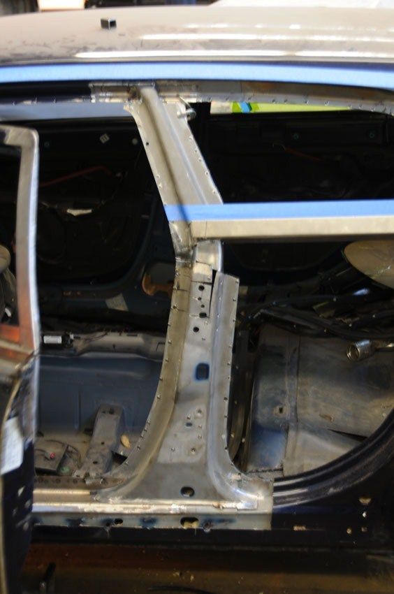

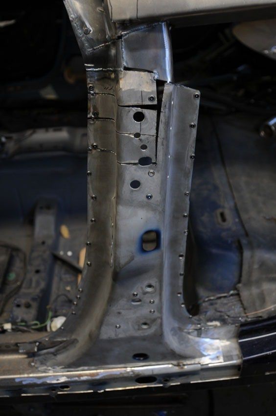

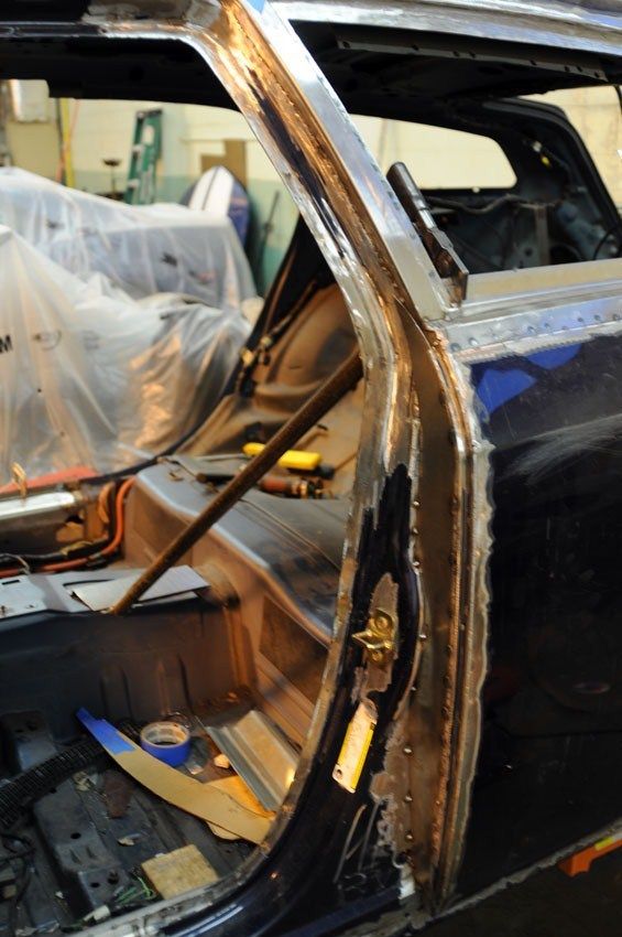

First thing to do is dissect the B-pillar by taking the outer skin off
leaving just the inner support
so we cut that out
and fill in the inner section first
then close it all up
leaving a nice big opening

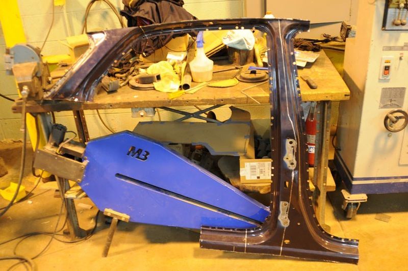

then we set the b-pillar back into it's new home

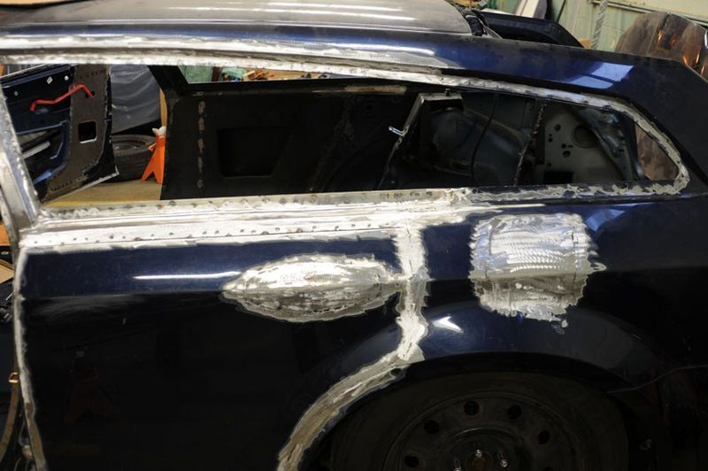

new door skins rolled

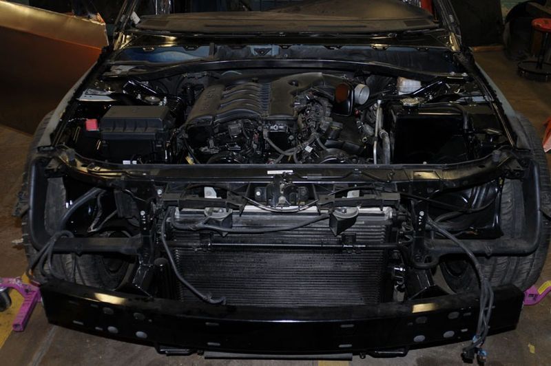

Out with the 2.7
dropped in some brakes off a 5.7 and the Air Lift suspension

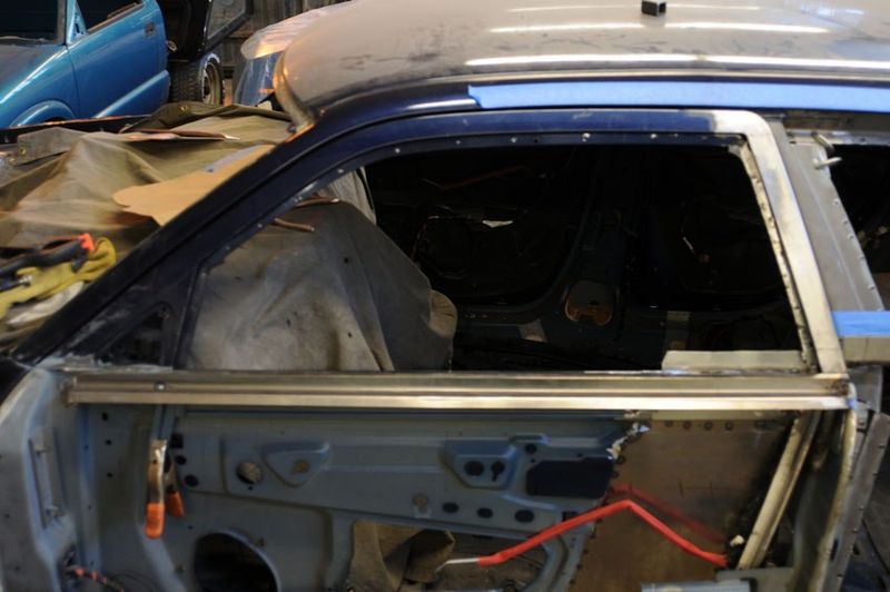

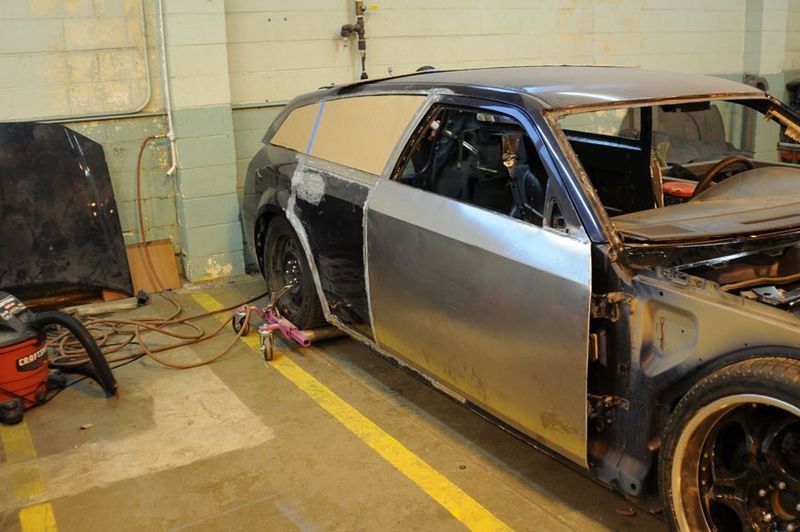

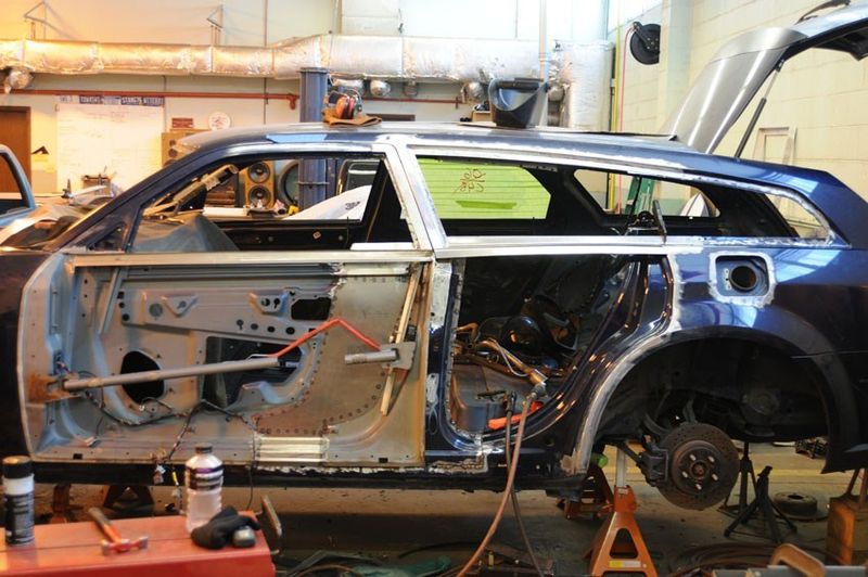

Driver side inner door skin is extended
Just need to stretch the window frame and set the angle for the rear post and b-pillar and we'll be ready to slap a skin on it.
Hopefully we get the engine bay painted, then drop the 3.5 in it and start wiring it up.

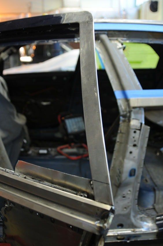

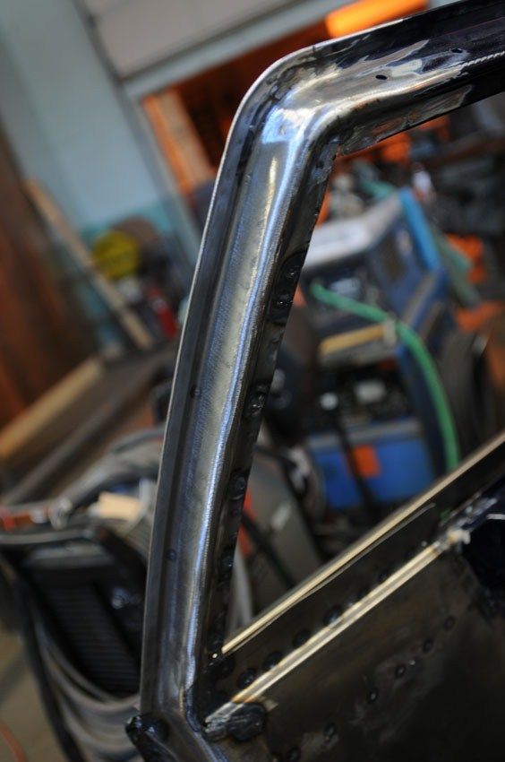

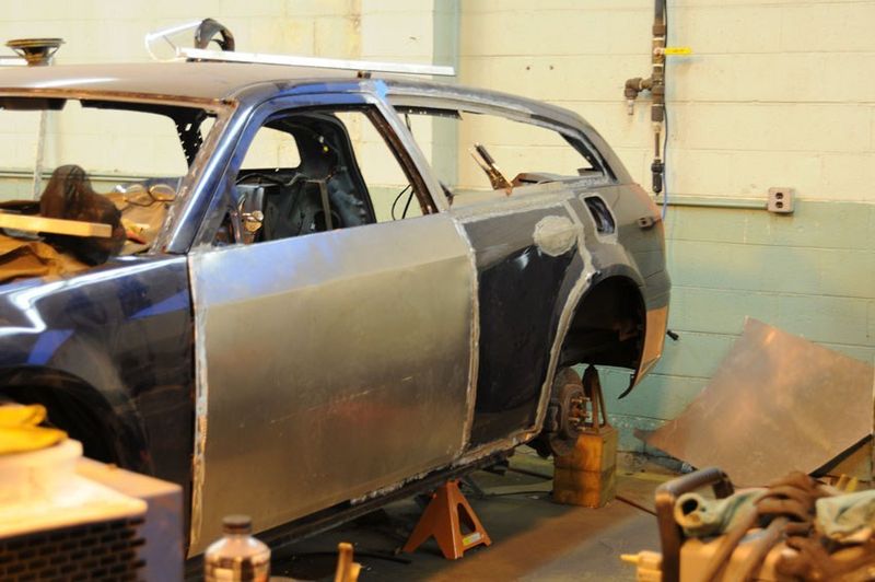

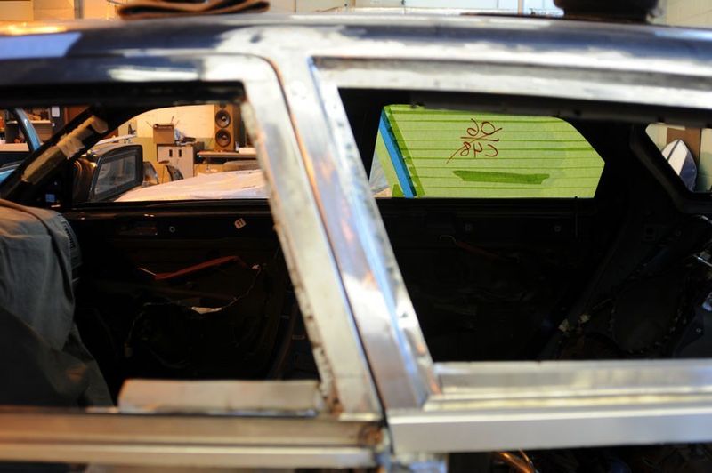

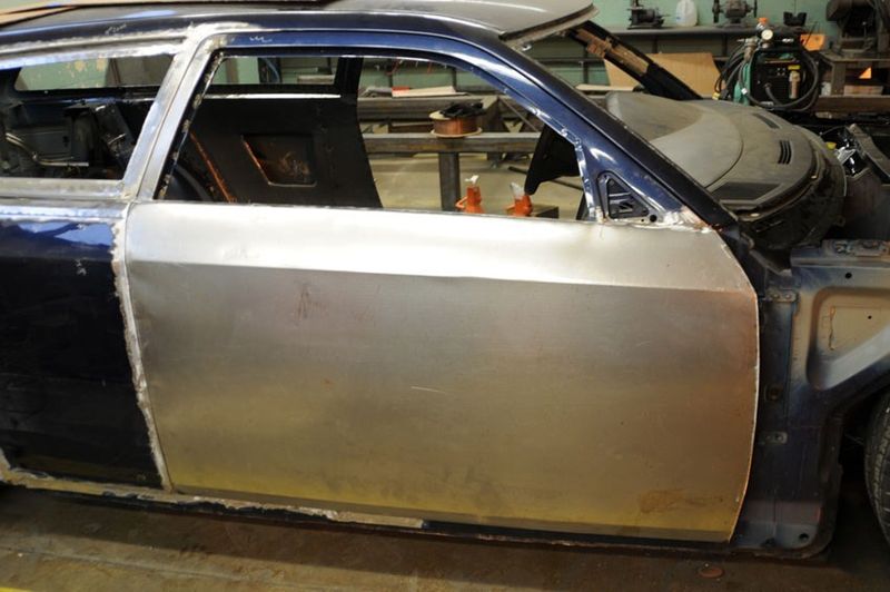

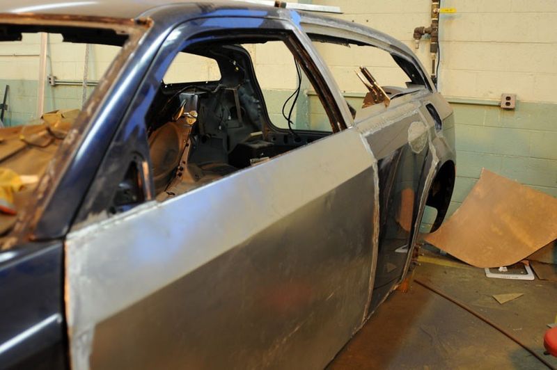

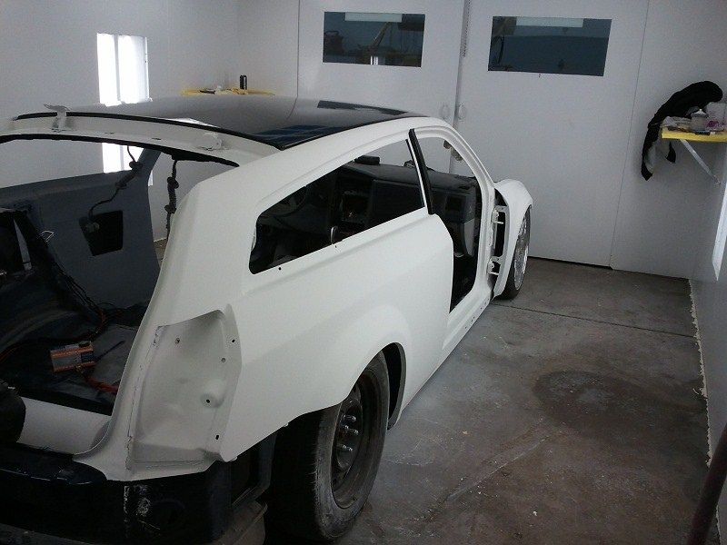

Fab'd up the new, slimmer, door frame

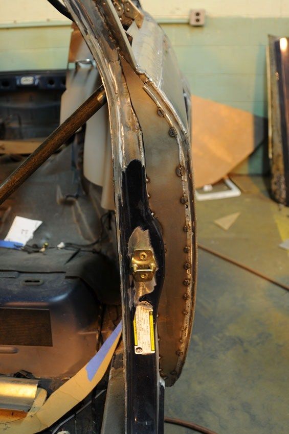

This rear part of the door frame was made pretty much entirely hand formed
New B-pillar angle
Some pie cuts to get it into shape, now just need to put it all back together

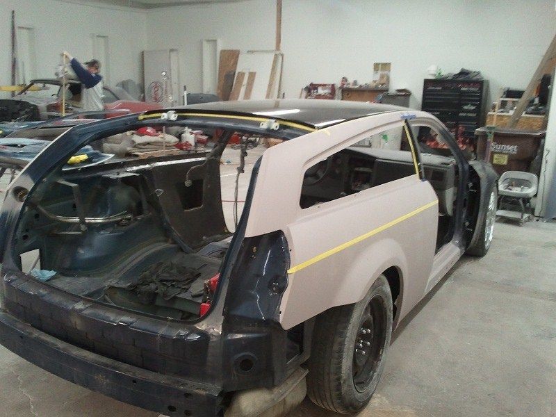

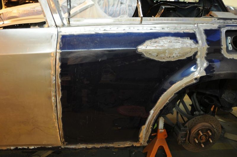

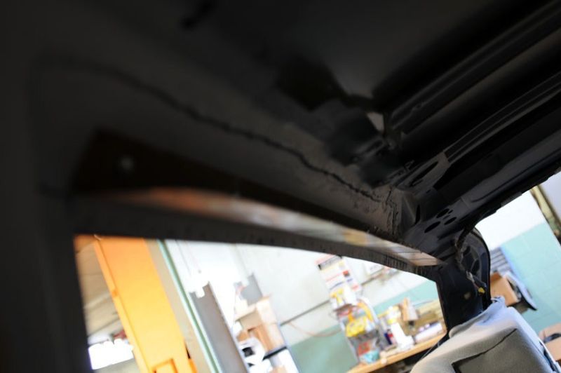

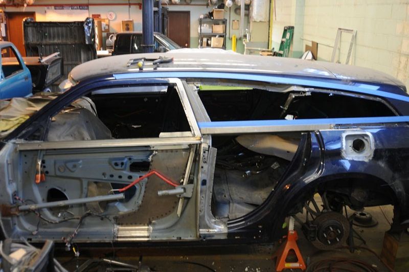

We thought with some small changes we might be able to get away with running a flat piece of glass in the rear, but if you look at our tape line and see how much the body curves over that distance, there is just no way. Yeah! more custom glass.:TDOWN:

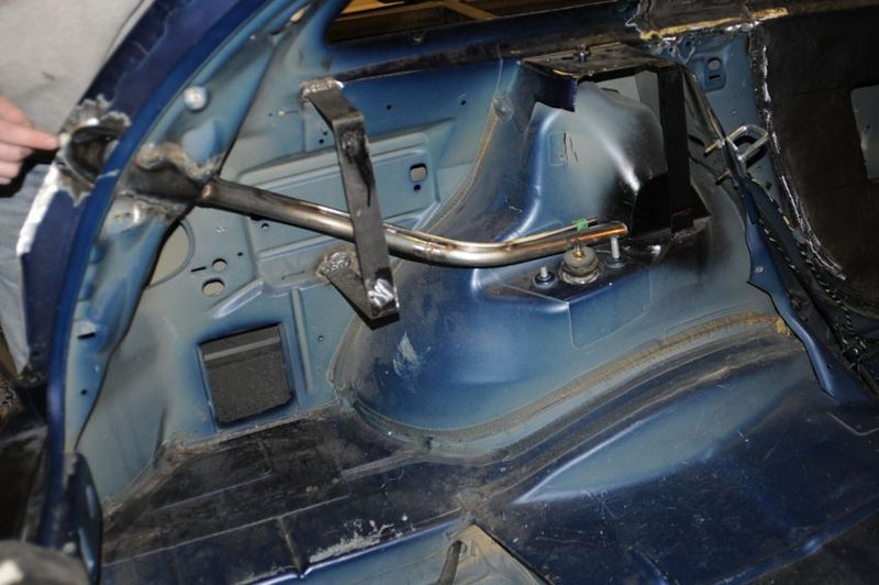

Just a reinforcement bar, and the skin is ready to go on

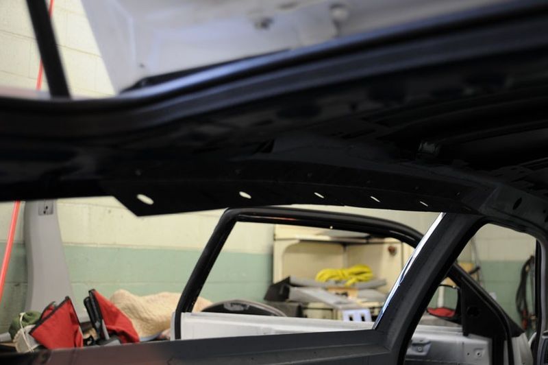

No more C-pillar
B-pillar getting final skin
Rear window frame getting finished up
Full side profile
