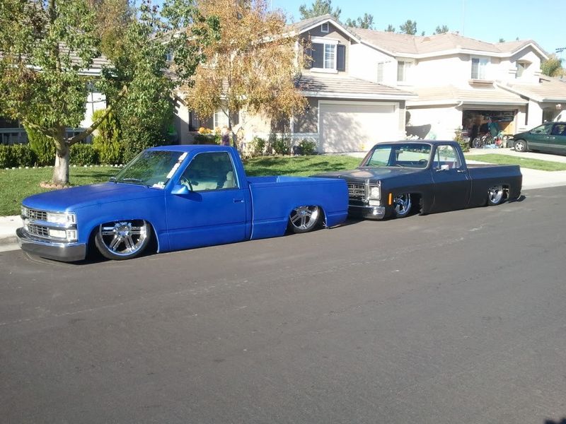

I only took a couple pics during the fix up. I was asked why I didn't do a build thread on it, so I figured I would throw up the pics that I did take. In no particular order...
tre5's avatar
tre5
I made all the rear 4 link and watts link stuff. The control arms are made by myself and Josh. I added the heim steering as well. I used an AirBagIt.com air engine for the valves and it works awesome. I have it plumbed with digital gauges and an AVS switchbox. I mounted the Viar compressors using AVS compressor mounts, and the air tank and air engine are now mounted to an existing cross member. The customer supplied all the air management stuff.
The truck was already bagged and body dropped. I redid the portion over the axle with a c-notch, and new bag mounts. I body dropped a new bed so it would not have a hole in the bed floor. I also put on some new fenders that are trimmed to fit the 22" wheels and I wrapped the opening with 1/4 round and rolled the fender lip over the 1/4 round. I also cleaned up a bunch of under hood wiring, mounted a new grill and bumper, mounted a battery, and wired up some electric fans.
