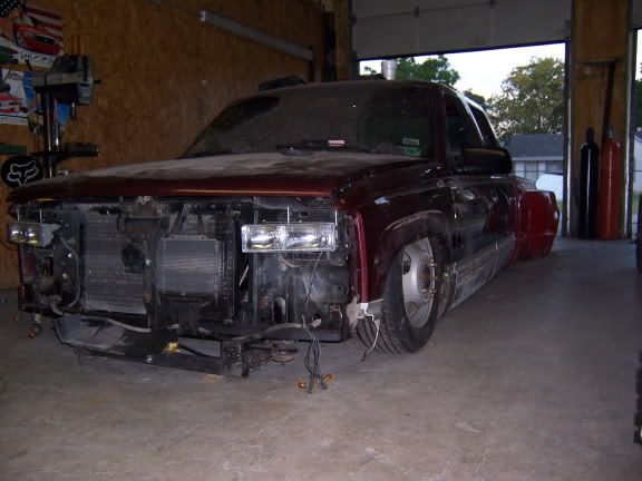

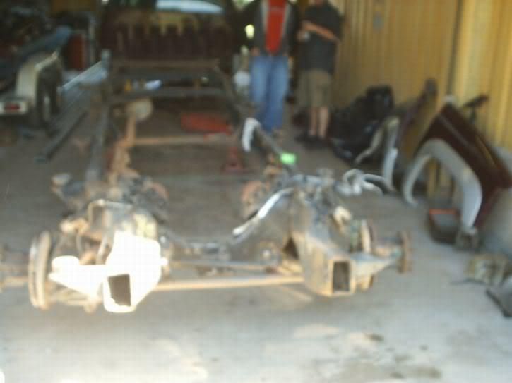

what i started with out of a junk yard(sorry for the shitty pic)
truck i got the cab and frt sheet metal off of

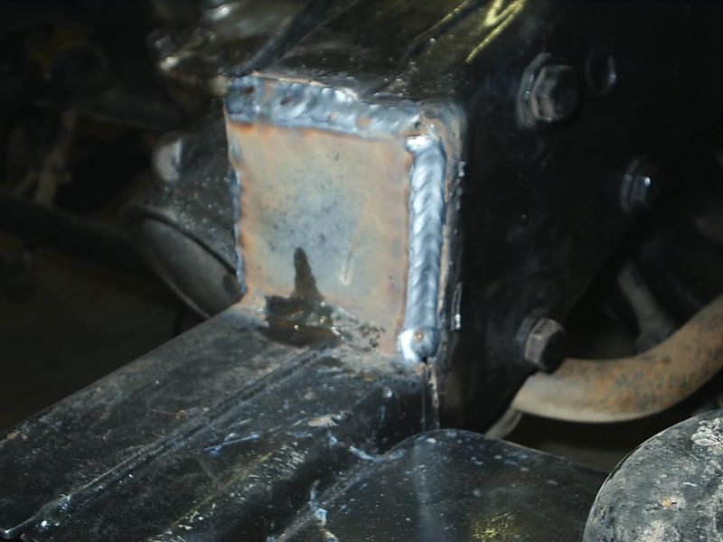

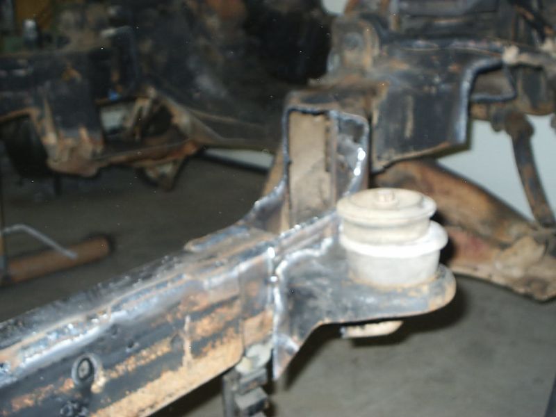

front body mount moved down and frame cut for firewall to drop down right
pic of frt mount with cab back on(kinda see how/why i cut out of the top of the frame)

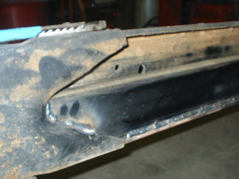

frame with the 2x4x.1/4 tube before i cut the top off

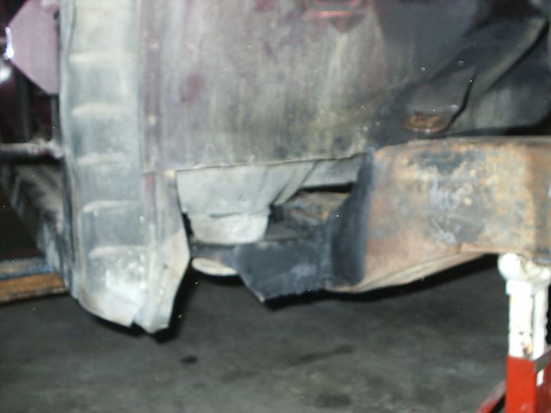

core support mount droped down and boxed

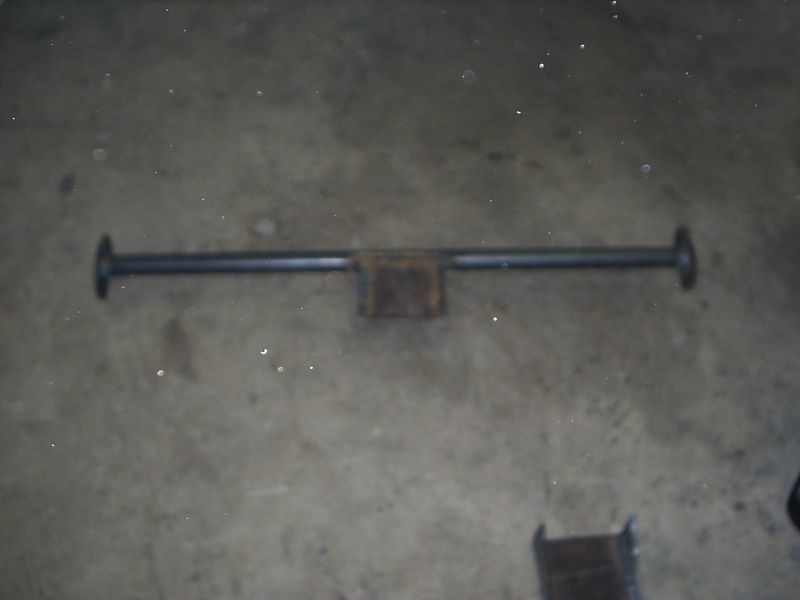

trans and carrier bearing x member

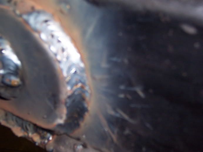

carrier beraing xmember welded to new framerail

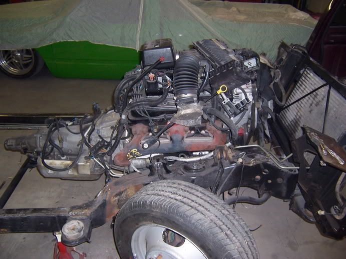

motor sittin where it should be finally

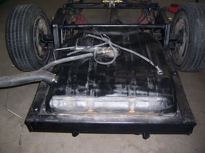

suburban gas tank in the way back9 rear susp is 3 link wishbone style but the 3rd link isnt bolted in)

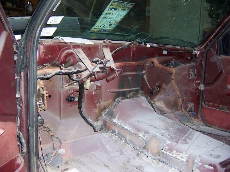

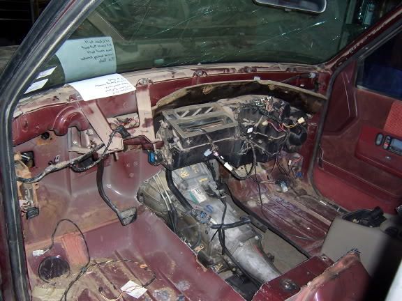

cab on and trans tunnel cut out
trans tunnel moved up and welded back in

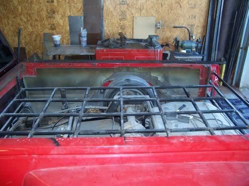

inside of the bed gutted and framed up for new floor

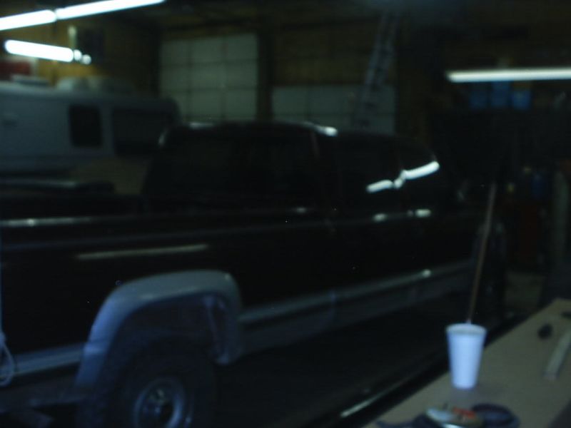

everything sittin together before i tore it all back down after rearranging the shop and gettin more room to play
