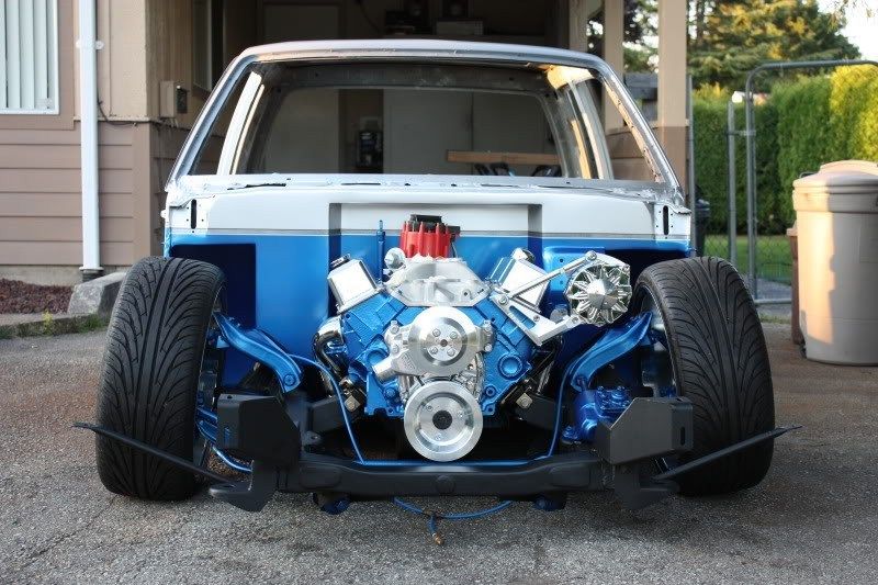

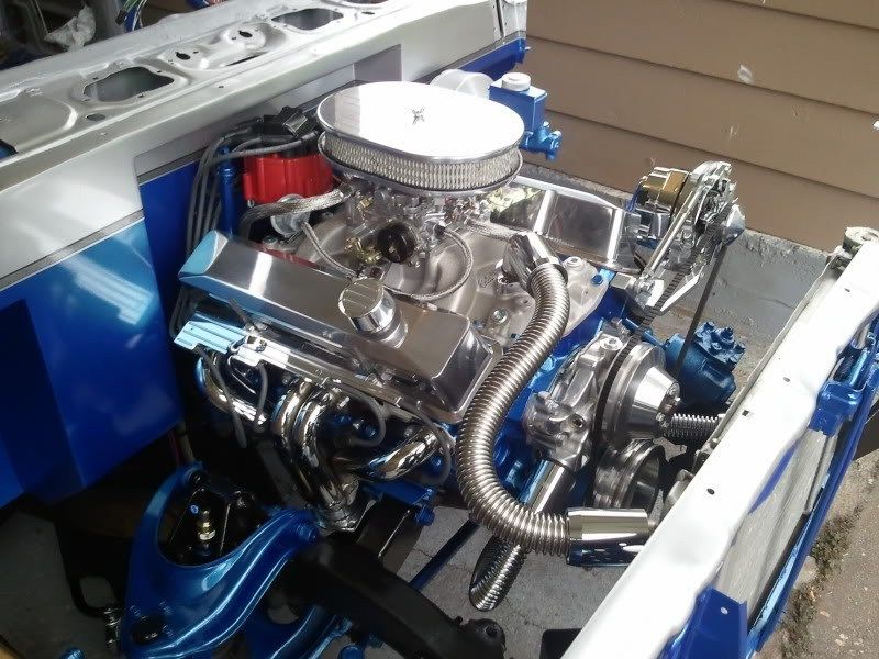

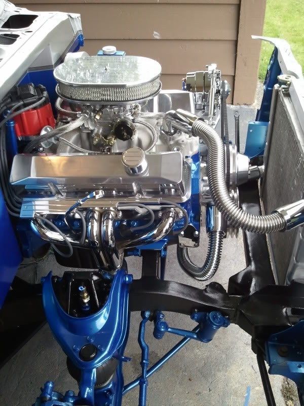

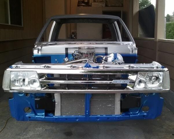

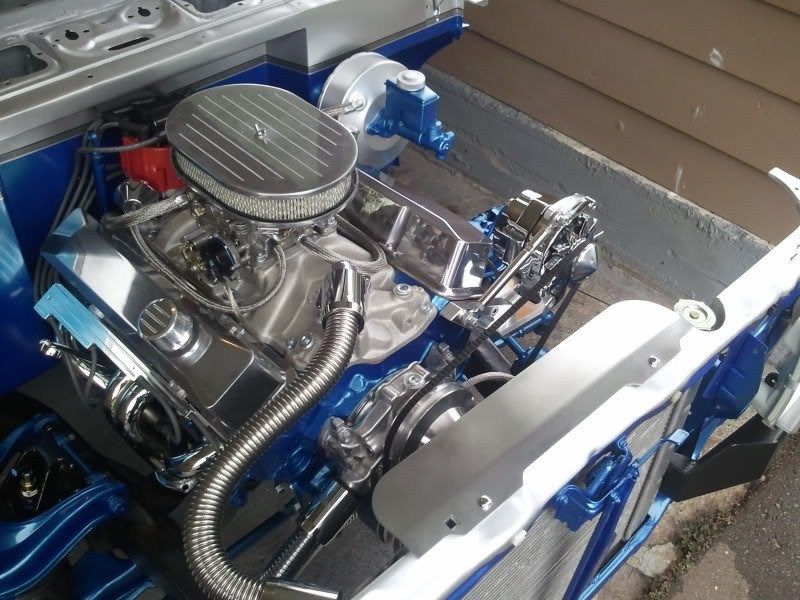

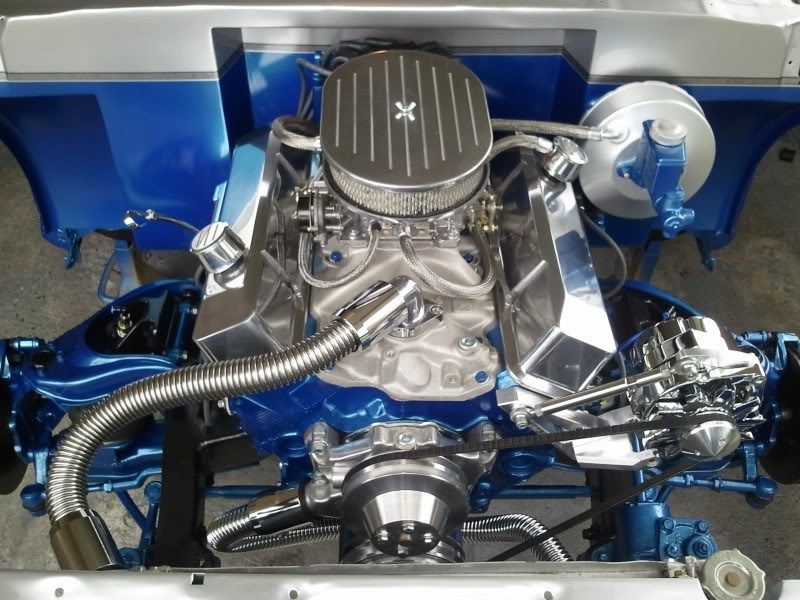

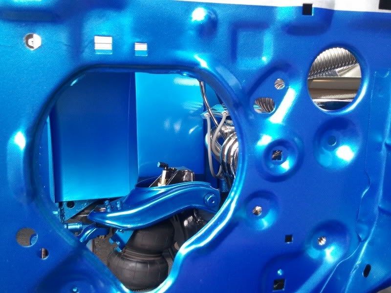

Havent updated this in awhile and thought I should update it lol. Got alittle bit done this summer, planning to get alot done really soon tho. I will keep my post current from now on lol =)
Motor is getting closer to firing up

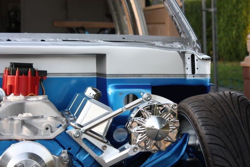

Painted all the inners
Closer look at the pin stripe I did, this is my first ever bc/cc paint job too, sprayed lots of primer jobs in my day tho lol

Looks awesome!!!! Where did you get that altenator bracket??
