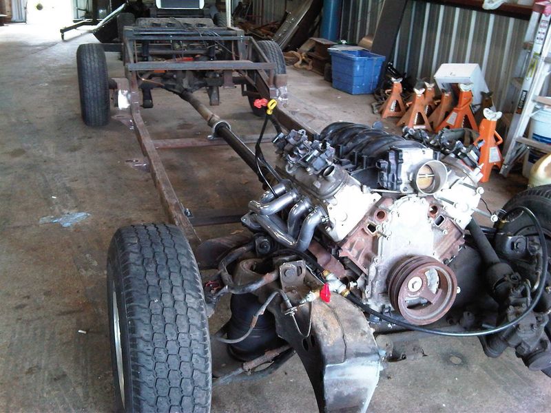

i used 2x4  3/16 wall and went about 1/2 into the rocker,  but stock floor is a myth

Hey man on Tonys c10 we did a notch back with 2x4 3/16 an made "diamond gussets" outta 1/4" plate. Then made his bridge outta 2x2 3/16. Check it out I know you know where he lives

im usin 2x4 by 1/4in wall
