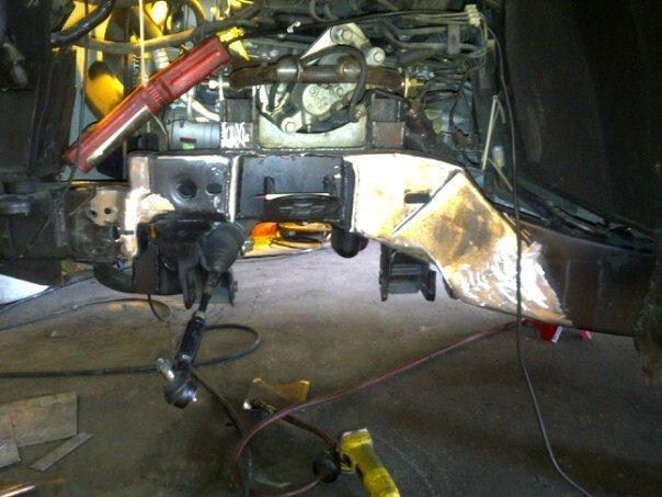

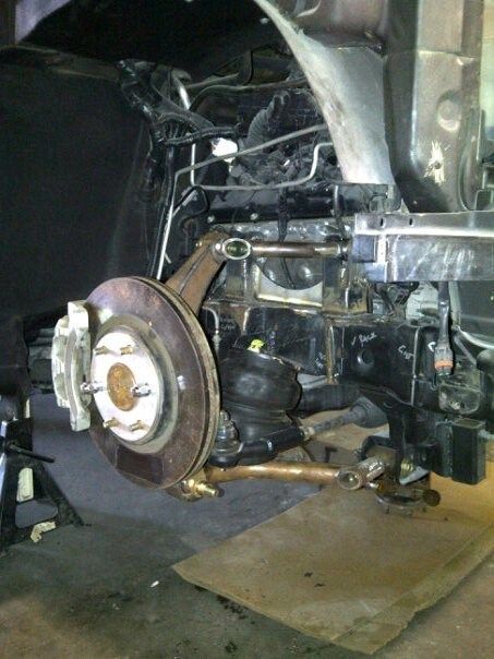

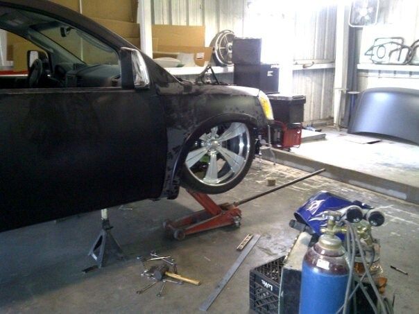

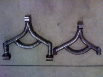

Its been awhile since my last post,so I got it Z'd 2 1/2" sectioned the trans tunnel from firewall back to where the front seats bolt into.I still have to plate the frame and section the bottom of it.then onto the problems,im going to have to tub the bottom side of the hood,and then figure out what to do with the hood hinges

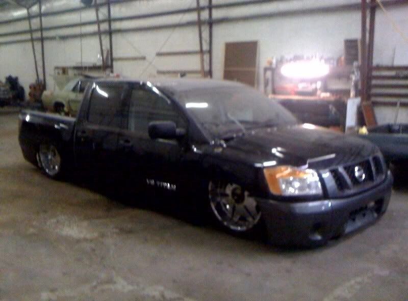

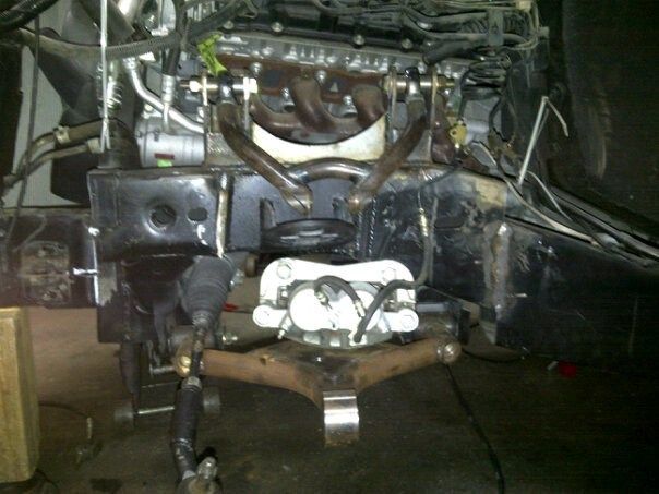

well almost done should be off the rack this weekend,had to call in reenforcements to help out with the new innerfenders in the front so me an Jamey Jordan will be hitting it hard this weekend

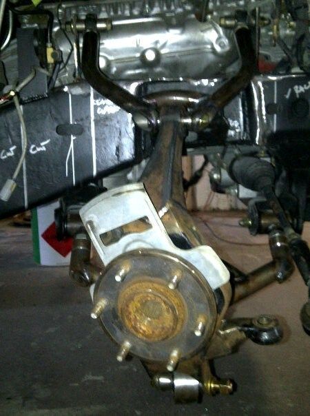

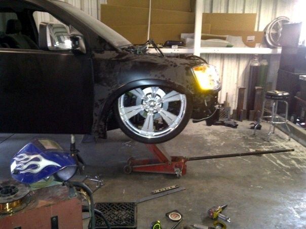

A little update pic im really diggin the 26 stuffed up in there to the center cap
