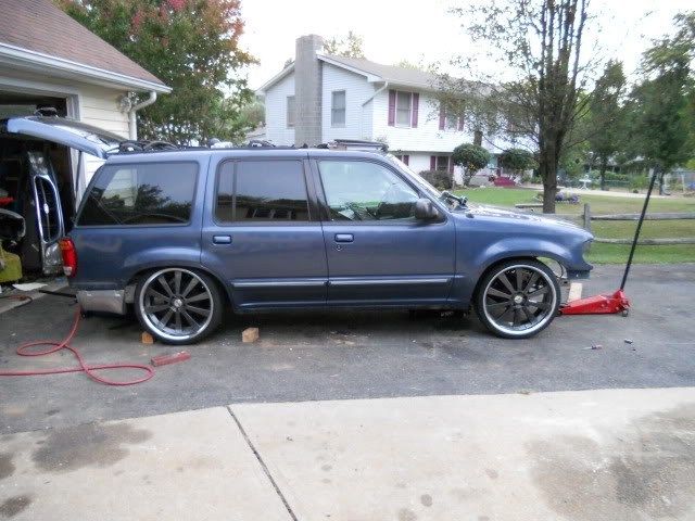

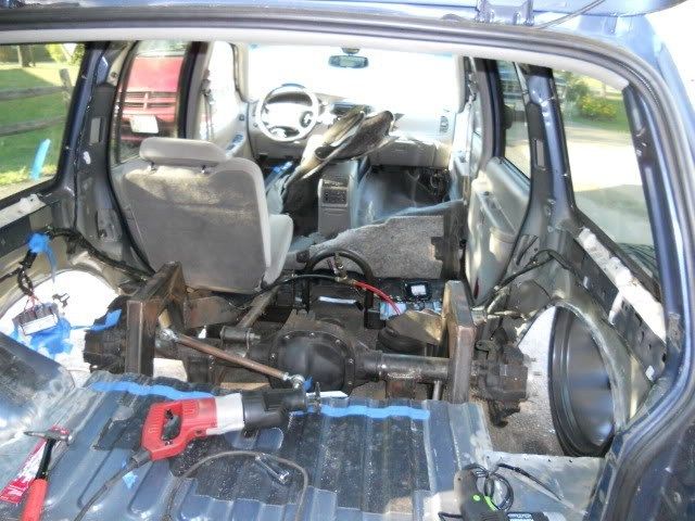

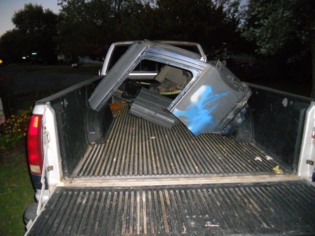

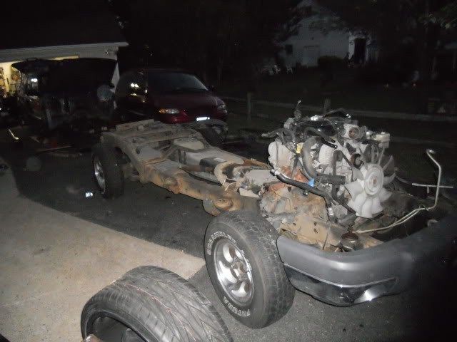

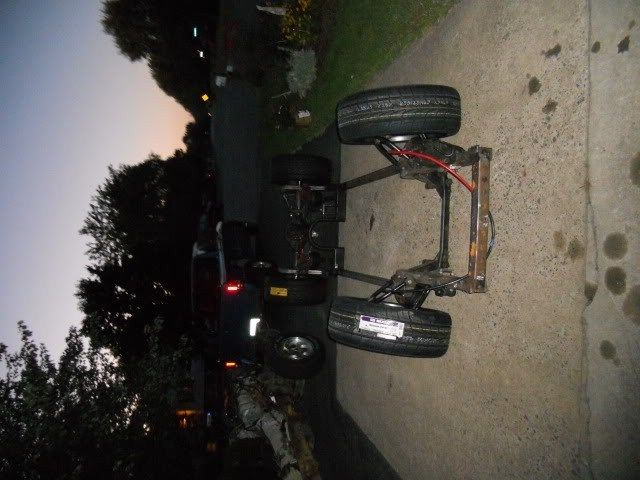

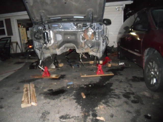

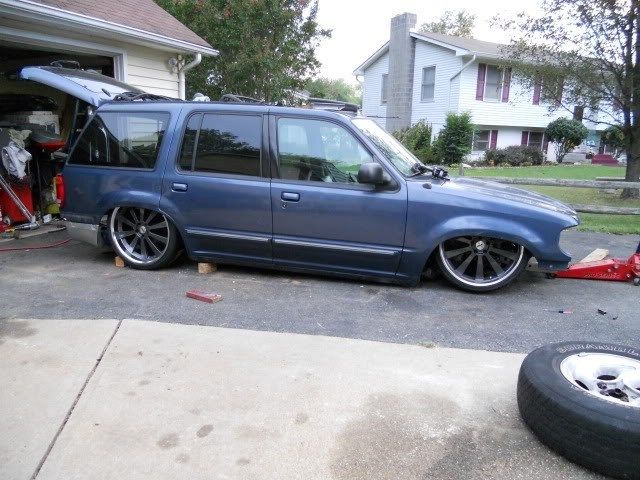

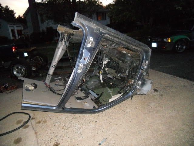

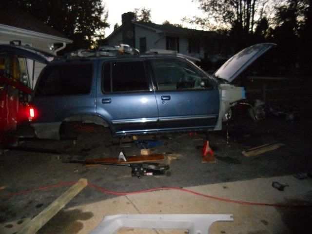

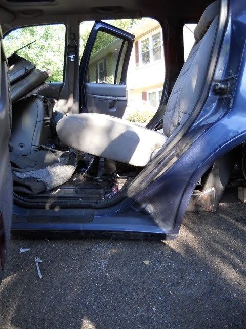

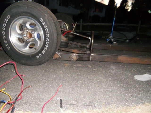

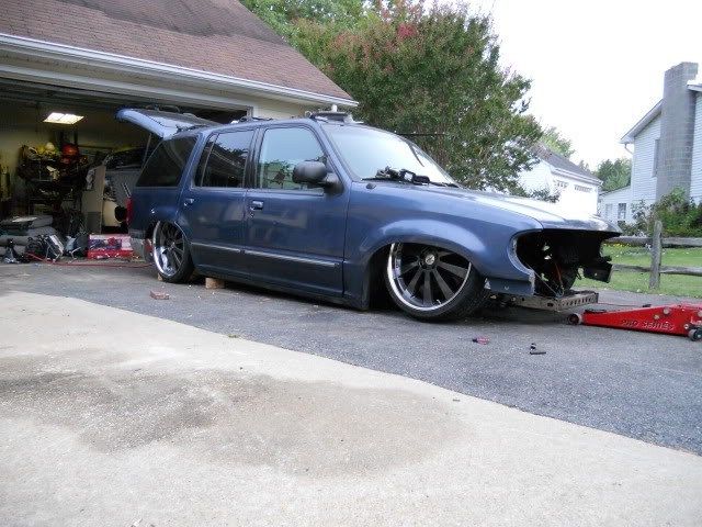

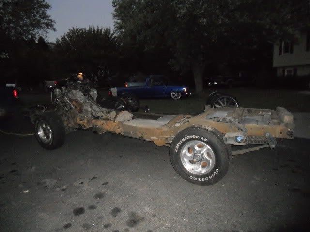

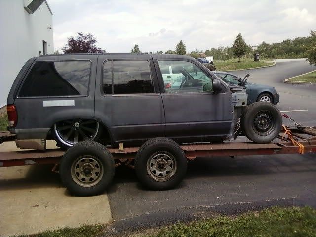

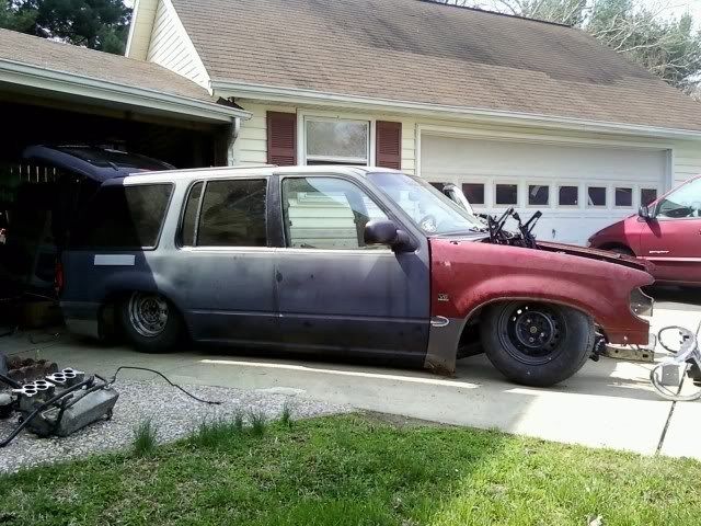

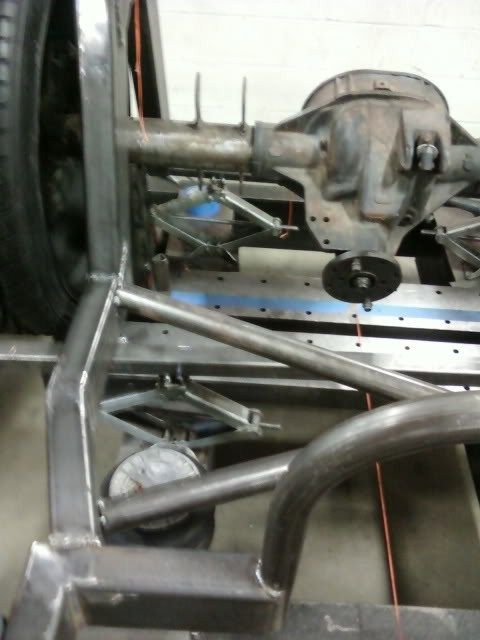

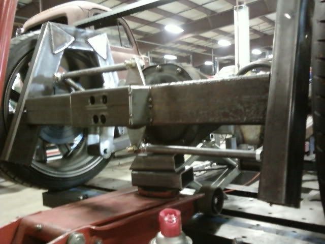

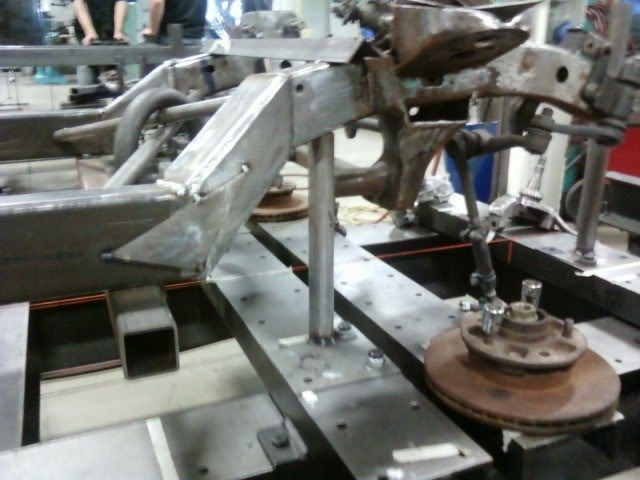

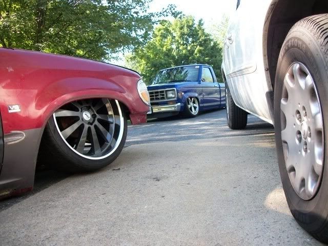

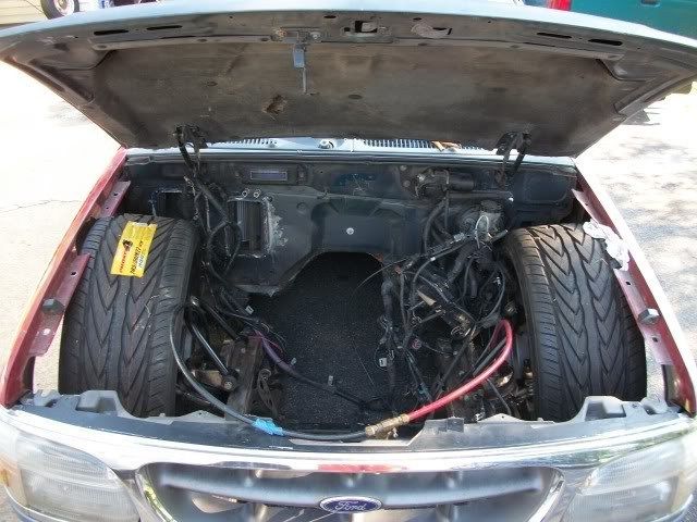

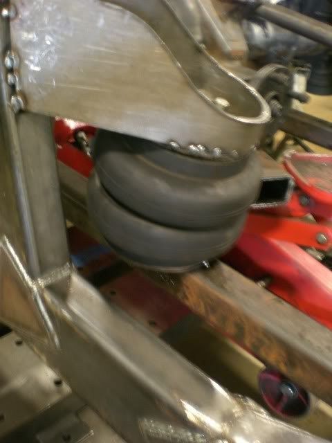

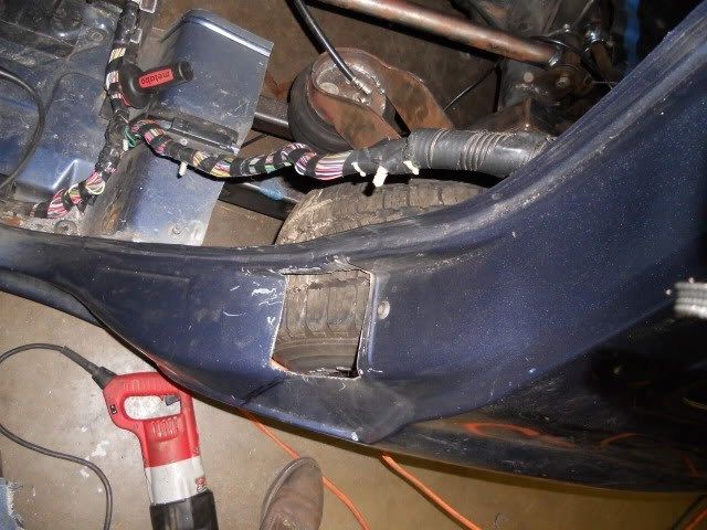

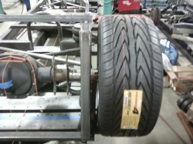

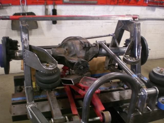

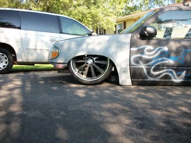

this is my 99 explorer, i bought it already bagged but everything was off so i cut it all out to redo everthing. it has a yota clip with drop spindles and cando arms. and a 2x4 frame with a 3link with a watts. the rear end is narrowed like 8ins. all the doors are shaved. and its gonna lay on 2s. ill post more pics as i gothe day i got herwhen i got her home ( on 19s from my ranger)the new frame \

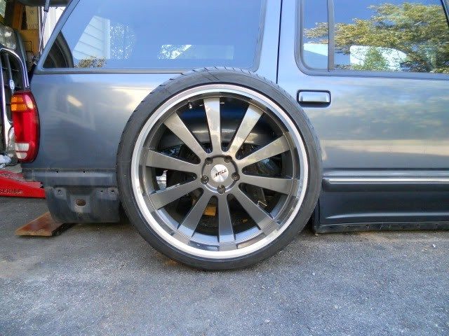

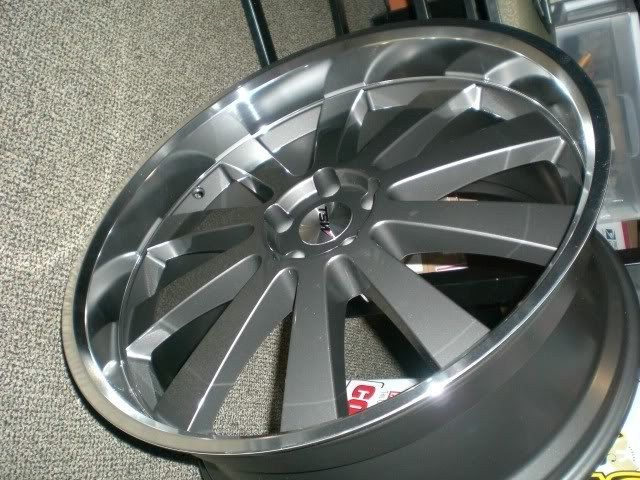

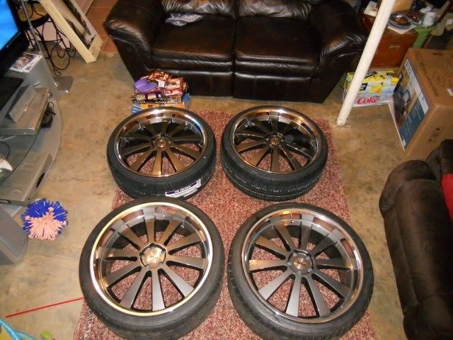

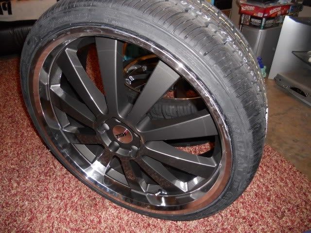

those wheels are awesome! what are they!!!
Crazythingsido2's avatar
Crazythingsido2
there tsw Londrinas 22x10.5 with 285/30/22 in the back and 22x9 in the fronts
