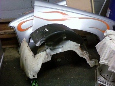

heres the ones in my 96 the pic of it out of the truck looks ruff but actually in the truck looks good, factory wheel wells with the top cut out and trailers welded into the top, hope it helps you can kinda get what im talking about in this pic

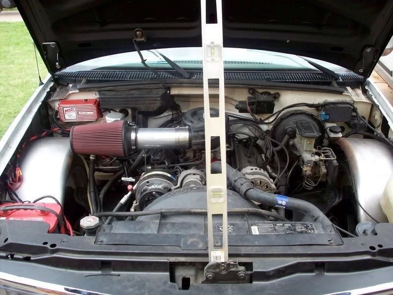

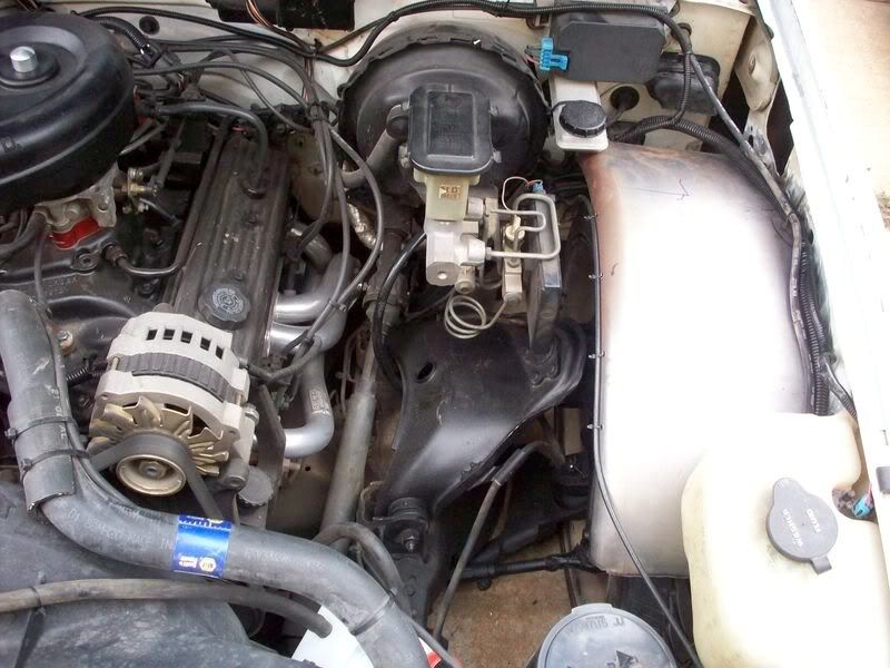

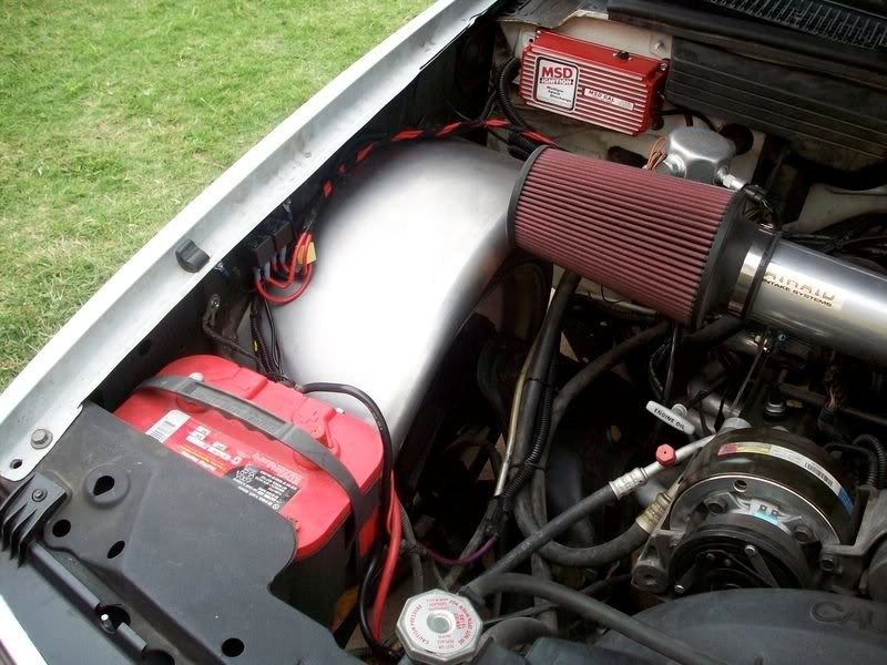

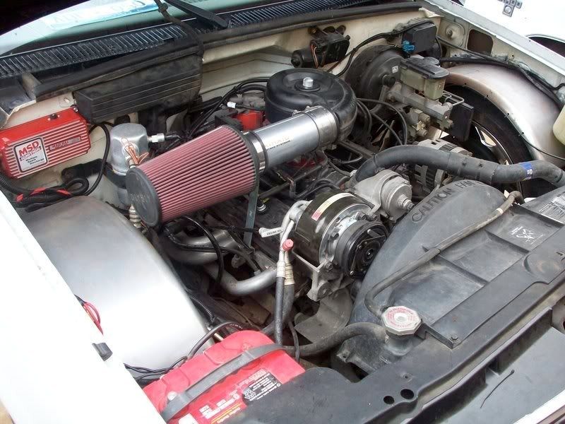

That was a 91 i did awhile back
