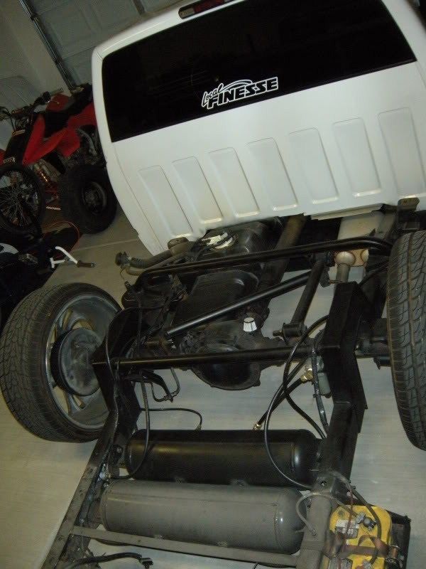

Best thing to do with a full size is a wishbone 3 link, that way you can keep the stock gas tank location.

marcos did you have to build a new gastank crossmember to connect the 3 link to

You don't have to, I would just add some bracing.
Marcos_65's avatar
Marcos_65
And sorry, thats not my truck, thats Damien's.  Azdragginsoon is his name on here.
