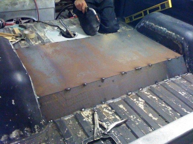

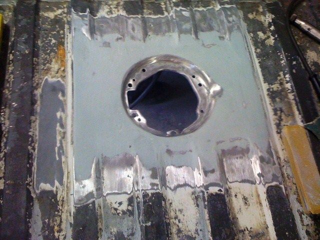

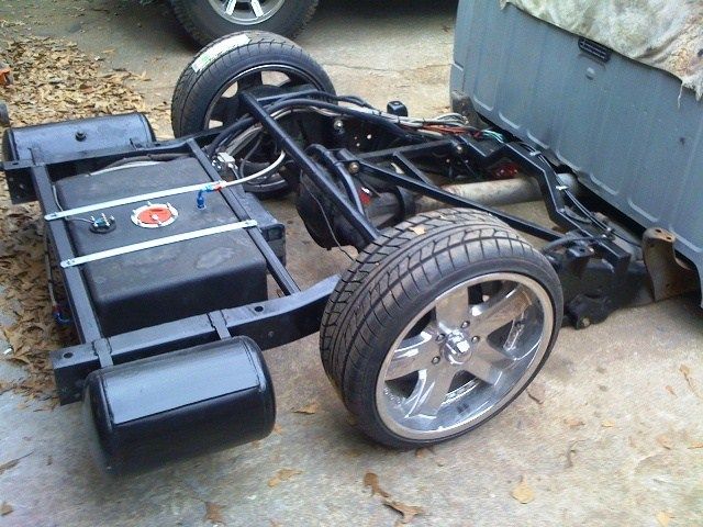

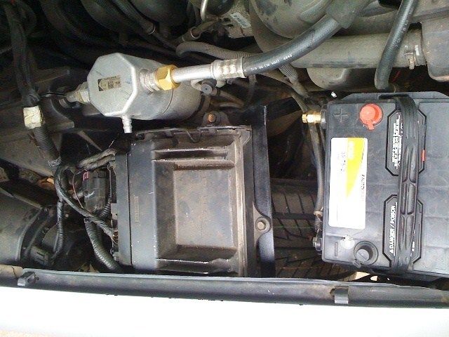

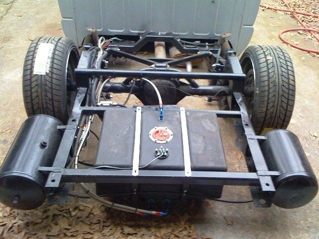

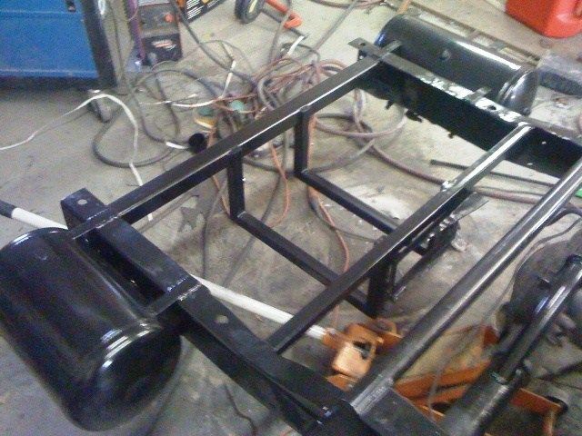

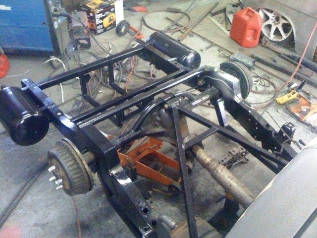

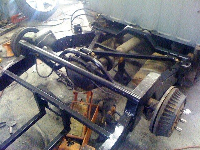

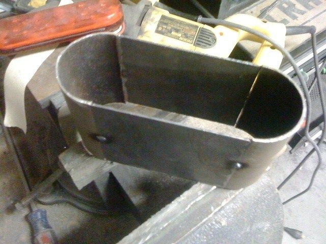

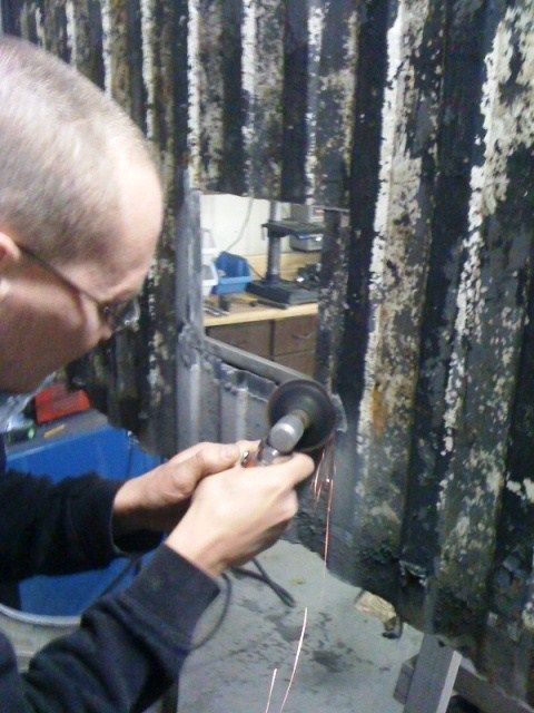

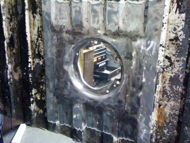

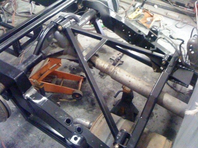

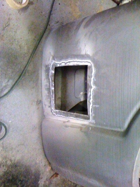

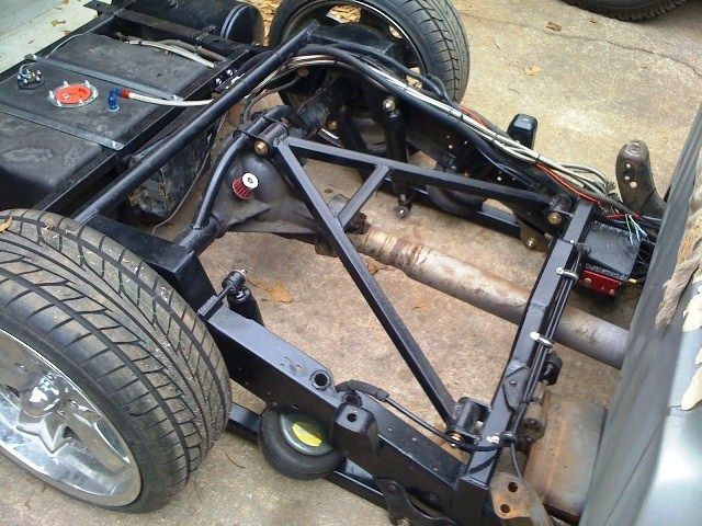

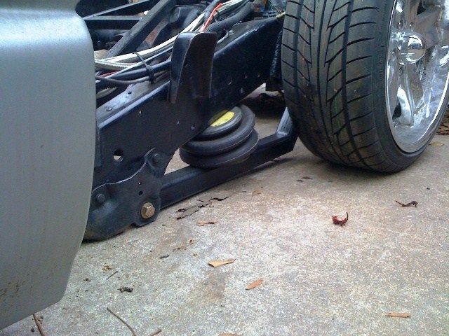

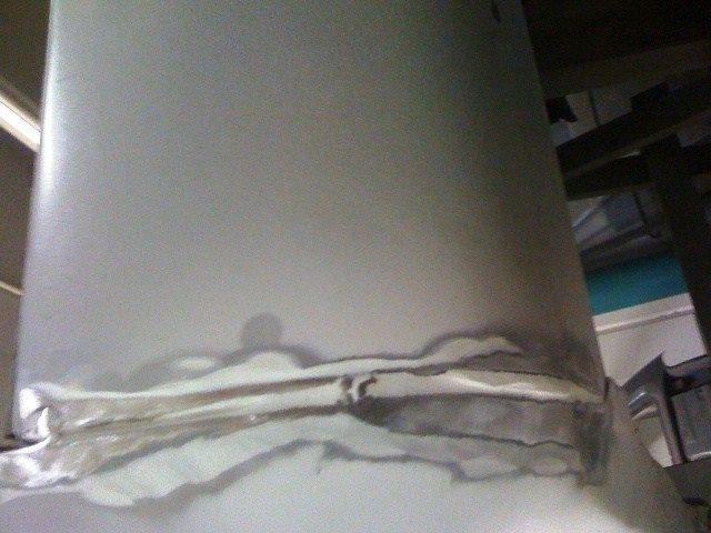

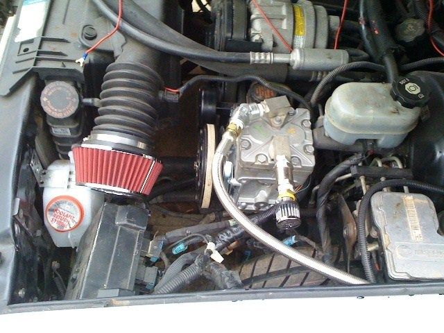

We are currently fixing a 2001 S10. We will be redoing all of the suspension and have a bodywork completely ready for paint when it leaves.   Spring pocket was cut wrong a caused a tear in the frame  Another hacked spring pocket cut  A/C box was not reworked so tire rubbed hole in box another spring pocket pic  New front cross member going in  Fuel cell cradle being fabricated   Shane laying down them dimes on some previously bad welds  Fuel fitted into cradle  Another Fuel Cell pic

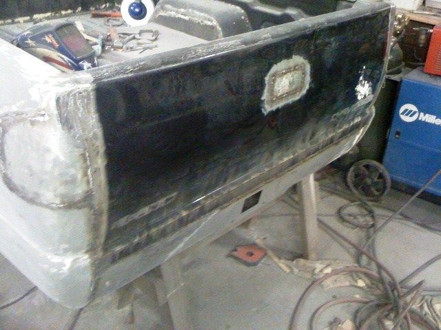

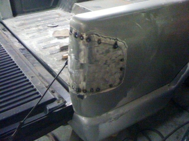

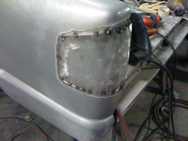

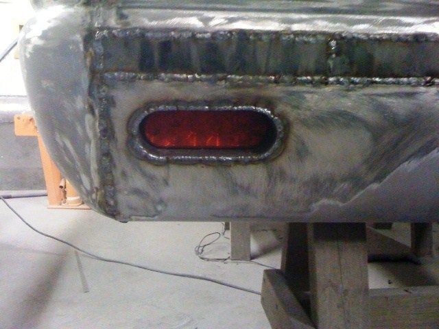

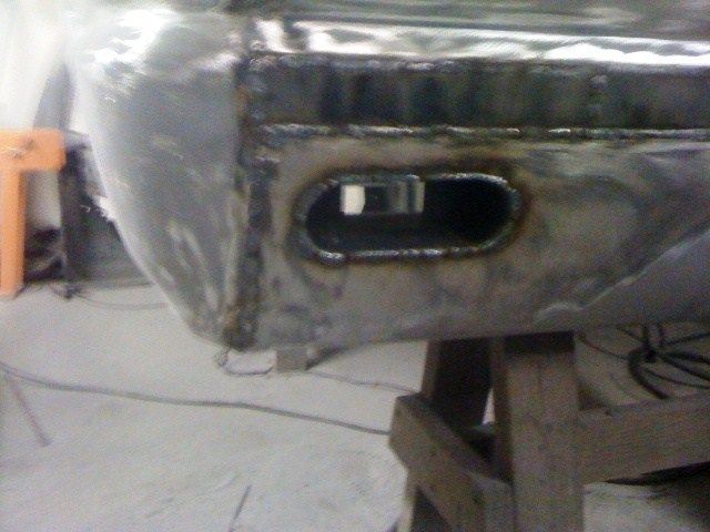

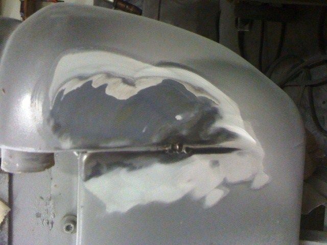

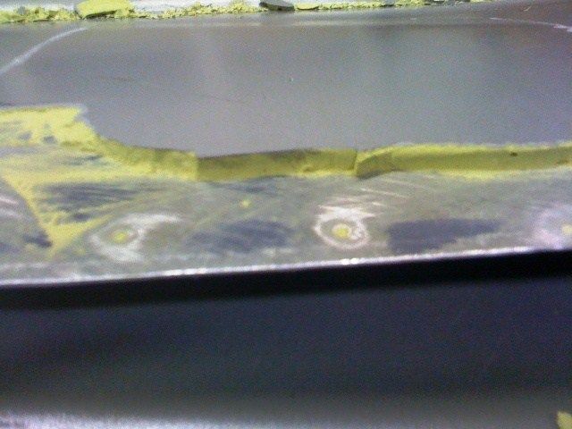

       Bondo was over 1/4" thick on most of the bed   Handmade tail lights fillers    The rollpan was held on by three tack welds and bondo  Another shot of the tacked on rollpan and the over 1/4" bondo again  they filled a tear in the bedrail with bondo  Rear end welded  up and ready for bondo and blocking  Handmade tail light buckets   Tail light buckets welded in solid  LED tail lights test fitted

Everything is looking good man. That "tear" in the frame isnt a tear tho, they just cut too far and went past where the two pieces of metal join.
