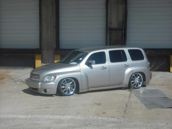

My friend wants to bag his hhr and after reading garagebuilt's thread, air struts kinda look like a pain in the ass. And my friend won't even consider juicing it, he's determined to have bags.
garagebuilt's avatar
garagebuilt
yeah i thought about doint upper arms but there is only enough room for 6" uppers which wouldnt work. now that mine is done i actually dont mind the mac struts cause the camber isnt too bad. if you dont care about it laying out in the front, the new airlift struts get pretty low. i think if you made a spacer and moved the bearing and mount to the top side it may get real close to laying. here is a pic of an hhr on them
