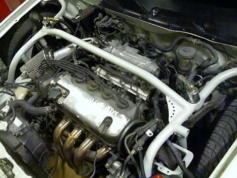

 You really should use tubing like everyone is saying......but for fucks sake your not going to die using it for some upper link bars on a mini... Im not saying you should go out and buy black pipe for structural use....just use your head on what your using it for. And just to throw it out there....i built this front sub frame on my old civic....from pipe. Daily driven on juice for  a year before i sold it!
