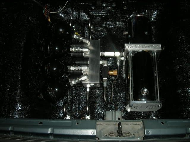

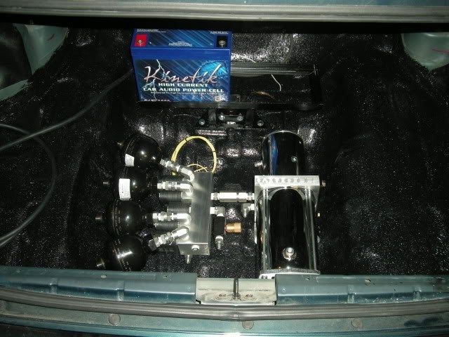

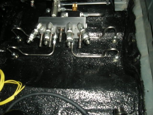

Another install, this time a 98 body style 2 door civic. This car is getting a 1 pump, 5 dump, 4 accumulator and 2 Kinetik setup from http://www.hydroholics.net/.
Here is what is done so far...
            The trunk has recieved the Herculiner treatment and the battery rack (with solenoid mount) is mounted in the car.

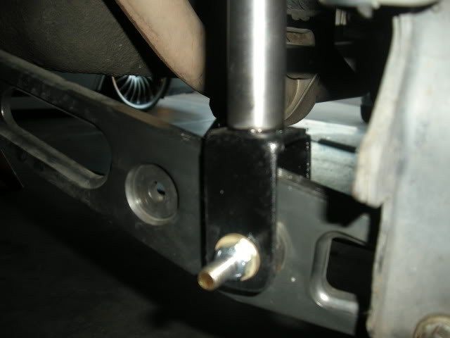

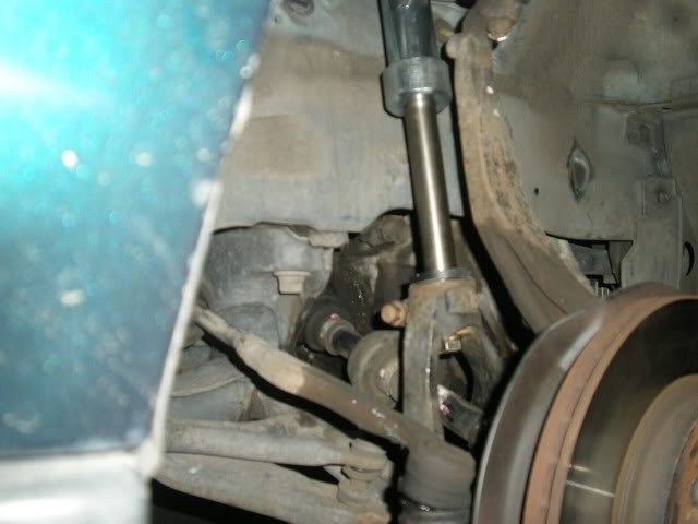

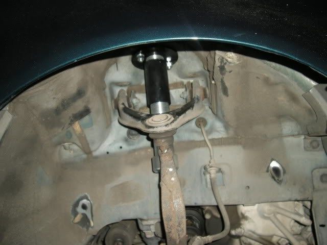

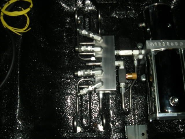

The setup, plumbed together and awaiting hardline.The waterjetted upper doughnuts made to bolt into these cars are installed.The front cylinder assembly

---------------------------------------------Originally posted by tre5Edited: 1/5/2010 7:26:25 PM by tre5 The setup, plumbed together and awaiting hardline.__________________________ WWW.HYDROHOLICS.NET __________________________ ________________________www.myspace.com/hydroholicsinstalls________________________ ---------------------------------------------should you / do you typically need to support the manifold in a setup like this? i know the valves don't weigh alot, but i didn't know from the bouncing around if the manifold would spin it's way loose, possibly causing a leak.

I have mine setup almost identical to this except I plumbed the accumulators on the bottom side of the manifold so they only sit a little bit off of the floor of the trunk. I din't use a support and I drive my car daily and have never had a problem with it spinning loose or leaking any at all.

---------------------------------------------Originally posted by loudciv_ ---------------------------------------------should you / do you typically need to support the manifold in a setup like this? i know the valves don't weigh alot, but i didn't know from the bouncing around if the manifold would spin it's way loose, possibly causing a leak.--------------------------------------------- Nah, the photos do make it look unstable, but it's actually very strong. Not to mention there will be hardlines connecting the pump/manifold and going into the floor that will assist in any support.  Also I typically put the accumulators underneath the manifold (like this), but I think Jeremy wanted to change it up a little and nothing wrong with that!
