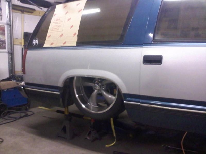

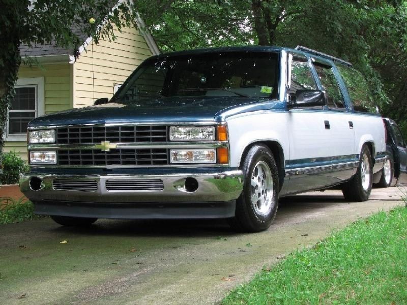

Here's a pic of my old Suburban that Jenni from MT mag and DropEm Wear has now. This was with a 2" spindle and a 3" spring  up front for a 5" drop,  and a flip kit and hangers with a bolt in notch like pictured above in the rear for a 6-7" drop out back.
FADE2BLK94's avatar
FADE2BLK94
but here's what it looks like now...
