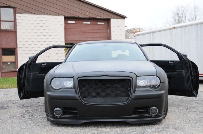

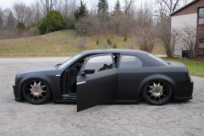

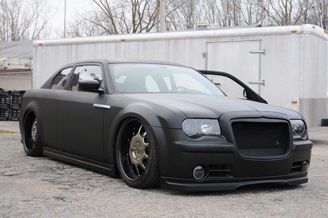

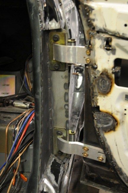

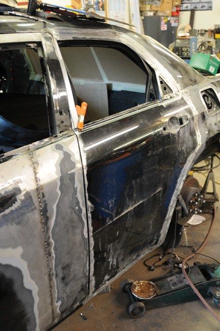

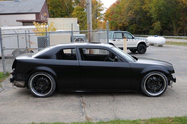

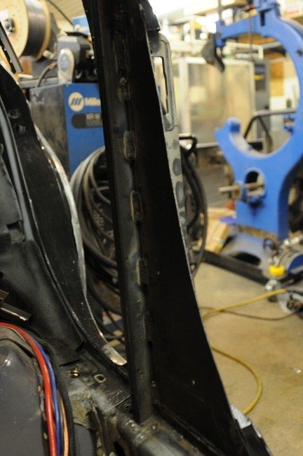

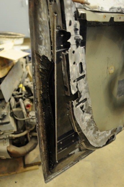

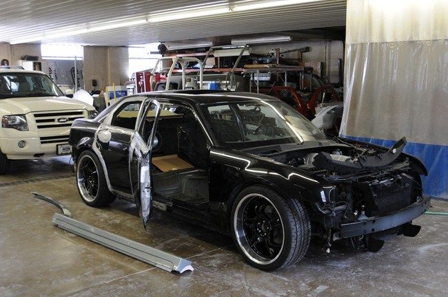

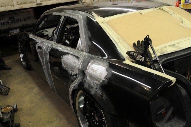

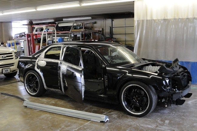

Edited: 10/23/2009 11:19:38 AM by sws4lifeWell, we are getting down to the wire, so I thought I'd start giving everyone a peek at what I've been working on for nearly 2 years now.

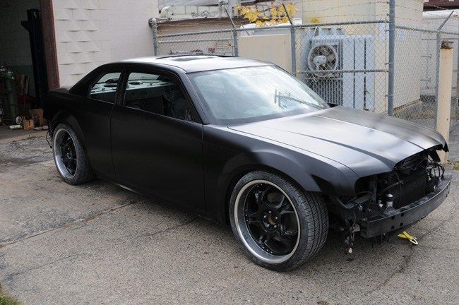

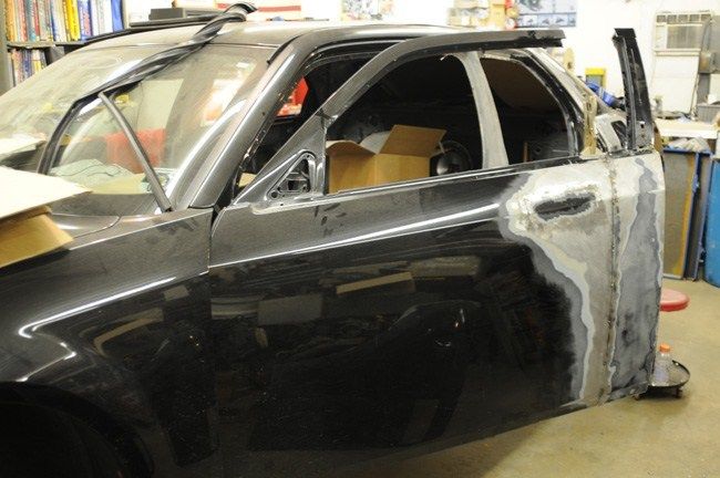

The car as it sat before going into the garage

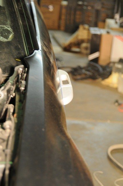

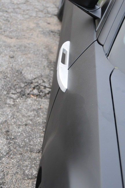

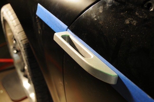

The original idea - just suicide rear doors with RR door handles

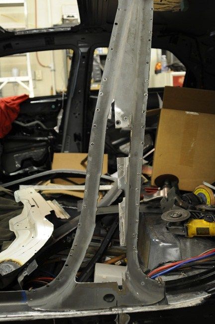

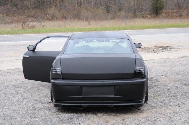

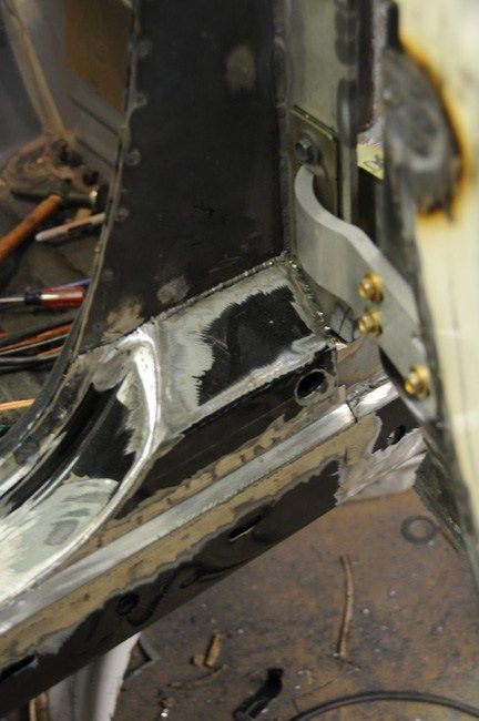

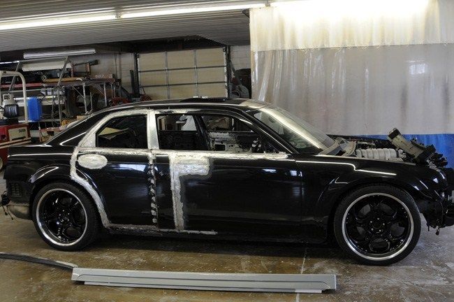

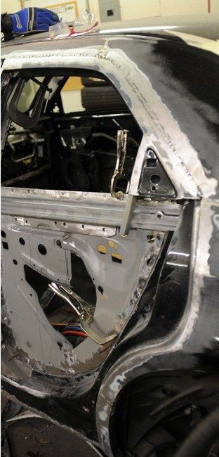

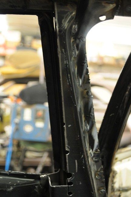

Plans changed just before going into the garage, and here is what we decided to do - cut out the b-pillar

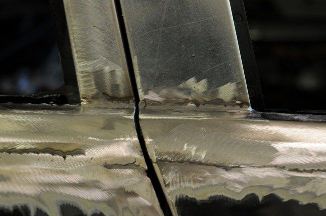

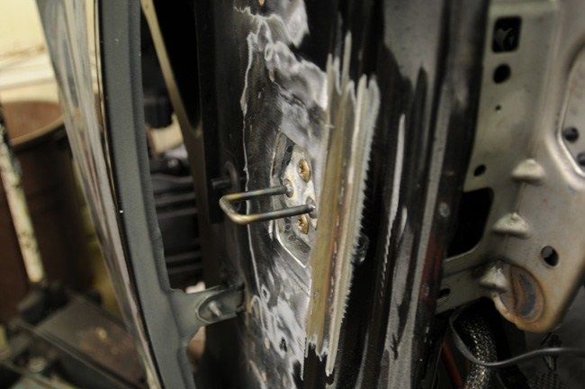

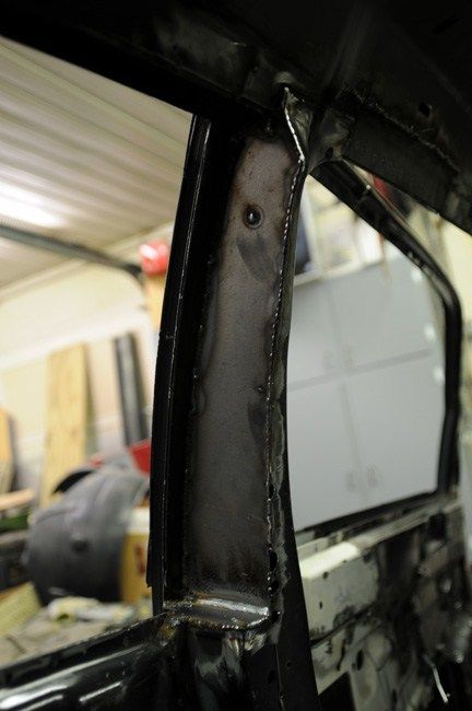

mock up of new B pillar location
won't be needing these anymore

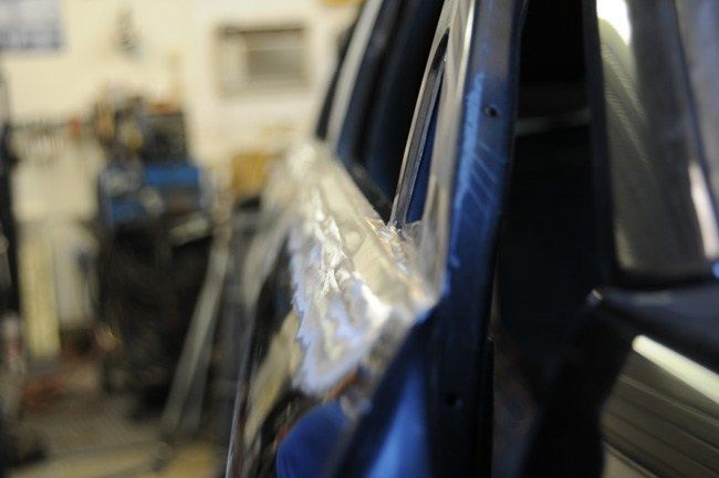

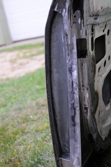

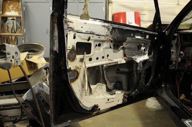

Is it me or does anyone else think this things are too big

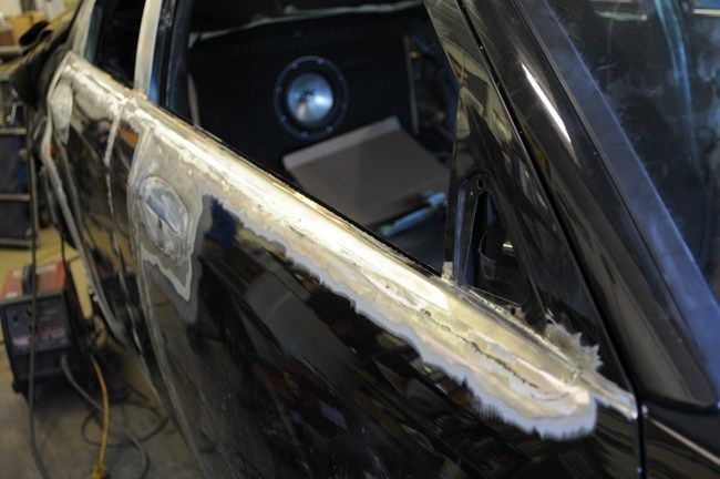

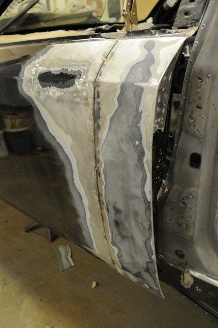

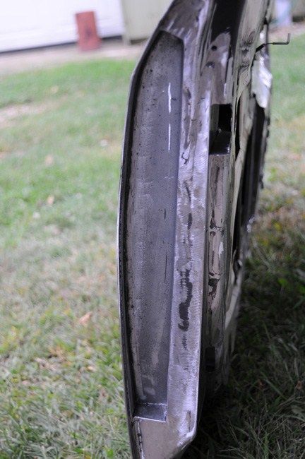

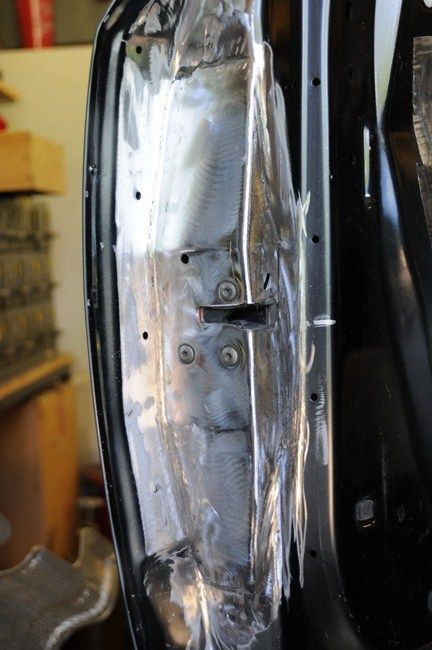

about 5.5" at the top and 6.5" at the bottom when back to back is just to much space between those windows, so we cut it down to 3" on top and 4" on the bottom
and got rid of the need for covers as well as rounded off the corner of the door
Much more to come......

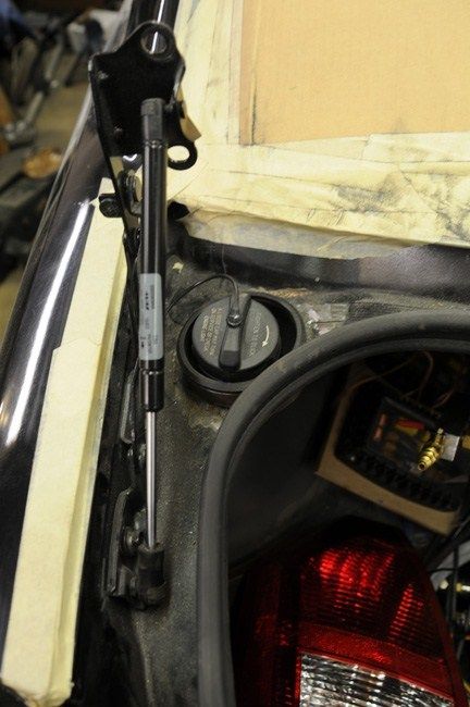

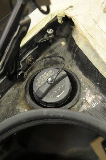

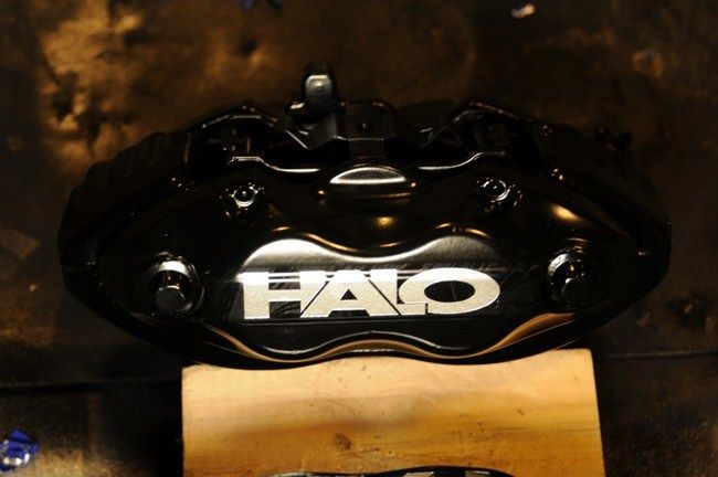

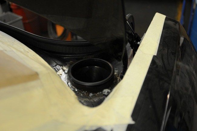

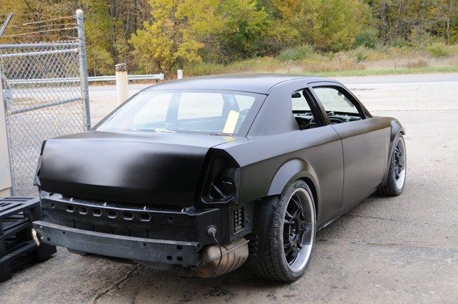

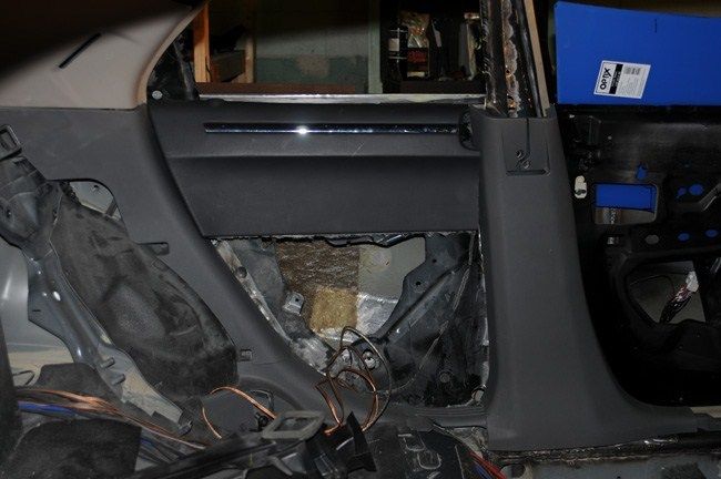

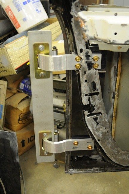

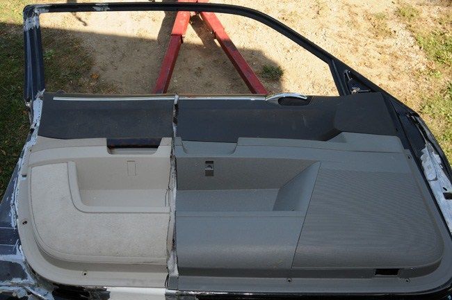

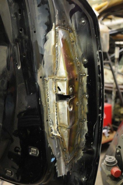

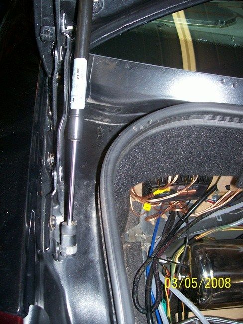

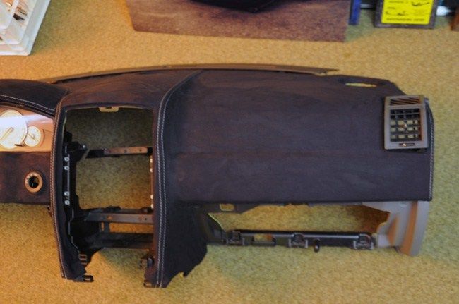

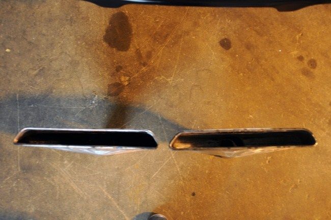

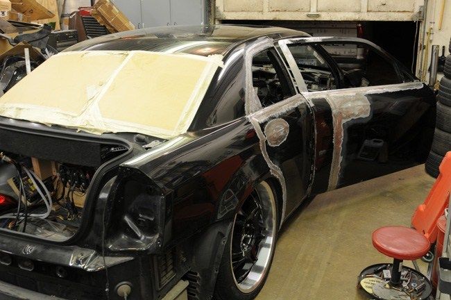

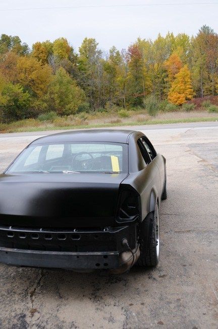

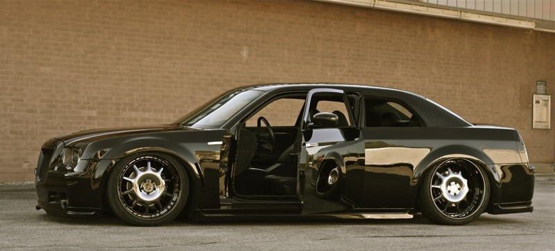

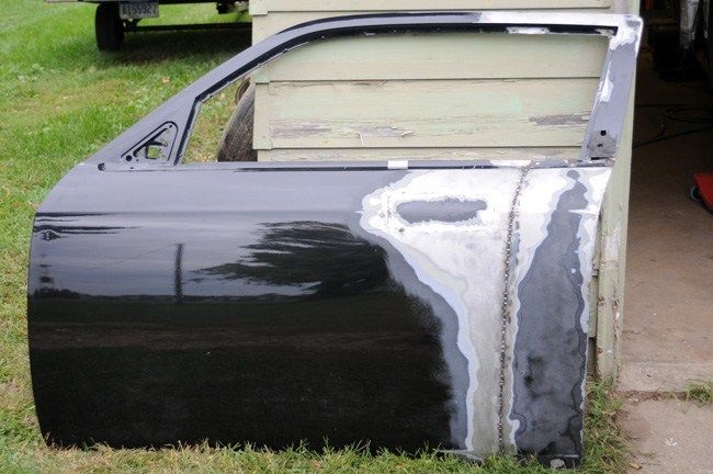

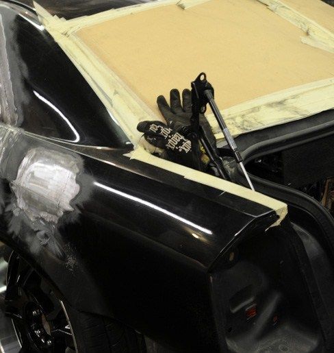

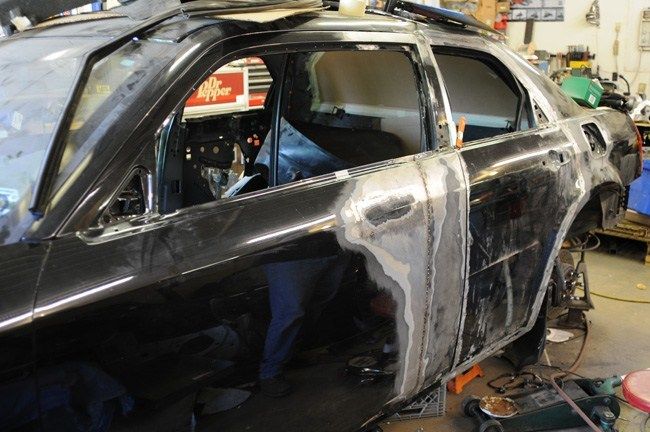

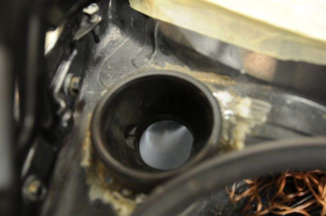

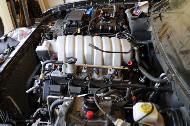

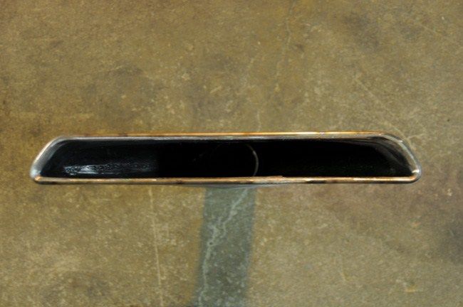

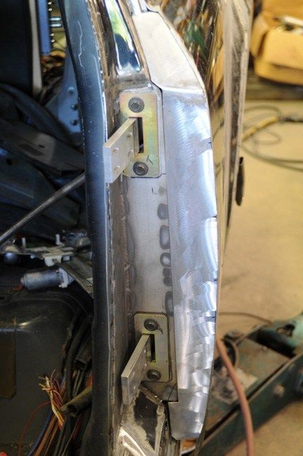

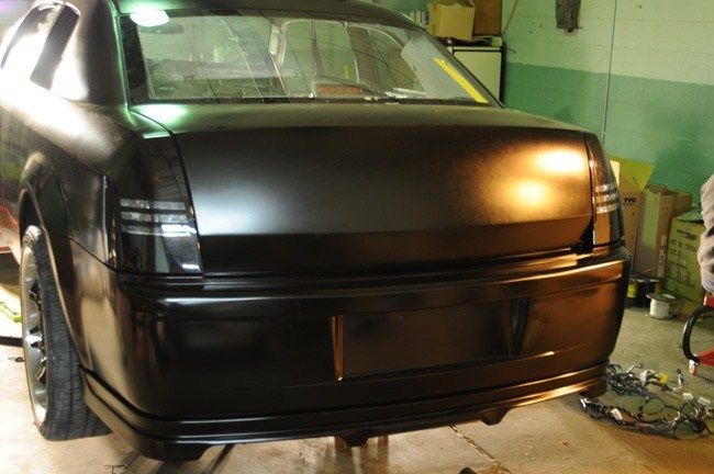

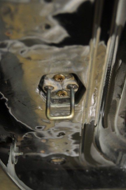

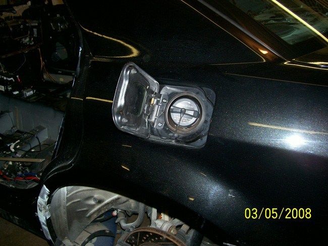

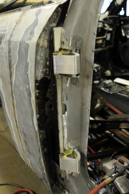

Edited: 10/23/2009 11:37:46 AM by sws4lifeThanks guys, I'll try to post updates every day.I forgot to mention, and the first pic of it is a bit misleading, as I had already did a 300C front end swap, but this started as a 300 Limited 3.5 V6! But now it has a 6.1with a twist(hint - this is where the P in 300P comes into play).Anyone notice this large open area in the corner when you open the trunk?We did, and took thisAnd did thisand put it here and now for the doorssizing up the interior panel
