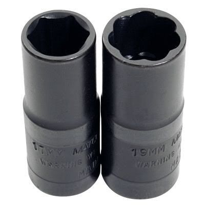

---------------------------------------------Originally posted by DOWNSUBEdited: 10/6/2009 9:04:19 PM by DOWNSUB---------------------------------------------Originally posted by dbldub01no Vinny doesn't look like that---------------------------------------------Is there just four locks ? get you a scoket like this one on the right tap in on there it will come off.--------------------------------------------- thats how we used to remove lugs with no key at the shop i worked at. works every time.
dbldub01's avatar
dbldub01
---------------------------------------------Originally posted by pearldrop  I used to have a set like these. They are not actually wheel locks, the "key" is universal so if you can order a set it should work. But the first thing I would do is try fitting a Torx bit in there.    ---------------------------------------------this is what they look like and every auto parts store the one that almost fit went on the down part of the pattern and would strip it out, I think......so I am gonna try Lowe's I'm sure they will have something
