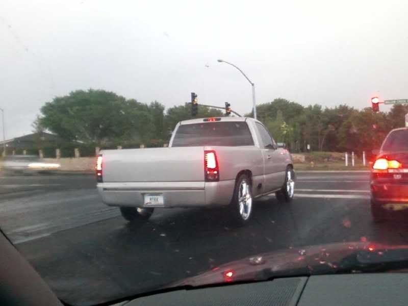

Edited: 9/23/2009 7:45:22 PM by MykkEdited: 9/23/2009 7:41:26 PM by MykkEdited: 9/23/2009 7:38:17 PM by MykkHey Guys, My name is Mykk, an avid custom truck enthusiast. This is my home brewed '04 Silverado. ]    22" x 9.5" +13mm offset, Voodoo 407 rims wraped in Yokohama Parada Spec-X 265/40-22's   For as much "Show" I've tried to equal the amount of  "Go" The engine build has been a fun one, and something unusually different for a truck of this generation. I wanted to do something different, and to see if I could put a performance, carbed GenI engine in a GMT800 still using the trucks original computer for the 4L60E, gauges & creature comforts. 86-95 Four bolt mains, Roller cam block, bored .040" overPatriot 'Vortec' heads, 2.02"Int/1.6"exh valves. 185cc Int runnersComp XR276HR-10, Proform 1.6 roller rockers, Comp 26918 beehive springs Balanced ZZ4 rotating assembly, Speed Pro H345NCP-40 pistons, 10.7-1 static compression Professional Products single plane intake manifoldSpeed Demon VE 650cfm carb " border="0" alt="" /> There is also a 125 wet shot of juice. The rear end houses 4:10-1 rear gears with a Powertrax No-Slip locker.Inside the truck: Our local town hot rod publication showed some interest in my Silverado, and put it on the cover for one of their issues  Here is a short vid of my truck: http://www.youtube.com/watch?v=ITRcJFxZntg  Cheers ~Mykk

Sick truck man! I've seen you driving around town and parked at Tim's... Always liked the truck. Sounds amazing and looks great.
