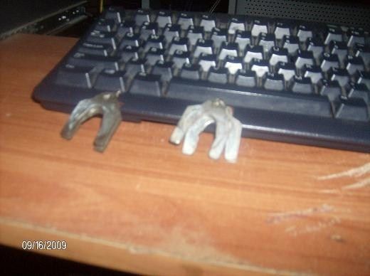

 the bag is fully compressed at 0 psi,and yes jimmy i will give it a try
hrdnissan's avatar
hrdnissan
so i just for shits an giggles un did the top balljoint to see if thats why it was not lifting and that did no good,I know i got psi cuz if i hit the back it jumps of the ground,so im back to L7 1,is it were the baggs are maybe to inside maybe they need to be closer to the spindel...???

what size wheels are u running. the only reason to flip arrms is to lay a 20 or bigger. if not running that big of a wheel theres no reason to flip arms.

---------------------------------------------Originally posted by hrdnissanso i just for shits an giggles un did the top balljoint to see if thats why it was not lifting and that did no good,I know i got psi cuz if i hit the back it jumps of the ground,so im back to L7 1,is it were the baggs are maybe to inside maybe they need to be closer to the spindle...???
---------------------------------------------Closer to the spindle would give you less lift. Think levers and fulcrums.

um maybe its the sway bar. or i dont know if this plays a factor but im not seeing a lower bag plate on that arm and it looks as if the bag is rolling over like when you inflate it its bowing out instead of pushing down but this is all just from looking at the pic

Edited: 9/15/2009 4:16:49 PM by CLNSHVNnDRAGGNThe bag looks like it's mounted fine.  Going off the pic I would say something is definitely binding (most likely the upper balljoint) and the bag is just bowing out like that because it can't move anymore in the direction it's supposed to and the air has to go somewhere.

---------------------------------------------Originally posted by pugzwhat size wheels are u running. the only reason to flip arrms is to lay a 20 or bigger. if not running that big of a wheel theres no reason to flip arms. ---------------------------------------------im running a 20" wheel,

---------------------------------------------Originally posted by dragn168um maybe its the sway bar. or i dont know if this plays a factor but im not seeing a lower bag plate on that arm and it looks as if the bag is rolling over like when you inflate it its bowing out instead of pushing down but this is all just from looking at the pic---------------------------------------------so i thought the same thing after looking at it and moved the top out but at the time it did nothing,so then i put the a-arms back stock and when i did that i saw there were shims at the top pacing out the uca for when it had stock suspenchen to help with camber,i i thought is this little thing whats keeping me from lifting up,so i took them out and it lifted.so at this point i had already flipped the a-arms back to stock so i cant say if that was it but i think it was the shims,and as for the bag i have moved on side and not the other and can tell that the side i move actualy moves the truck up faster then the other side that i haven't moved

is that pic of the bag full inflated?
