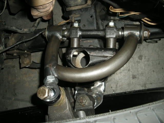

would heims be limiting the steering equal to or more than uniballs? im considering building my own arms using uniballs vertically but if i could use heims for a fraction of the cost and get the same results would be ideal but they seem like they would restrict the steering more than uniballs. OR are there high misalignment spacers for heims like there are for uniballs? similar to this setup below but how would you recommend mounting the heim to the spindle in a vertical position? mount the heim into the spindle then make the arm have mounting tabs? could the heim come loose if its just bolted in?  hydroholics.net deserves the credit for these NOT ME as much as i would like to have built them

thats what I was thinking as long as you put some high missalignment spacers in there I would think there should be enough steering just as much as having a shock mounted up front max as long as I keep the pivot point in the same spot as the factory I should be fine on the front end geometry right?

what size heims would you suggest for the control arms to the spindles and for the tie rod end
