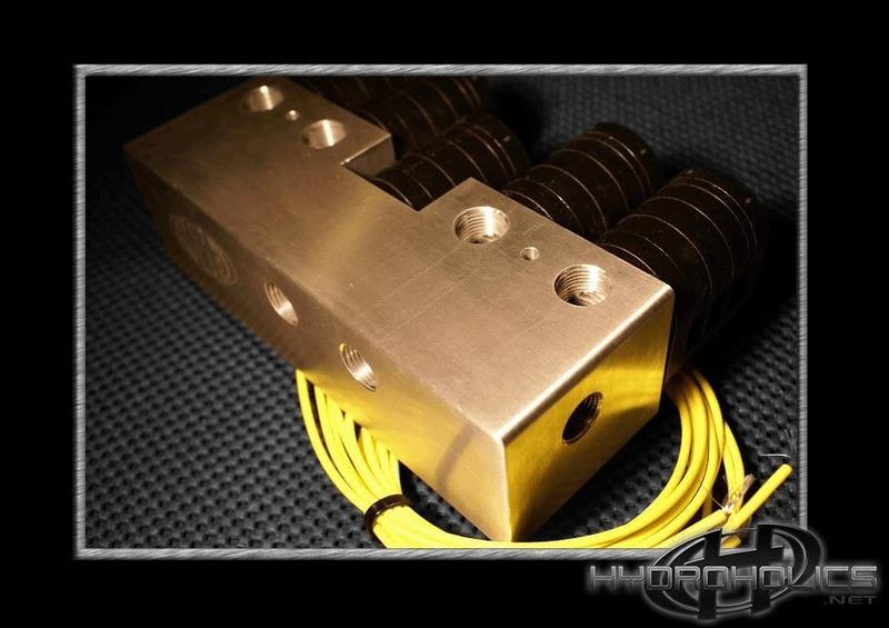

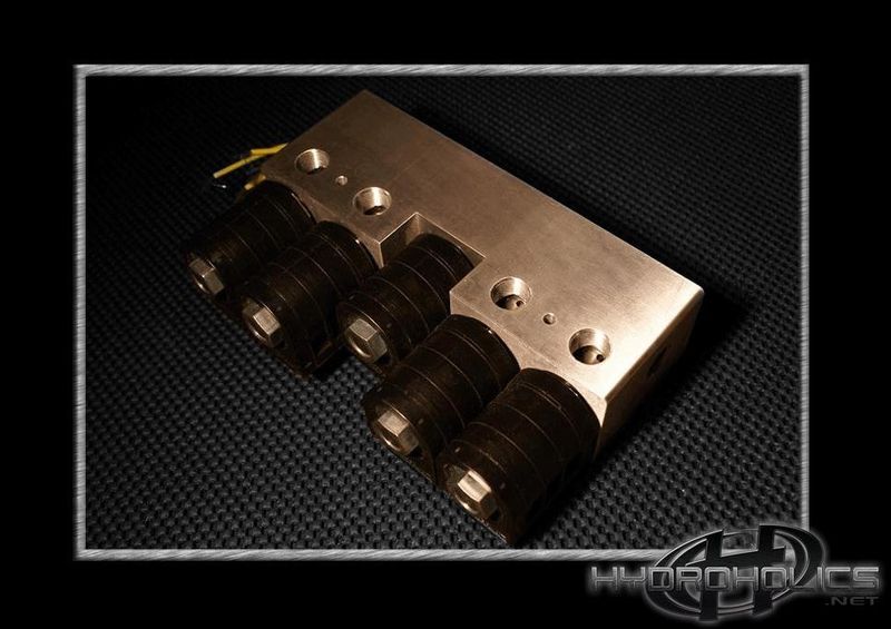

Derek failed to tell you that you can also buy a 5 dump manifold instead of doing it the "old way" with 5 individual dumps.
