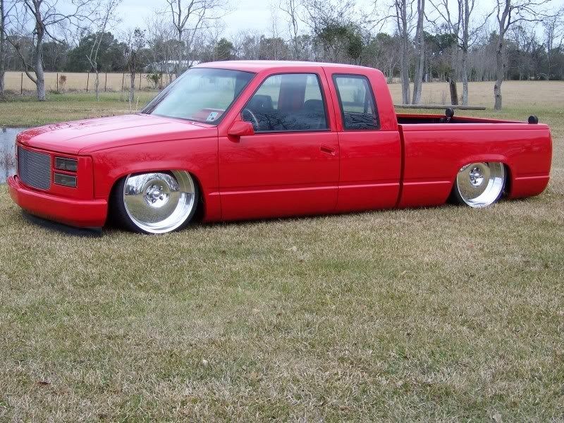

project94
choppin blocks arms are nice. i wish they would have bent them up so you dont have to notch the frame for them because i had to notch mine alot. my stock arms layed on 20's without notching the frame the choppin block arms wouldn't lay on a 20 well with a 40 series tire at least, but they do look good. heres a couple of picshttp://i140.photobucket.com/albums/r11/project94/truck/untitled654654.jpghttp://i140.photobucket.com/albums/r11/project94/truck/untitled4654.jpghttp://i140.photobucket.com/albums/r11/project94/DSC00062-1.jpg I dont have a picture of it plated up but that was cut out to fit 24's. like i said i don't know of a company that makes arms that you don't have to notch the frame for to lay on 24's maybe theres a reason they can't bend them up to eliminate having to notch the frame.  They are nice arms i will say that! One tip, if i had it to do all over again, i would find out if i could get a discount and not have them powder coated and have them leave the balljoints out just because the powdercoating got messed up on mine because the lower arms are kinda a pain in the ass to take off and put back on, but i ended up having to get mine repowder coated, just a suggestion.
