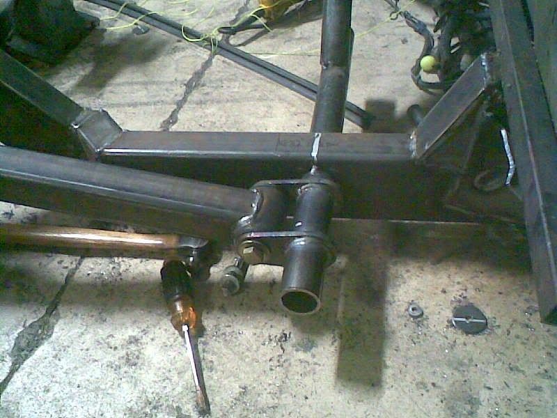

me and a freind of mine just finished backhalfing his fullsize chevy so i figured i would post some pictures and see what everyone thought about it:

thanks! no one else has anything to say? likes or dislikes? what you would have done different?

Looks nice. First thing I would change would be the front lower link bar mounts though (or at least cap them off). Nice tube work though

Thanks! i think we are going to get spikes made to cap the tubes off.

Maybe some super pivots, but other than that it looks great.  I'm backhalfing my taco right now also, so I know how the feedback helps!!

Thanks! we would have done super pivots but the budget was pretty low lol

LOOKS GOOD. I'M STARTING ON MY BACKHALF THIS WEEK. I'M 2 LINKING MINE FOR A SIMPLE DAILY DRIVEN,PRACTICAL SETUP.ANY BETTER  PICS OF WHERE YOU JOINED IT TO THE FACTORY FRAME? OVERALL ITS SEXY THOUGH!!

thanks, this is the best picture i could find:   we ran the tubing up into the factory rails about a foot, then welded it in and boxed everything in.
