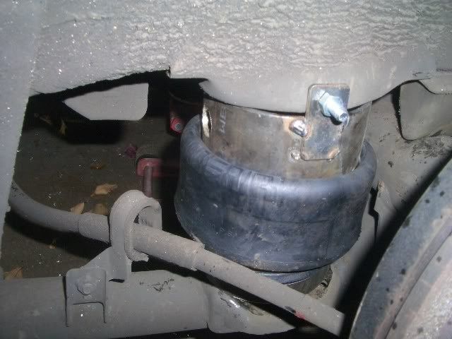

First post here. New member from SoCal. Here&#8217;s a pic of the ride:It&#8217;s a 96 Toyota Previa. Air Bomber air suspension from Japan. 19&#8221; wheels, Junction Produce body kit.3 gallon air tank, manual switches front &amp; back, &#188;&#8221; air lines, firestone bags &amp; compressor, and Cusco shocks for the previa.Pic of similar air suspension set up:Harsh ride, especially on the rear. I run 90 psi on the front &amp; 45 on the rears. I changed the rear bags to Slam RE6&#8217;s but have not changed the rear shocks. I am going to try some Doetsch Tech 3000 shocks. Any suggestions on how to get a smoother ride? How about some type of accumulator, will they help, or just a waste of time? Thanks in advance.<!--ibf.attachment_13476425--><!-- THE POST -->

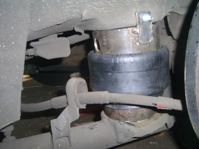

The firestone 2500's I had before barely clears, so the RE7's might not fit.&nbsp; Here's a pic of an install on another previa using universal air "air house" bags.&nbsp;How about sleeve bags, will they work?

Plain and simple... Wrong bags in the wrong application...&nbsp;Slams will not cure the issue. You will probably notice a BIG difference by running the sleeve part, I would suggest the 9100 Firestone parts though. Also, the front end has enough weight to make it tolerable, but once you fix the rear the front will feel bad. It really should have a sleeve style bag there as well. It's tough to tell you change the front bag when it's not that easy, but it is the issue.
