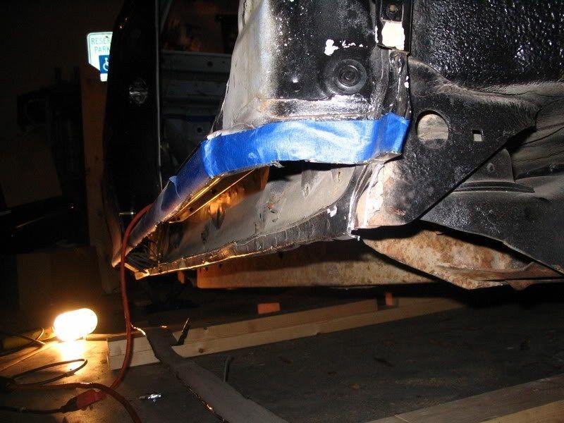

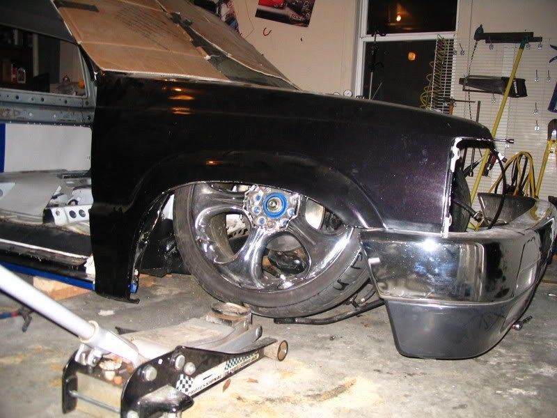

I know I just answered someone not too long ago about the bed floor. so that should be easy to find. I have only traditionaly bodydropped a mazda reg cab. but i can help you with the front end. just cut the bumper/ core support mounts off each side of the front crossmember and lower them and weld them back on. I can get you a pic up here how I did it within a day or so.

There ya go, measure measure measure weld them together drop them down the same as the bodydrop and weld them back on with some gussets added. you will also have to notch the crossmember for the lower radiator hose.     When you do it this way you dont have to mess with the stupid tension rods that come off the control arms.

Also, dont forget to get everything level too, I used 4 scissor jacks because my garage floor is crap. Hope that helps.

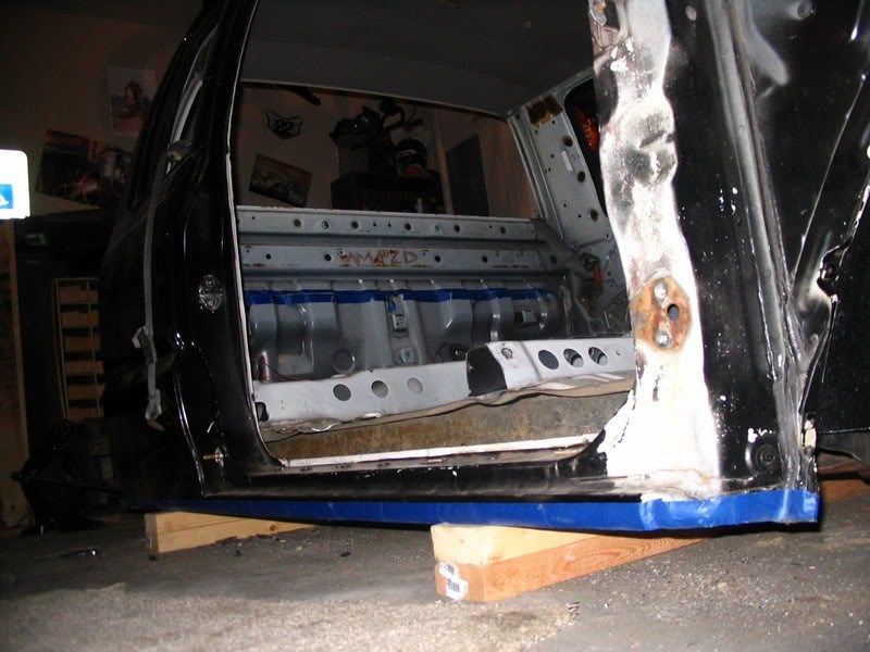

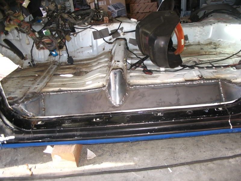

so im hearing alot of guys are doing 2 3/4 inch to lay body but reading some guys are doing 5inchs on their bed why,sorry im really hoping just to channel so i can still keep driving my truck so dont really know how much im gonna be abe to bodydrop this way right nowbut yeah that helps me out so much already gonna be doing it on my hoist but yeah thats my main worry is measure 50 times to cut once haha
deflatd
overdoing the bed allows for a "stock bedfloor" style. just raised up. instead of cutting a hole for notches or whatever.
bodied b2600zx (josh)
2 3/4" would cut into the rocker on Mazdas. . .   Its about 1.5" to the pinch and 2 1/4" to the rocker. . .    I cut an inch out of my rocker, so a 3 1/4". . .  And the wheels are 18s. .   It'll have 20s on it when its finished. . .

I did mine 2.5 inches. That looks real good JOSH
