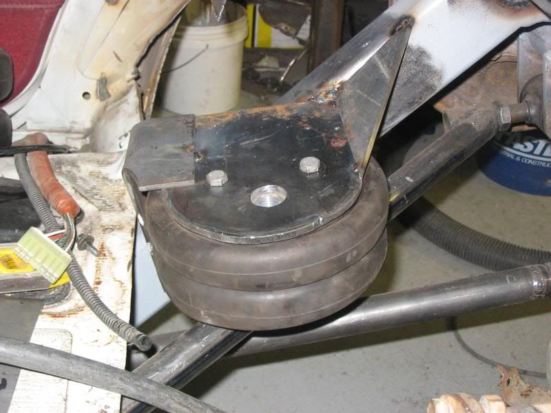

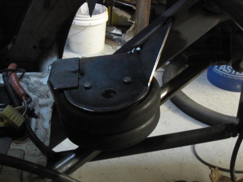

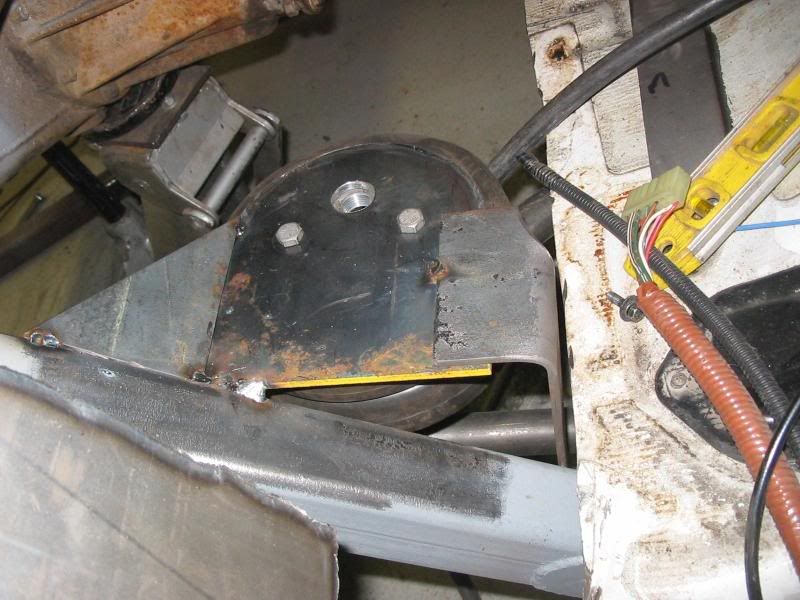

i'm working on the rear bag brackets on my 4runner and i'm not to sure about them, so i'm posting up on here to see what you guys think.
my main issue is being strong enough. the second issue is looks. the first being the priority. right now there tacked up just to get an idea on how it's going to turn out. any suggetions or comments good or bad are welcome.
http://img.photobucket.com/albums/v647/nthnstk/4%20runner/IMG_4230.jpg
http://img.photobucket.com/albums/v647/nthnstk/4%20runner/IMG_4229.jpg
http://img.photobucket.com/albums/v647/nthnstk/4%20runner/IMG_4228.jpg
TwistedMinis's avatar
TwistedMinis
If you plate the back side where it's open, and gusset that area onto the top of the frame, and add a crossmember in between the bag mounts on each side I think you will be fine.
badcoma's avatar
badcoma
thanks twisted i'm planning on plating the back side i want it to fit in with the front barcket so i haven't cut it yet.
