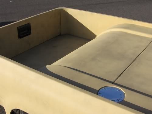

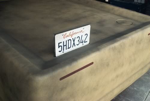

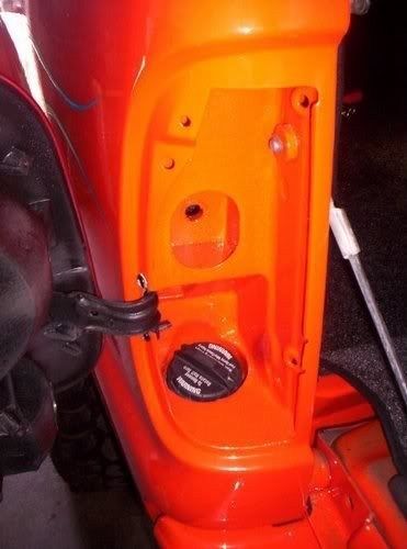

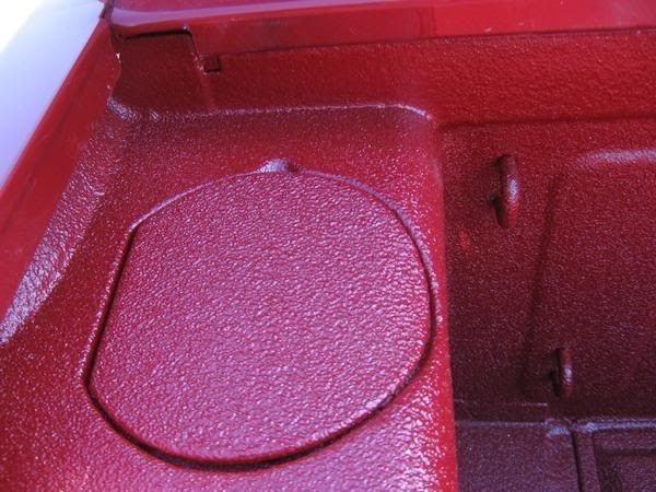

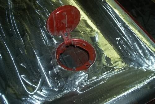

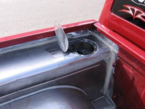

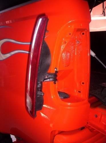

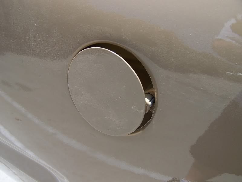

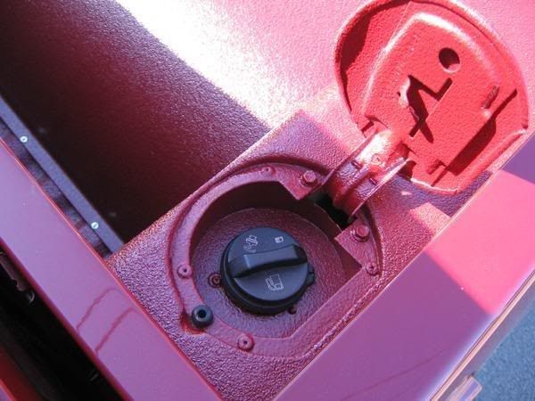

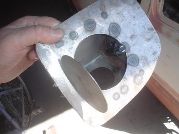

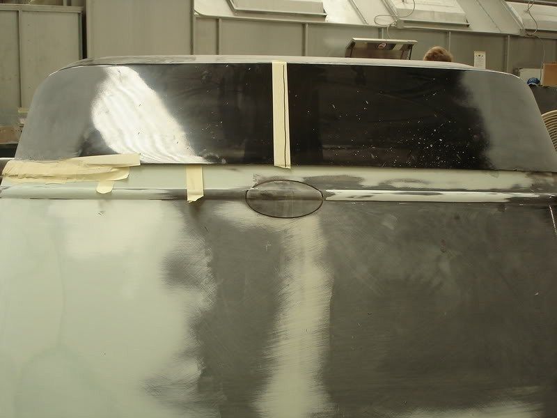

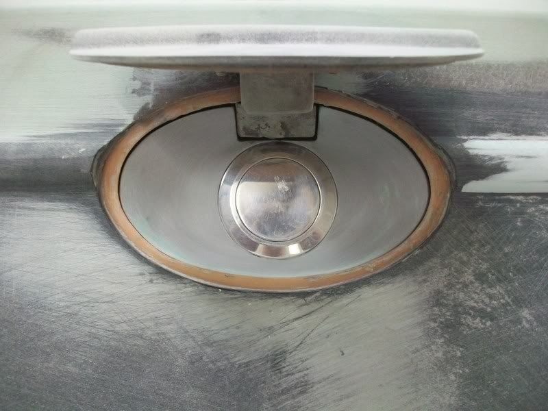

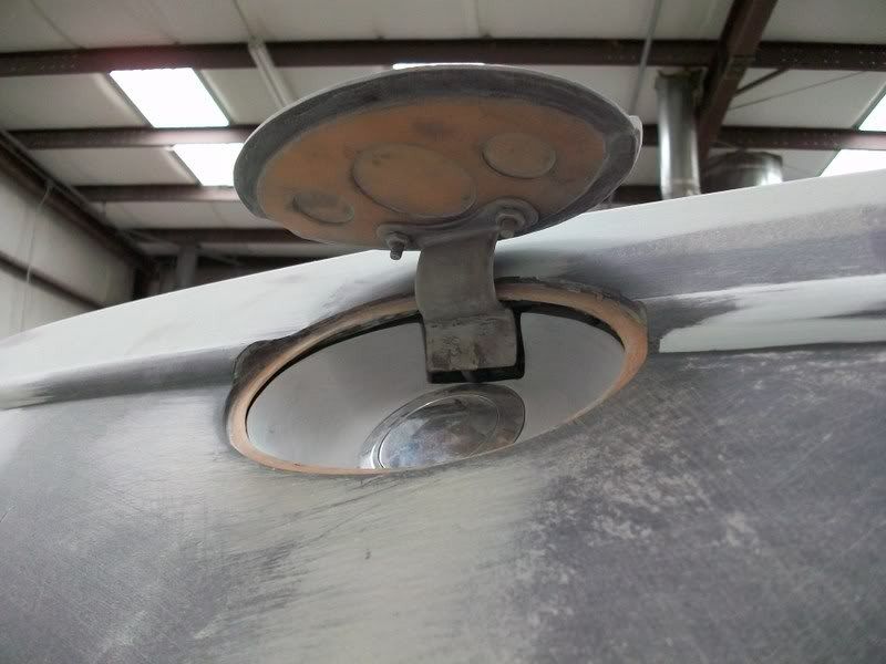

Here's a few we've done. We use stock doors alot, just relocate them.

i like the last on alot. its cool.
I'm curious, with these mounted horizontal, if the truck is in the rain or after going through the car wash or whatever, doesn't the water pool there and end up getting into the gas tank?

sweet. and if you drill a small hole, or leave a bolt out of the filler neck on that flat mount then it should drain out before it accumulates taller than the spout of the tank.

i love gas door behind the tail lights...
