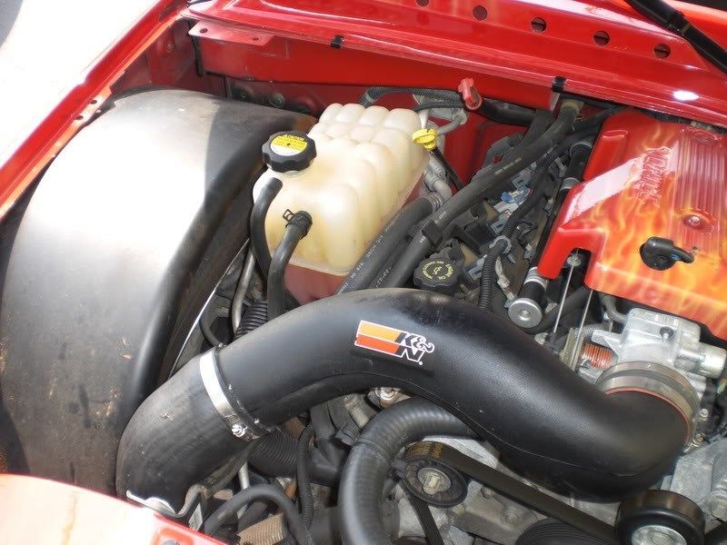

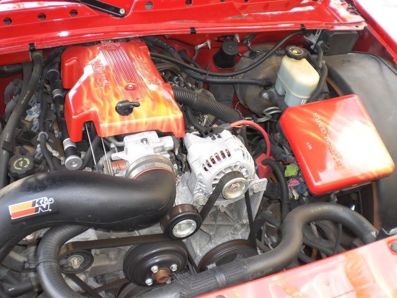

I moved mine up just a little bit and angled them up on each side. towards the fenders. I had to cut some of the plastic off the bottom of the fuse box to clear. You will also need to make a bracket that comes off the frame to hold up the fuse box and one off the fender for the washer fluid tank. I had to cut out the fenders to make it lay on 265-35-22's. you will probably want to raise your gas tank crossmember too just to be safe. If you don't want to raise that get a alum fuel tank from devious....
pdolgner's avatar
pdolgner
Meant to say coolent tank not washer tank.. oops
layingnutz
hope this helps. mines bodydropped on 24's
