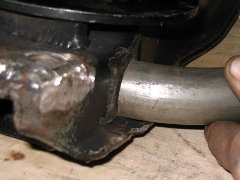

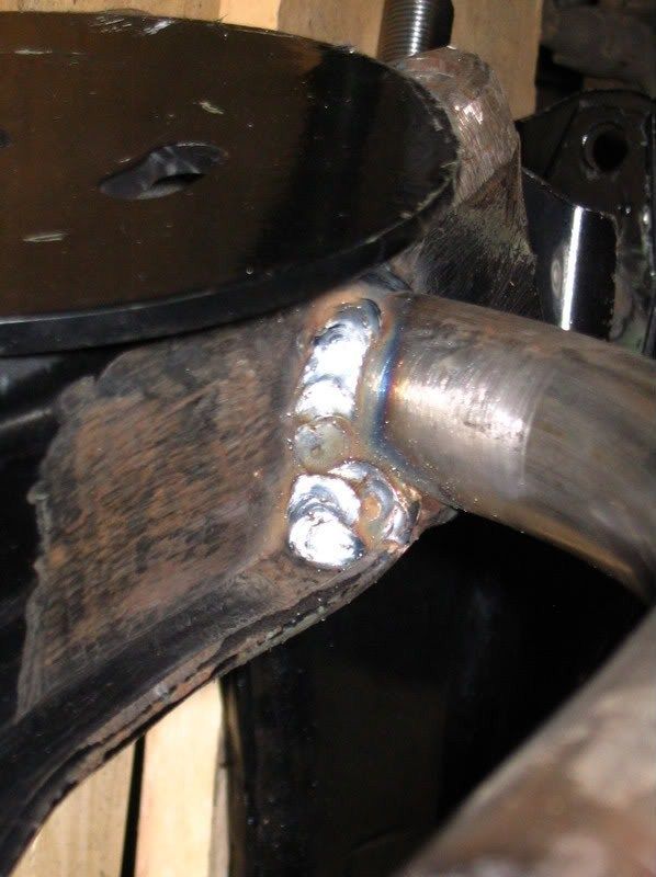

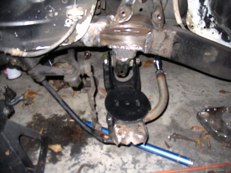

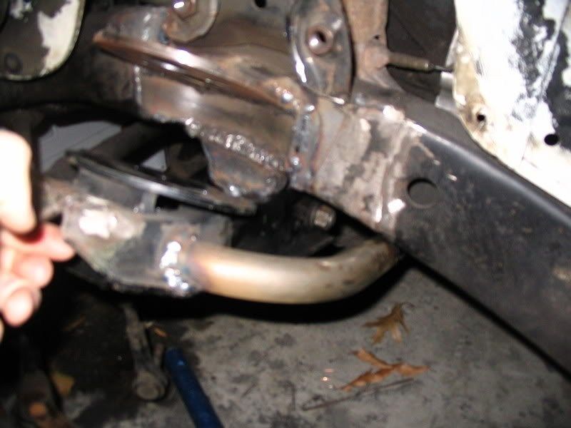

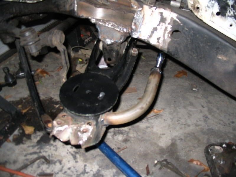

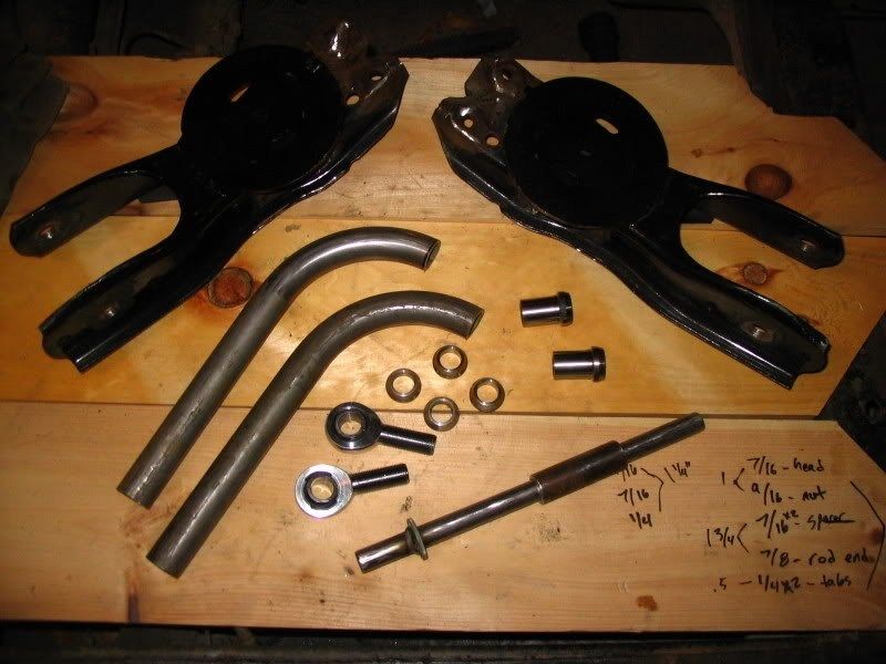

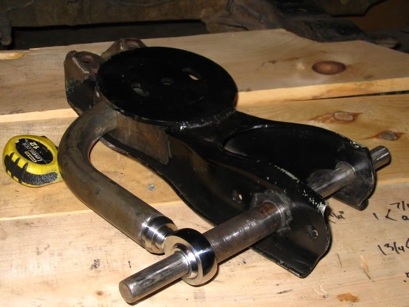

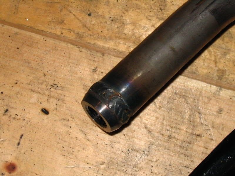

Edited: 1/3/2009 3:15:40 AM by FLGatorsruleWell I finally got all my parts in that I ordered so I got my arms built today. . .  It took jus a couple hours. .  And was quite easy    I got the rod ends from Ballistic Fab if anyone wants to know. .   Let me know what ya think. . .

looks good man, add a cross bar so you can drop some shock tabs off of it then your golden.
bodied b2600zx (josh)
Ya. .   I was plannin on it
bikerider
wot size tube have you used
