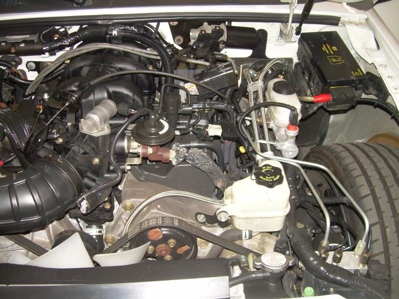

Not a ranger but same ish

how hard was the hydroboost swap status?
minitrukinranger's avatar
minitrukinranger
^^^Easy^^^^ lol
stumbledin
raise it up close to the hood. some of the wires have to be lengthened.
STATUSPITS's avatar
STATUSPITS
Yea it was pretty easy

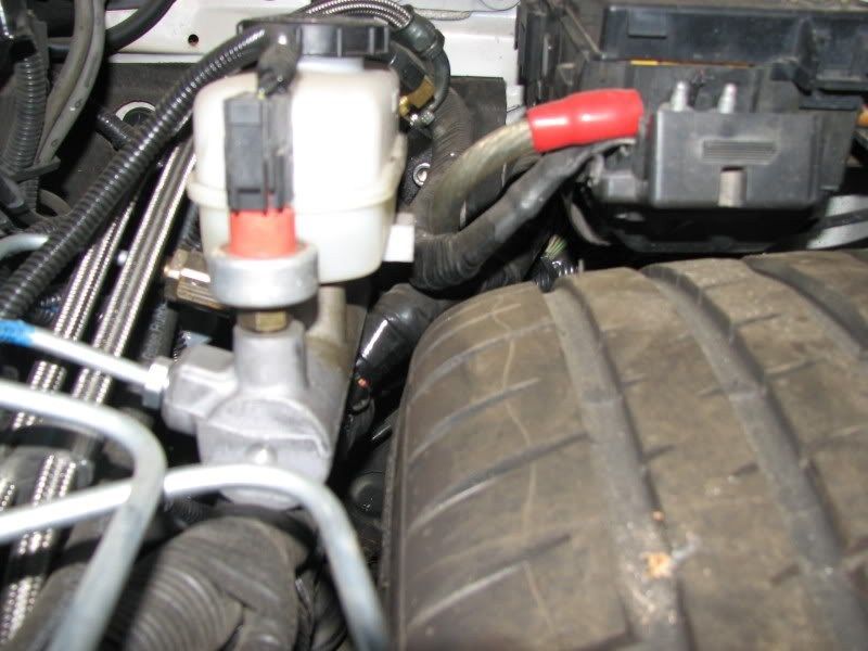

I also swapped out my stock master cylinder to one from a navigator
the navigator one has the brake lines on the opposite side so they clear the tire.
