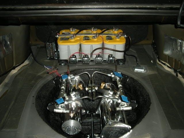

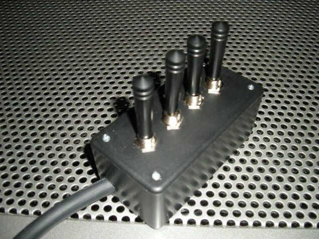

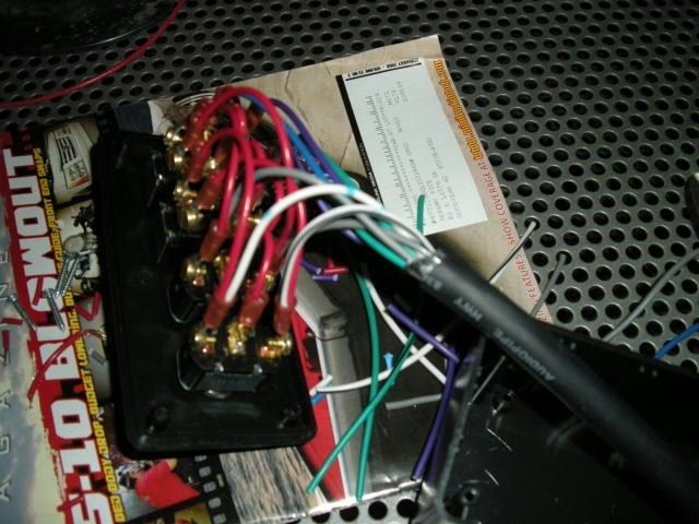

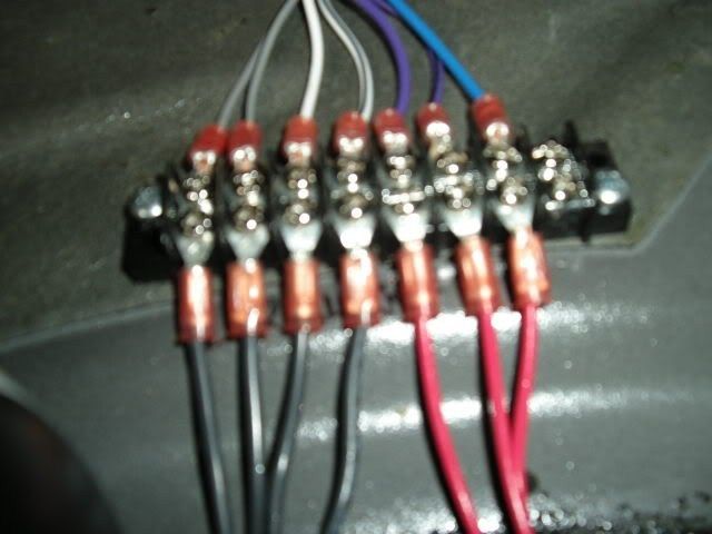

I noticed you're using two 3-prong switches with two wires on each prong (except on the power).
What do those 3-prong switches control?
Just curious as to why you didn't use four 6-six prong switches??
I thought about wiring some 3-prong switches the way you did but I thought I would run into problems.
tre5's avatar
tre5
the switches are wired, frontand back are 6 prongs, the 3 prongs are wired per Rudy's request. Corners. So the middle is obviously power, hit the switch one way and it drops the left corner and hit it the other way it drops the opposite corner. One switch does front, one switch does back.

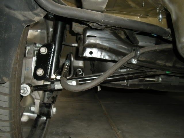

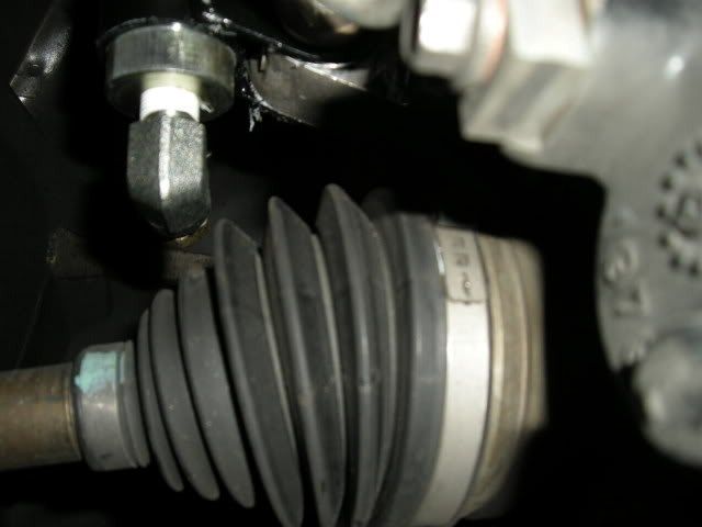

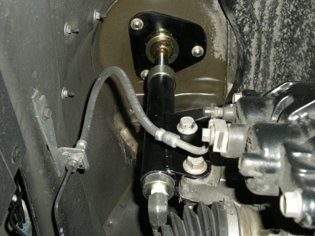

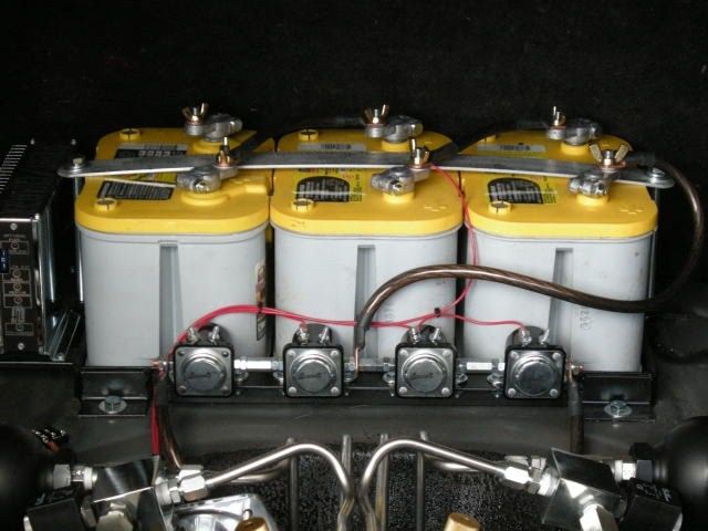

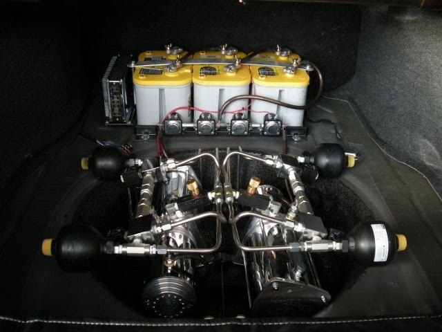

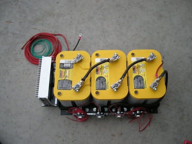

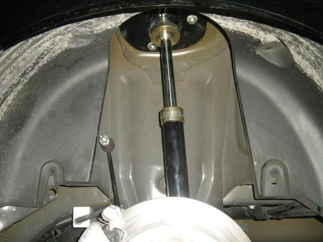

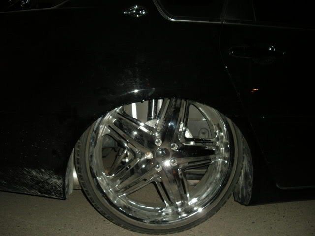

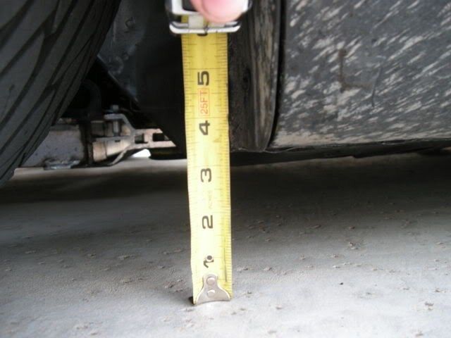

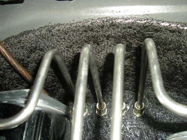

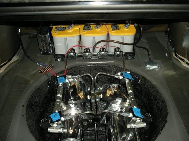

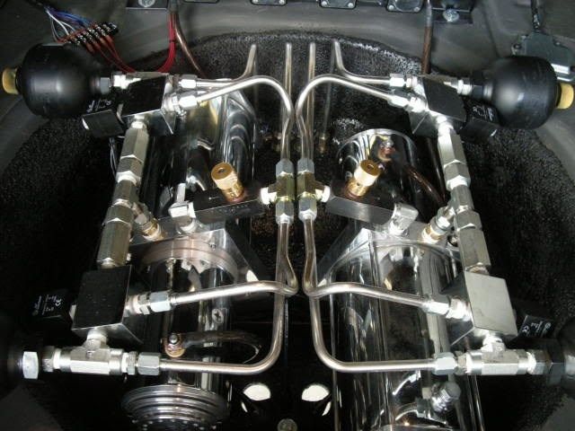

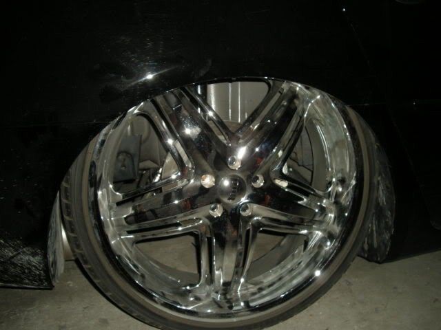

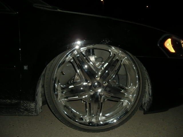

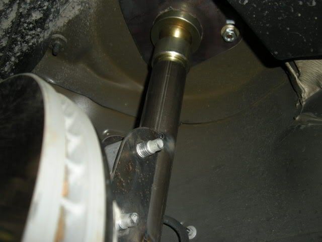

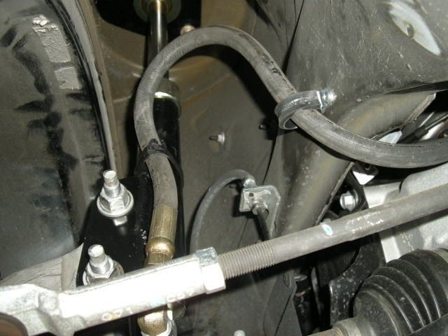

here are some pics from tonight. I will get some better ones tomorrow.

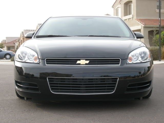

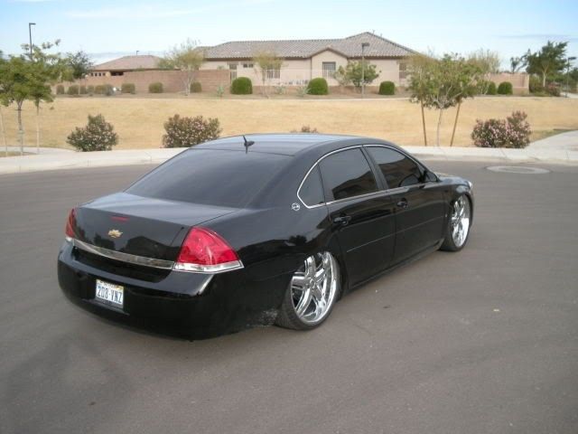

oh, you wanted to see the car????????????
tre5's avatar
tre5

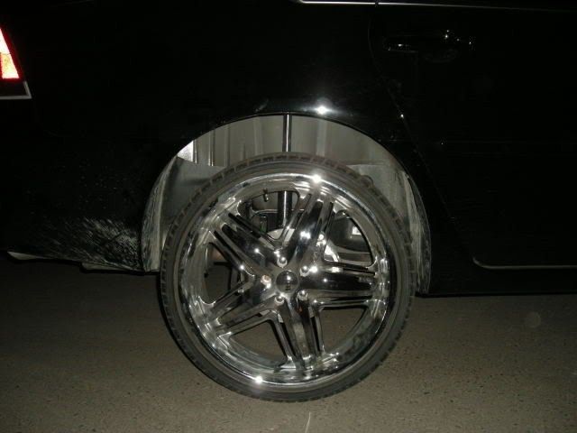

darn, I still forgot the car, heres the best I can do for now. We ran into some issues when we went to juice it up, so we couldn't make the BBQ. Sorry about that, we tried...
mista337's avatar
mista337
Looks good man!
What were the issues?
AON-OFFDAHOOK's avatar
AON-OFFDAHOOK
We ran into a couple of minor issues, one being that the spline keys were "invisible." Once David Copperfield made them reappear that made everything better.
These crappy night pictures don't do the car justice at all.
