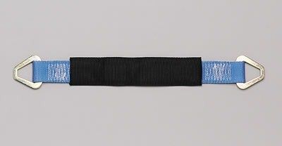

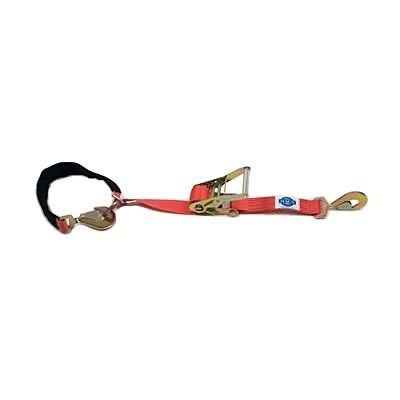

either way. it just depends on if your strap is long enough. I have 2 short straps and 2 long ones, so I actually do it both way, just make sure your metal ends don't touch the wheel in any way. Also, they make some short straps for this reason with a d-ring on each end, about 18 inches long.

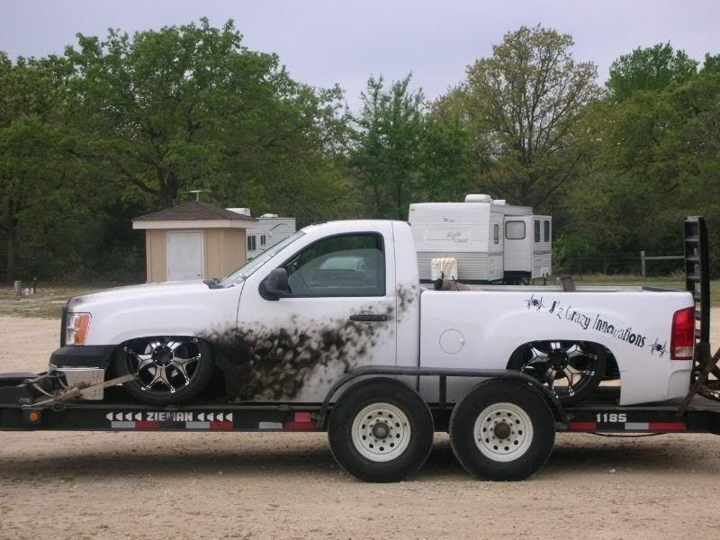

I always lay my truck out...with the wheels i have on it now im not able to loop the straps through, but i hooked my straps on the front of the frame and went through the bumper cover, and then off the axle in the rear.....
and let the hate begin, but i used some tiny ass tie downs... heres a pic.. but this was going to blood drag and the truck didnt move an inch..

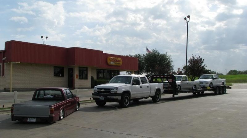

ya my 3 car we just loop around the tire/wheel and then down to the channel on the side. but it was not my cars
