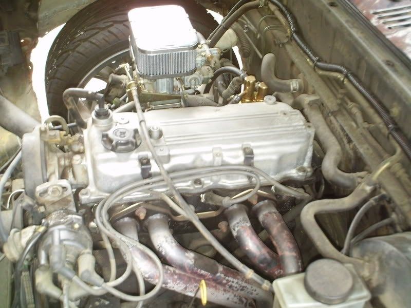

Switch to a weber carb.If you remove the vacum lines from the stock carb it will put it into a limp home mode and run extremely rich.It will cause lots of problems and run like crap.The vacum lines are not for emissions it is a feedback system similar to fuel injection.Switching to a weber will allow you to get rid of the wiring harness on the passenger side wheel well.Here's a couple of pics.Sorry it's so dirty.

How much does that carb run$$ I can't tell by the pic but its not taller than stock is it? And where do you get one? I was hopeing to use the stock air cleaner but if I have to I will just pick up the webber.

You can get one brand new for $250 from weber carbs direct.The air cleaner is no taller than stock.
