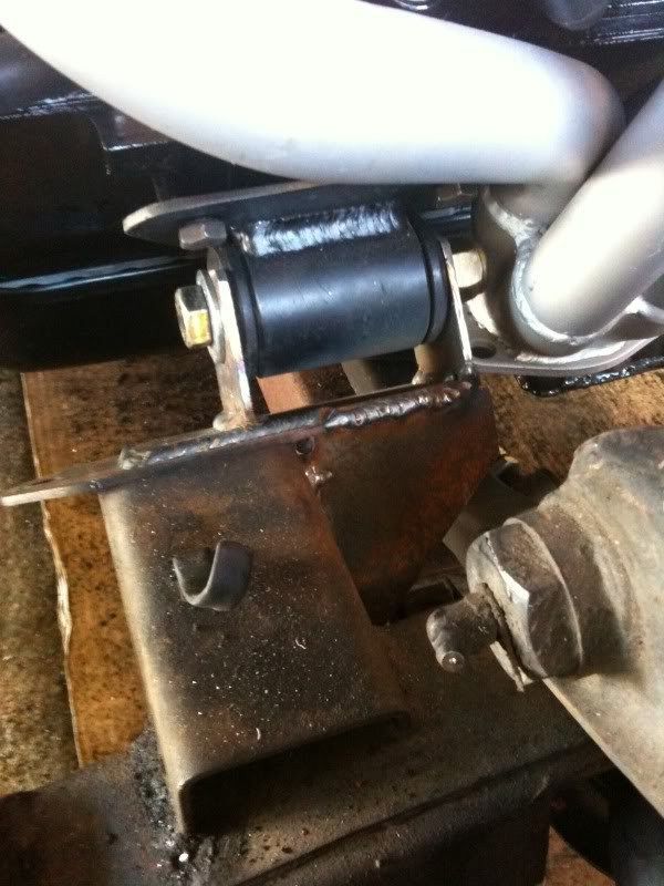

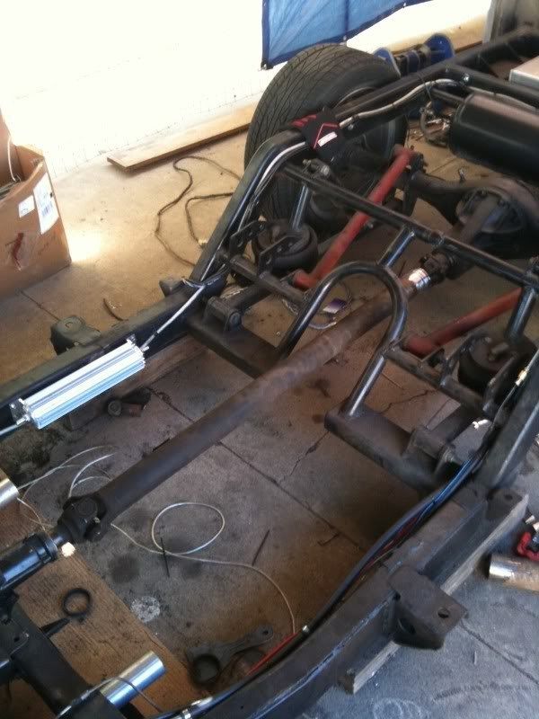

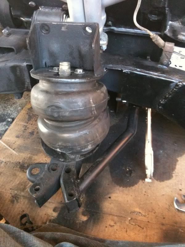

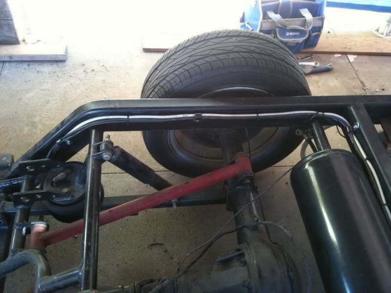

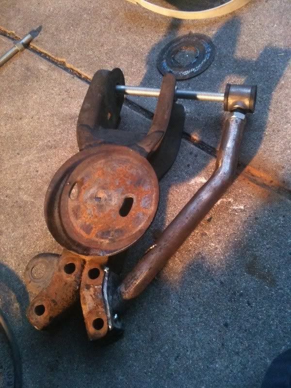

Triangulated arms
Drive shaft done

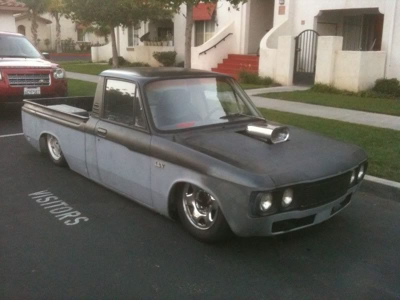

LOOKS SIKK AS FUK...GOOD JOB
waynehammer's avatar
waynehammer
Thanks alot. I can't wait to drive it
sebass's avatar
sebass
WHAT WHEELS R GOING ON THIS?
waynehammer
I'm not gonna worry about wheels until I do my 5 lug swap. But I was thinking rally wheels or some cragar 5 spoke wheels

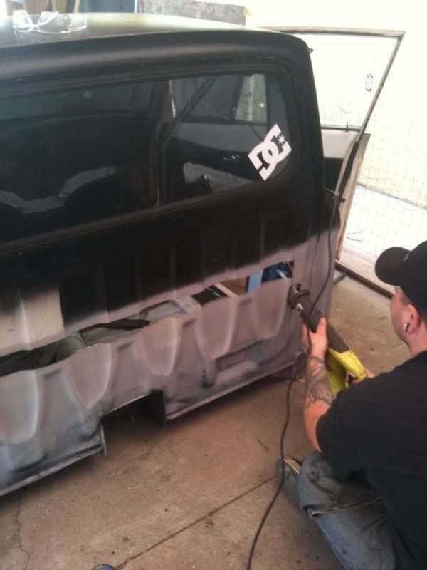

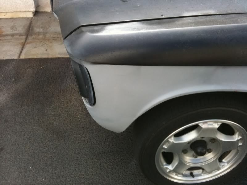

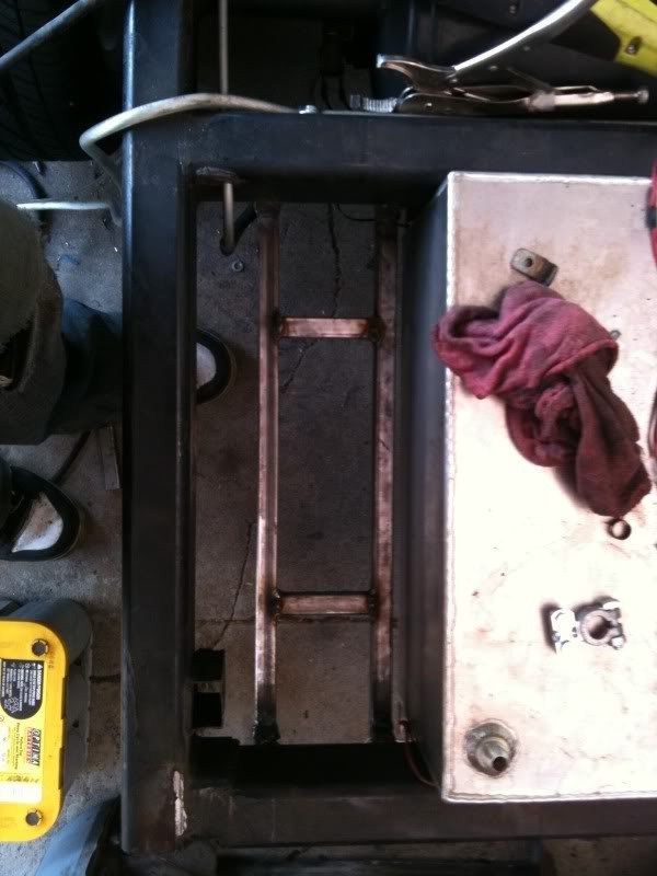

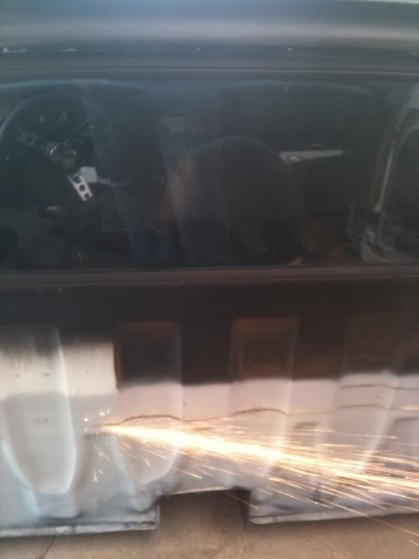

2 1/4 inches to the rocker. Folded pinch
Lays hard
Tight fit?

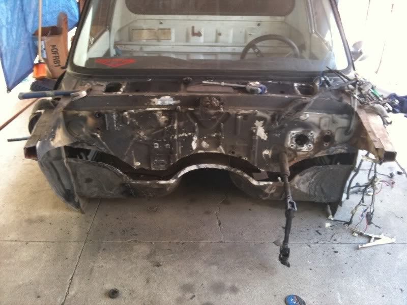

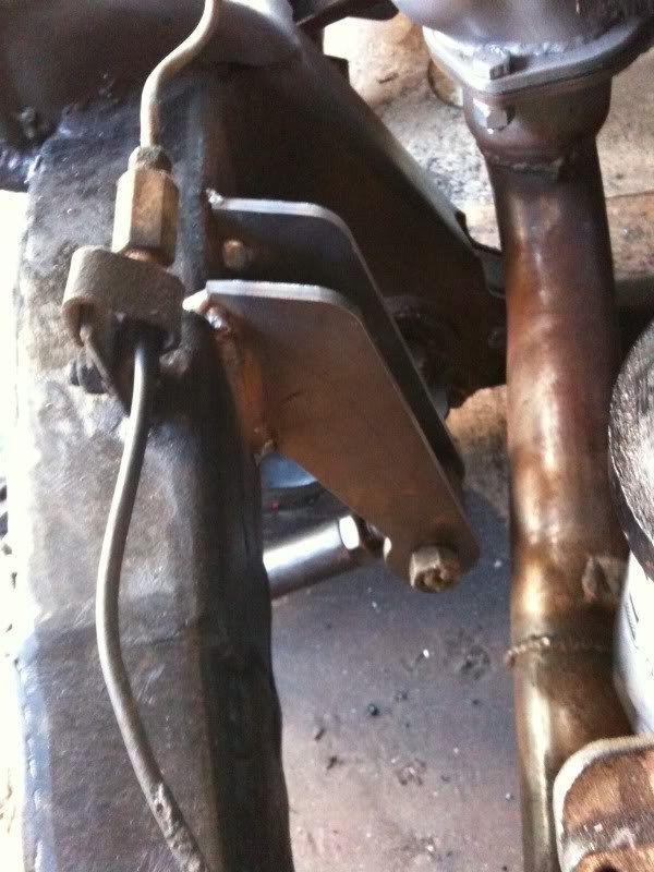

Well I needed new tie rods for my truck and called moog and they no longer manufacture or carry tie rods for the luv. So I started checking out some tie rods from different vehicles for same length and taper. I found out that 68 through 74 chevy nova tie rods work perfect.
Inner is a moog#es681n
Adjusting sleeve #es350s
Outer#es381r

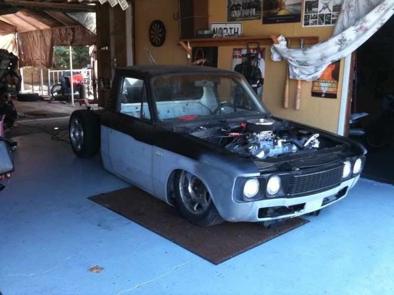

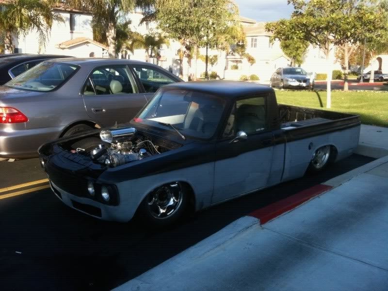

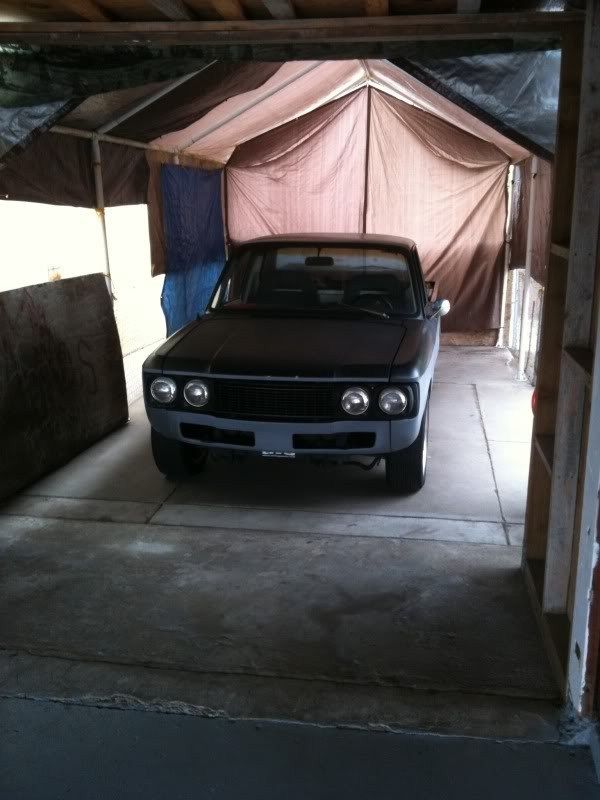

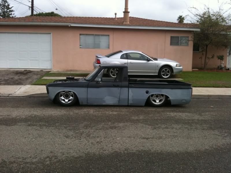

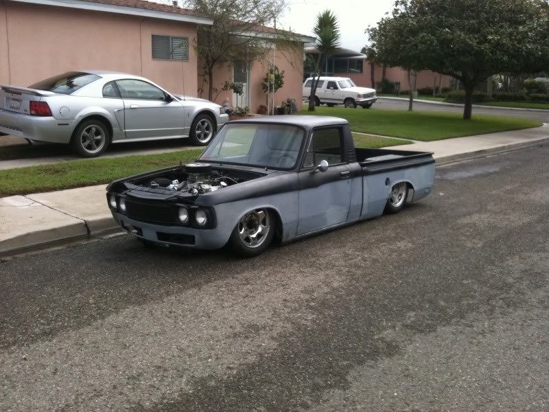

Almost done
Picked up some pathfinders
1low225
is it done yet?
