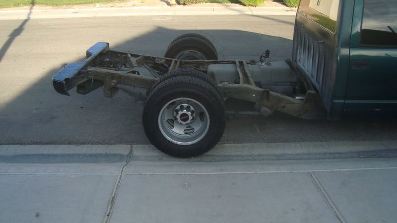

I'd like to hear more about that, because I've seen those exact same wheels on an 88-98 dually. A member here was running them.
According to a very quick search on the intarwebs, the pattern didn't change until 2011; and that 2010 and older are still 8x6.5" / 8x165mm.

No need to contact the member, what I'm saying is that they are the same pattern...
Ignore the broken frame:
Those are 2008-2010 17" GMT900 wheels on a GMT400. Not sure what changed in 2011...
Richard
knuckledragger
Great!!!! Thanks for the picture!!
