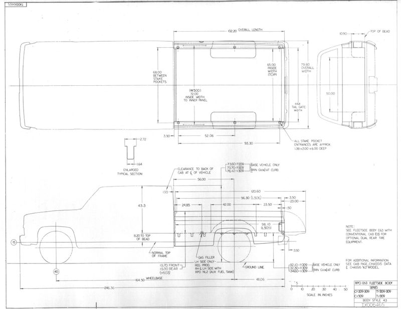

Hello everyone, ive been browsing this forum for a while now an decided to join up. I am currently looking to buy a c30 crewcab dually, i was wandering if anyone has the dimension of one (length, width an height) because im looking at shipping prices as i am from Australia. If any one could help or send mea link it would be greatly appreciated.

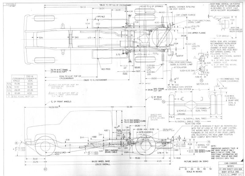

Looks like 142.3" form the front bumper to the back of cab and 102.2" for the box plus 3.5" for the bumper = 288" long. Looks like 73.6"-76.42" high depending on the model. I don't have chassis drawings for the dually fenders but the SRW box is 79.6" wide.
Hope this helps.
