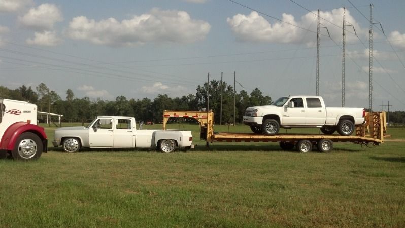

I'm shopping for the parts to bag the rear of my 82 dually c30 and need to know what bags will do best to haul a 3 car gooseneck. I need strongest most reliable as I don't want to loose my cargo or any one else's I may tow for to shows and what not. Thanks for any and all help.

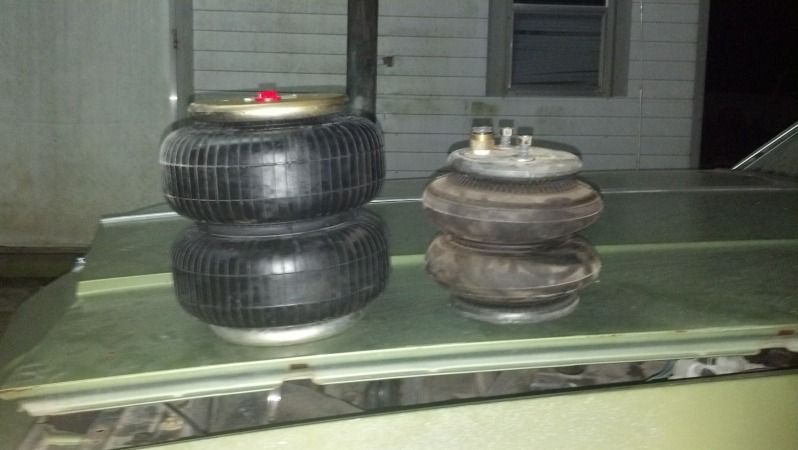

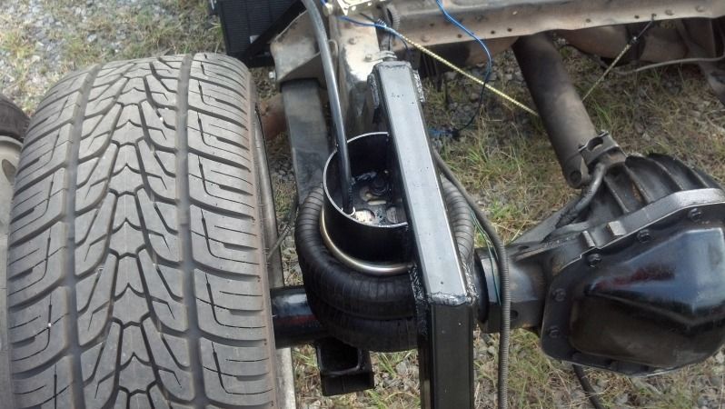

Sounds like you want a big triple stack.....I'm running the #3800lb bags under my notch over the axle.....they are rated at 5k lbs apiece.....I haven't pulled a wedge but they held the weight of my gooseneck with a Duramax on it just fine and with ease

They are from Chassis Tech.....they didn't have the best reputation on products but I decided to give their bags a chance.....ordered them and they were buy two get two free....so I split the cost with a buddy....I'm running two of them and my buddy is running the other two on the rear of his dually....for two years now they have performed flawlessly on both....and shipping was fast...I would recommend them
david&goliath
Cool. Is that full lift in the pic with three trailer?
comegetsome's avatar
comegetsome
Na that's only about 40psi
david&goliath
Ok do you have a full lift picture?
comegetsome
na sorry i dont but its not much higher than the pic above

i have the tripple stacks from air bag it, horrible company but the bags have been great, about 14 inches of lift with bag over axle. havent towed much over 5k yet,
