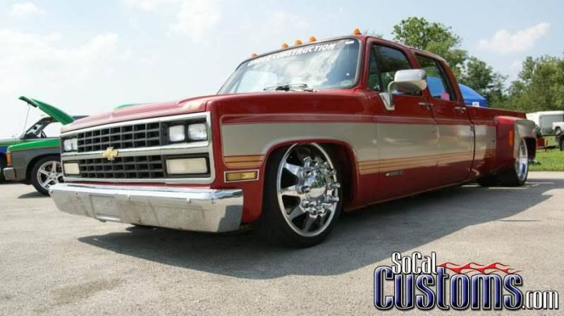

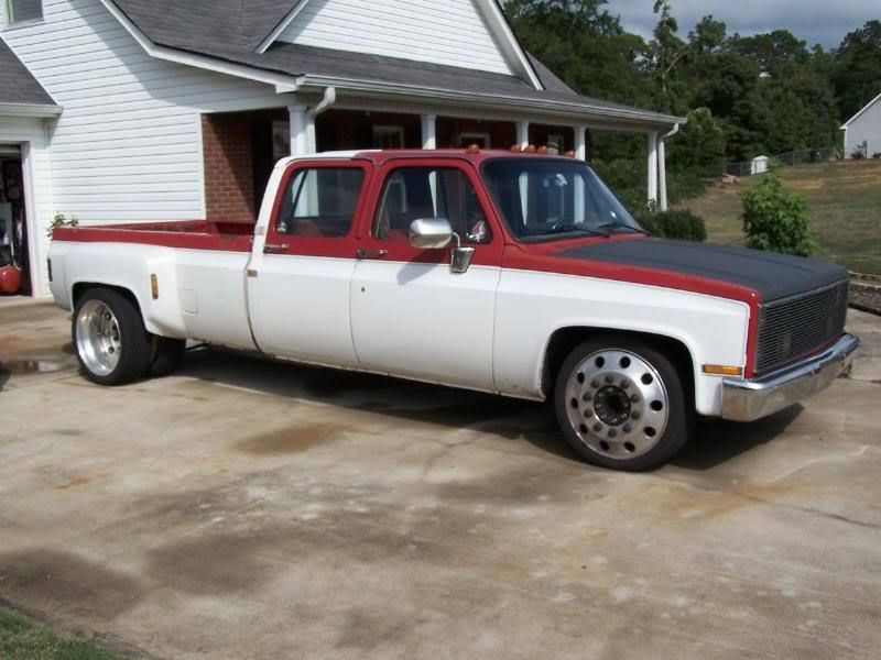

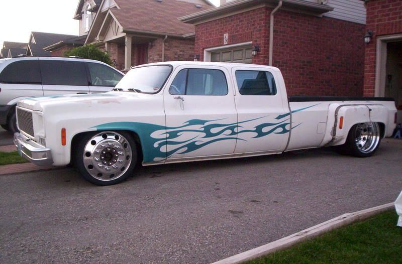

I believe this truck has 4 standard offset semis on the rear axle. You can kinda see the outer is about maybe a couple inches past the fender.
Lock has said that he can mill the wheel faces to pull them in a little, but I'm not sure how much. Maybe 3/4" per side.

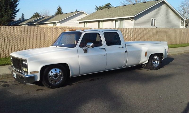

Jitteryguy's truck. You can see what he's talking about here. Thanks for putting this pic up where I could steal it for my album.
This is the one Lophat's been working on for a minute. He's widened the fenders but not nearly as much as some others I've seen. So it's not out of proportion.

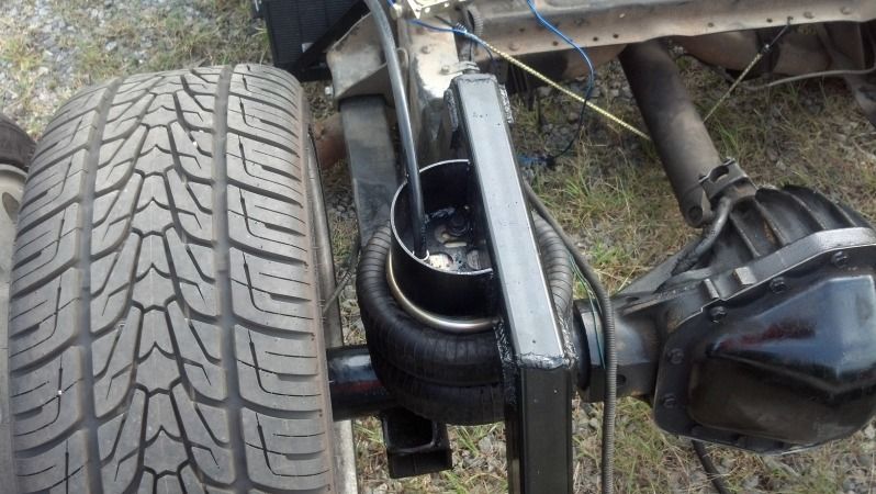

ok here is what you should do......the 22s will stick out a good bit past your fenders......locate a 3/4 ton truck same body style and pull the rear axle....it will bolt under your truck just like stock and is short enough to run 4 standard 22s out back.....also pick up an extra set of inner fenderwells as you will need to widen your inner fenders.....its not a big job do do the fenders and can be done in a days time
this is a 3/4 ton axle here and my 2 link is bolted to stock hangers.....so you wont have any tire/leaf spring clearance issues
and widen fenders
