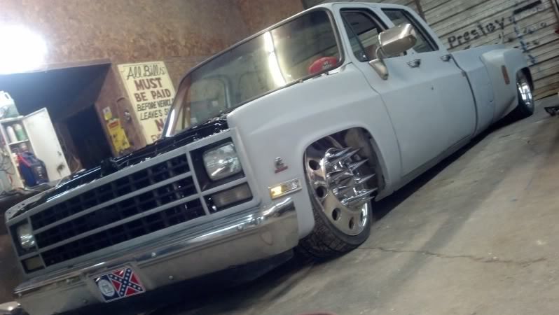

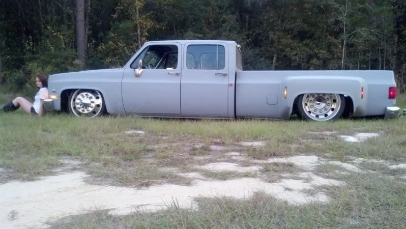

on the frame....no bodydrop
jay
man that's awesome that's a good looking truck. I was hoping they whent that low with out needing to me body dropped. what all is needed to be done to the front to get it to lay like that? I understand the bridge in the rear. thanks again for showing me the pics
comegetsome's avatar
comegetsome
actually mine doesnt lay out all the way in the front.....i still have factory heat and a/c box on the firewall.....its about an inch from laying up front....rear frame lays....mine has 3 inch drop spindles and bag plates....nothing special.....im gonna cup my lower control arms before i body it and get it laying out flat....rear is a standard 2 link with a notch
