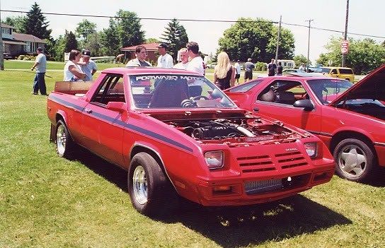

no thats not mine... mines much uglier and i have no card reader for my camera which i cant post pics
its a macpherson strut setup i do believe
