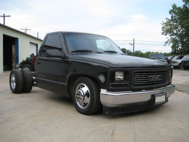

That's my bud's old '88 that started life as a half ton stepside V6 and he built it into a 502 big block with dually running gear including the front end stuff too - upper control arms and spindles, rotors, calipers, and 14 bolt full floater rear. All the dually parts came from my old shop and I helped out a little bit but he did the bulk of the work.
Drop springs with coils cut as well, drop spindles, flip kit, and a bunch of leafs removed (from the 1 ton spring pack, his 1/2 ton leafs were toast) is how it got that low. Shit I even convinced him to grind the bump stop pads off the rear axle because they were hitting the notch.

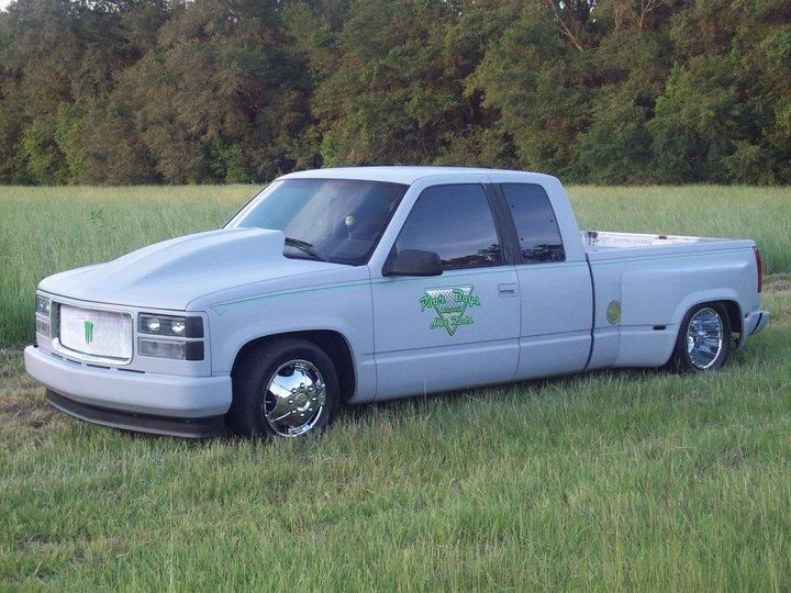

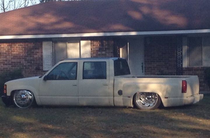

my buddy dillon done that swap several years ago....also an extended cab shortbed.....junkyard 1 ton front suspension bolted right up on his truck.....used 1/2 ton rear leafs and built flip kit.....shortly after he bagged it then shortly after that it became a crew cab short bed lol

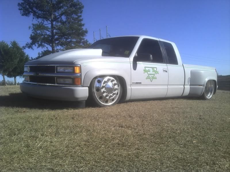

Lol @ Richard. The swb extended cab looks good.

Strangely enough I dig the truck as an extended cab vs. crew cab; you can buy a crew cab shortbed dually in this body style so going to the effort to make one yourself seems less cool (to me.) Also dig the traditional Alcoas vs.the Freightliners... but that's just me. Cool truck anyway and especially with the stock grille. The blackout between the door and ext cab windows is a nice touch too.
