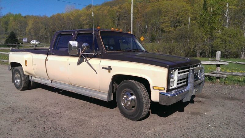

Hello, just wondering if someone can help me out. Im in love with the look of the semis on the crewcabs, and i love the look of the trucks slammed but i cant afford to do both. Whats involved in converting my regular 16's to semis without the air suspension and c notches and z frame and all that.
Is it just a matter of getting hub adapters and having the 22.5 milled down to a 22? or is it much more complex than that?
If its too complex, I may just put a 6/8 drop with the factory 16's. Im up in the air but still want to use truck to pull boats.
thanks for any advice!
krewzlo's avatar
krewzlo
Its real easy. Bolt on 8-10 lug adapters, either buy wheels already milled or get some and have them milled and bolt them on. Regular ones will atick out a bit from the rear fenders or get a set of townasty wheels from tennesse tire and wheel and they will not stick out. You can still tow with them, i will be towing a 10000lb camper with by body dropped dually with 24's on it.depending on your stock tire size the 22's will be close to the same outside diameter.
