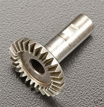

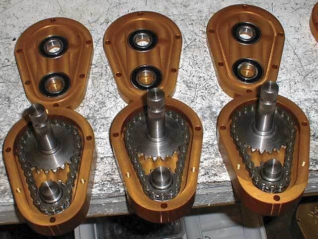

Have you ever heard of this? I am trying to find out if I can use a rack and pinion from a car that is mounted on the firewall on my car that will be mounted on the front of the steer axle. A friend of mine told me there is a gear reverser that you can get to go inline with the steering column that when you turn the wheel left the turns the r&p right which makes your car go left. If this is too confusing or there is no such thing please delete this.
TwistedMinis's avatar
TwistedMinis
You could rig something up yourself with some simple gears from a bearing house.
BankruptRam's avatar
BankruptRam
I've figured out a way to make one.....but something that has been disigned for this would be nice to buy.
BioMax's avatar
BioMax
I haven't ever seen anything like you are talking about, but that doesn't mean anything. Check out Sweet Eng. they have lots of strange steering gadgets.
BankruptRam

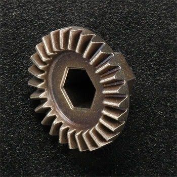

If these two gears were touching face to face one spins left and the other spins right. If this were in a box and could go inline of the steering shaft that would be perfect.
