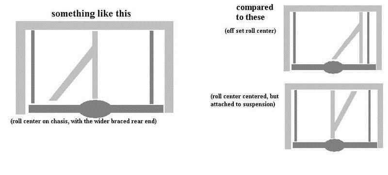

good questions and great answers. sorry if i jacked this thread as well but it seemed like we all had similar questions so i threw mine in as well.
i understand putting the single point off center is a comprimise, but it is going to be a cruiser as it is a 61 fairlane so it wont see any harsh cornering. its also not set in stone yet, its just an option b/c i am not willing to loose my backseat or any space back there. also it is not set in stone either since i hav not torn into it yet, just want good options, 1 NOT being a 2 link!

forgive me for beating the dead horse, but i'm a dee dee dee unless i can see something lol. do i got this right?

That is the basic idea, but again, the single pivot being at the chassis isn't that big of a deal and is not something that should be taken too seriously.
gotcha, but any sort of knowledge i can pick up about this stuff i'm gonna try, alot of it comes from stuff you've wrote
