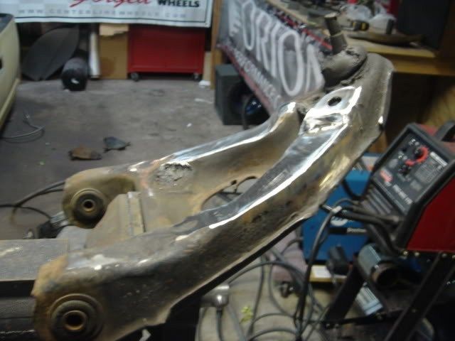

i recently cut the wheelwells of my 99 sonoma (zq8 if it matters) to allow my front end to fully lay out. we noticed that the hump on the lower CA is hitting the frame. ive heard of people dehumping the arms, but im trying to figure out why i should have to in order to lay an 18 with a 40 series tire. i have 2 inch spindles as well.
my roommates 01 dime lays frame fine, no modifications to the arms with my wheels. are the s10 and sonoma arms different?

I just don't like the look of a de-humped lca.

mreed... thats a huge F'n hole. not sure i wanna do that. prolly end up dehumping the arms. but if anyone knows about the part numbers on the lower CA's, ive got a bet going with my roommate that they are different.

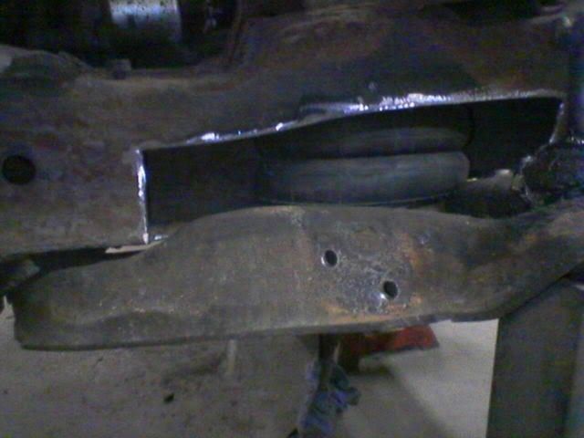

jdozier1279
no u dont have to de hump the arms, notch the fram like the pic above, most people who bag the s10-sonoma will notch the frame and with bigger wheels pie cut the arms. ive done two. u if it is king cab you will have to do something with the cross member as well.
