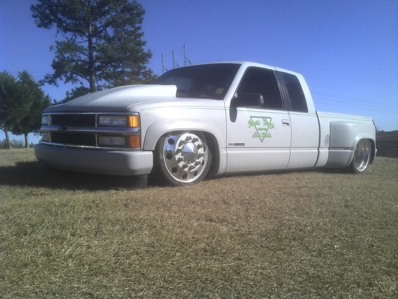

1 ton stuff will swap right over as Richard said....this truck was a 1/2 ton...he went to the pull-it yard and unbolted the control arms from frame of 1 ton and bolted it straight to his truck....never even broke the ball joints loose

are those 22's?
comegetsome's avatar
comegetsome
Yea they are the 22s off my dually....we bolted them on there so he could have motivation to save money for some of his own lol

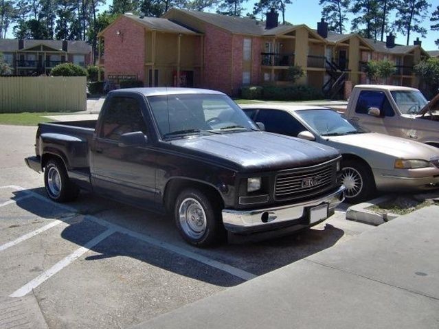

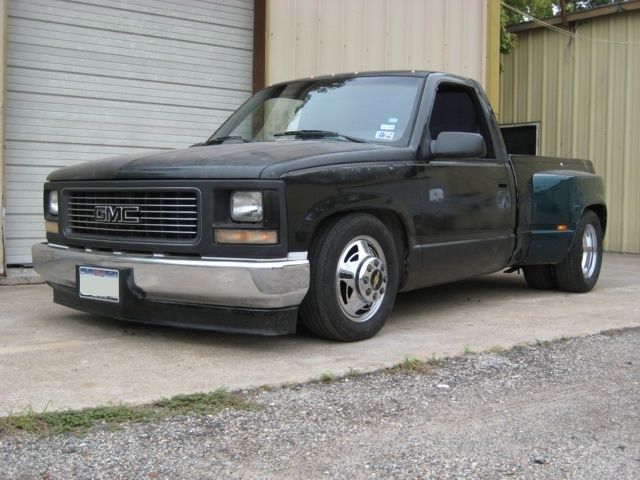

This was a half ton, too...my buddy's old truck:
Before
After
Stock 1 ton uppers, as I said before lowers are same 1500-2500-3500, 1 ton drop spindles, 1 ton calipers & rotors, and 1 ton rear end including 1 ton leaf pack with several leafs removed, and flipped.
